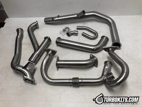

    I believe it could be done. But if you're serious about something like that, I hope you're planning a forged rotating assembly! :) At the power levels something like that would be capable of, I'd also really recommend running a standalone (MoTeC being my preference) in parallel w/ the OE ECU. This would leave the throttle body and trans control functions to the OE ECU, and give Fueling, Ignition, and VVT (and others) to the aftermarket EFI system that will not have the limitations of the OE ECU. If your serious, we're versed in Haltech and MoTeC systems.
