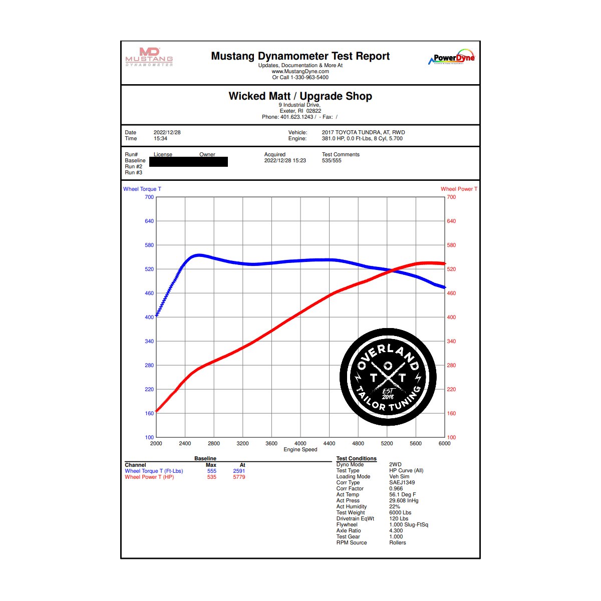

    Wicked Mat Tuning put in some quality work troubleshooting some issues with improper installations of a previous shops work. Correcting the install issues that were present in some of the fuel system components made it possible for us to properly dial in the setup. OTT was able to wrap up the calibration for this 2017 Tundra today during a remote tuning session. Pretty sweet combo that's a blast to drive! The Tundra was fitted with the TVS1900 Magnuson SC with Pulley Upgrade (12-13psi peak) Longtube Headers / Full Exhaust Prospeed 4.5" CAI Prospeed Fuel Rails / Chassis Lines Aeromotive FPR 750cc Injectors Walbro 450lph Pump Radium Fuel Pump Relay Kit / 10ga Wiring / Fuel Hanger Stud Kit.
    Baseline run on this truck (bone stock) was 289hp/307tq on premium pump fuel. We landed at 535hp/555tq all said and done.
    “From slow to woah!”

    Cross-posted to Tundras.com; guys are impressed! Do you know what altitude they dyno'd at?
    That's a pretty similar setup to what I'll have. Except ProSpeed's airbox leaves a lot to be desired in the way of quality and engineering. It pulls in a ton of engine heat since the box isn't sealed. And tbh, their stuff is overpriced.
    https://www.tundras.com/threads/general-supercharger-thread.85513/page-162#post-3031974

    It was functionally sea level being in RI.
    We weren’t consulted with the parts selection, but rather just asked to tune it.
    The AFR was ~11.0-10.8 at the top end.

    Amazing that the MAX torque is waaaaay down in the RPM band, sort of looks like a diesel in that respect.
