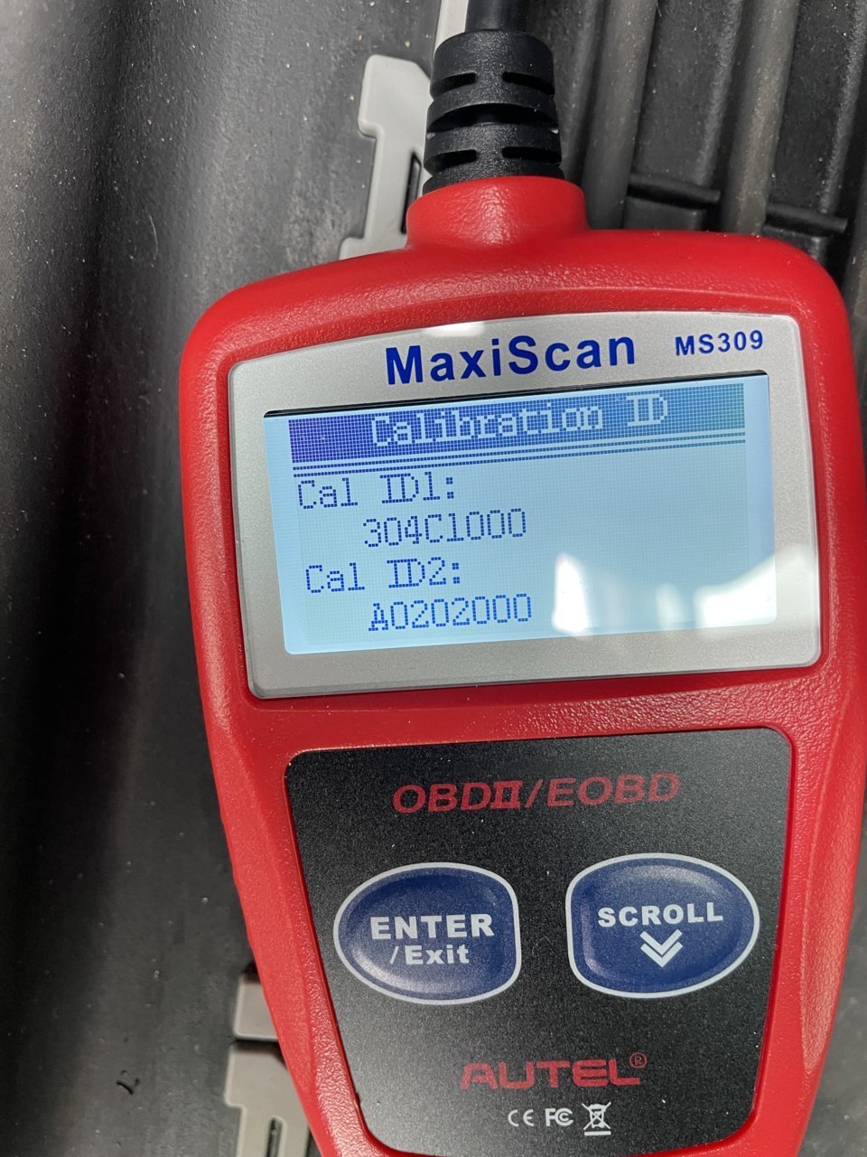

    It can be done, however drawback to using a GL tune on the 2nd Gen is there isn't a second set of maps like there is for the 3rd Gen. You'd be stuck using GL 100% of the time. The 3rd Gens typically ask for a GL tune to be configured when the ECT button is depressed which switches to an entirely different set of throttle maps and transmission maps. The 2nd Gen only has the primary maps. We can make a GL specific tune for you so when you need it, you can flash it and then later revert back to your primary tune. If that's something you need be sure to let your tuner know or reach out to us at info@overlandtailor.com and we'll get you taken care of.
    We look forward to having you! Be sure to remind us when getting your tune how you'd like it configured. Our GL offerings are done on request.
    Can you remind me again, what is your Calibration ID? If you're aware of it.

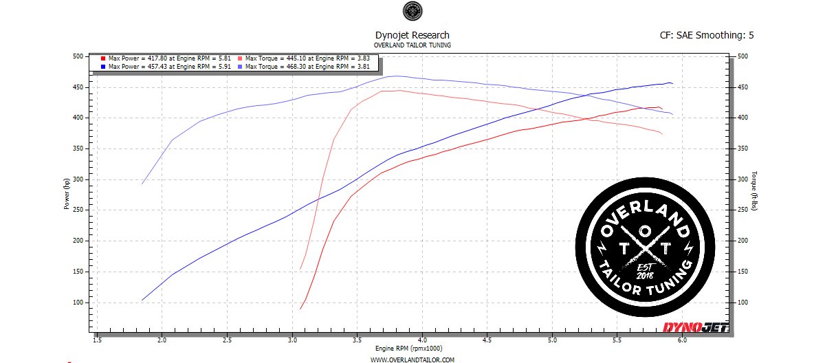

    2014 Tundra FFV on 91 octane came for a visit today. Truck was on 91 octane. Stock other than a lift and 35” MT’s and Maggy S/C of course!
    Magnuson Tune vs OTT

    that's all in the cams, and the roots style blower.
