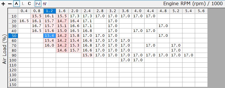

    Lots to digest here.. Let me see if I can break this down and help put things in to perspective.
    From the notes I have in your folder, you received the base calibration and sent 1 datalog (to confirm your settings were safe). You did not receive a custom tune. I do not however have notes on the octane fuel you requested the tune for. While all of our tunes are what this community affectionately calls "Octane Learning", we have ways to have tunes default the tune to a particular setting that is within the normal range of a given fuel grade/quality. Your tune was setup to default to regular (87 RON). Reviewing the datalog you sent back showed the engine was not comfortable with any additional advance over our base target values. See below:
    In the chart above, you're looking at the average Knock Correct Learn Value for a given RPM/Load. Without getting too far in the weeds, this parameter is essentially a long term knock trim similar to a long term fuel trim. This parameter (in this platform) has a range from 0-29 with certain vehicles defaulting to 21, and others to 14 depending on the Calibration ID. However, relevant to this discussion.. Your Default KCLV is set to 17 given your tune was setup to default to 87 octane after a battery reset. As seen in this log, the fuel you ran at that time did not have the ability to support more ignition advance beyond our baseline settings. This is seen with the KCLV values dropping down to ~15. This is a value typically observed when 85 octane fuel is used or when fuel's have sat for a while and have higher H20 concentrations.
    In short the fuel quality/octane level of the fuel utilized will not support additional output. You're functionally knock limited.
    We also confirmed fueling was properly dialed in by ensuring there was no more than 5% error from what is commanded to observed.

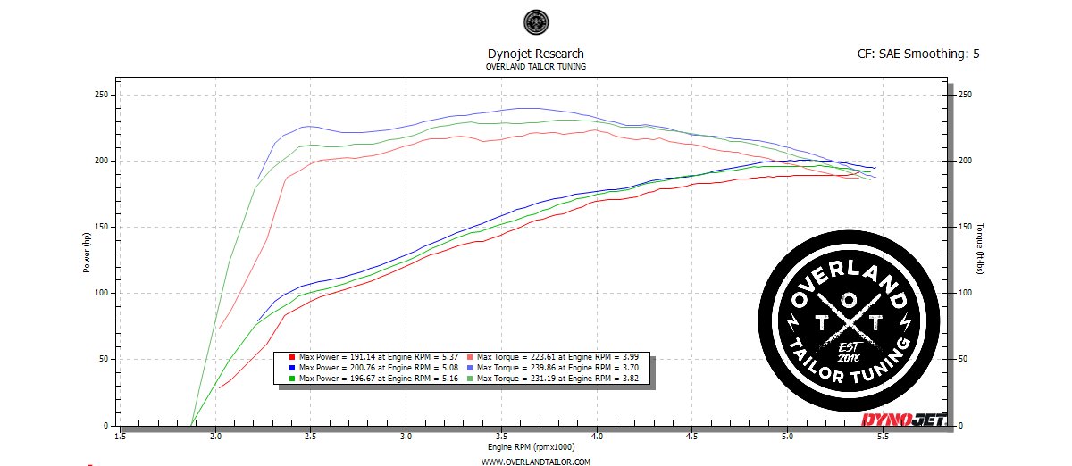

    I'm not sure if you've seen our published 2G Tacoma dyno testing, but I took a bone stock 2014 Tacoma Automatic to the dyno to highlight exactly what can be expected from a tune on this platform. That can be seen "here". I'd like to point out a specific set of data from that post.
    The green line represents what can be expected on 86/87 octane fuel. We're able to improve the powerband at every single RPM point across the entire rev range over Toyota, on regular fuel. But Toyota invested a great deal of time and money here, as they do on all their platforms. It's not possible to make 20HP over stock on modern Toyota without significant upgrades, higher octane fuel (91+) and calibration work. Gains on 87 octane are admittedly minimal. If you were expecting significant gains in output from a simple calibration I think your expectations are misaligned with what's possible. There is no "magic sauce" that will turn a stock-ish 1GR-FE into a ripper, not matter what VVTi angles, how much ignition advance, or how lean/rich you run it. It's not a performance motor.
    Our approach (regarding output) is specifically tailored to maximize the low end output (primarily at part throttle) while giving everything the platform is capable of across the entire rev range. We spend a great deal of time and money on development of each platform we support. Each dyno sheet you see here often is accompanied by many other non-documented hours on the dyno testing every possible combination of settings to ensure what we offer is truly optimized for a given setup. In your case, the 2nd Gen in particular isn't riddled with calibration oddities that make the profound difference our 3G clients note.
    Now with all of that said, some trucks run a little better than others. Some are blessed with good fuel that is quite tolerant of us leaning on it harder to make better numbers. Looking at your log, your truck certainly COULD make more power in it's current configuration, however the fuel quality ran at the time of your tune was not supportive of that idea.
    I'd almost ask that you hold off on throwing a bunch of bolt-on parts at the truck. We've tested a good bit of that stuff too (unpublished) and can guide you on some parts advice so you're not blowing money on parts that don't do anything only to be further disappointed when you're still not making any more power than you were previously. There's a lot of misinformation and hype on these forums over parts and people are infected with the FOMO virus..
    Don't get wrapped up in the versions mentioned here. The whole "tune name" thing sickens us. Such a marketing gimmick. While we do INTERNALLY reference some of our tunes by version number so we can INTERNALLY track things, the public really needs to know they are on "OTT". Just because we update the tune file for a particular platform does not mean there's an instant update for all of the other supported platforms we cover. Each platform we offer support for is independently tested and evaluated. We don't blanket approach the changes as many of the changes for one platform are not appropriate for another. If you or anyone wants to check in to see if you're on the most up-to-date version of your tune, reach out to the person who provided your calibration - be that OTT directly at info@overlandtailor.com or through your 3rd Party retailer. We'll get you taken care of at no charge. Often the changes are very mild in nature and are not necessarily required. If you're having a issue or concern about something please let us know, but if at any time we discover something that is necessary to update, we'll take the initiative to contact you directly.
    Hope that helps some and clears up some of the confusion you may have had.
