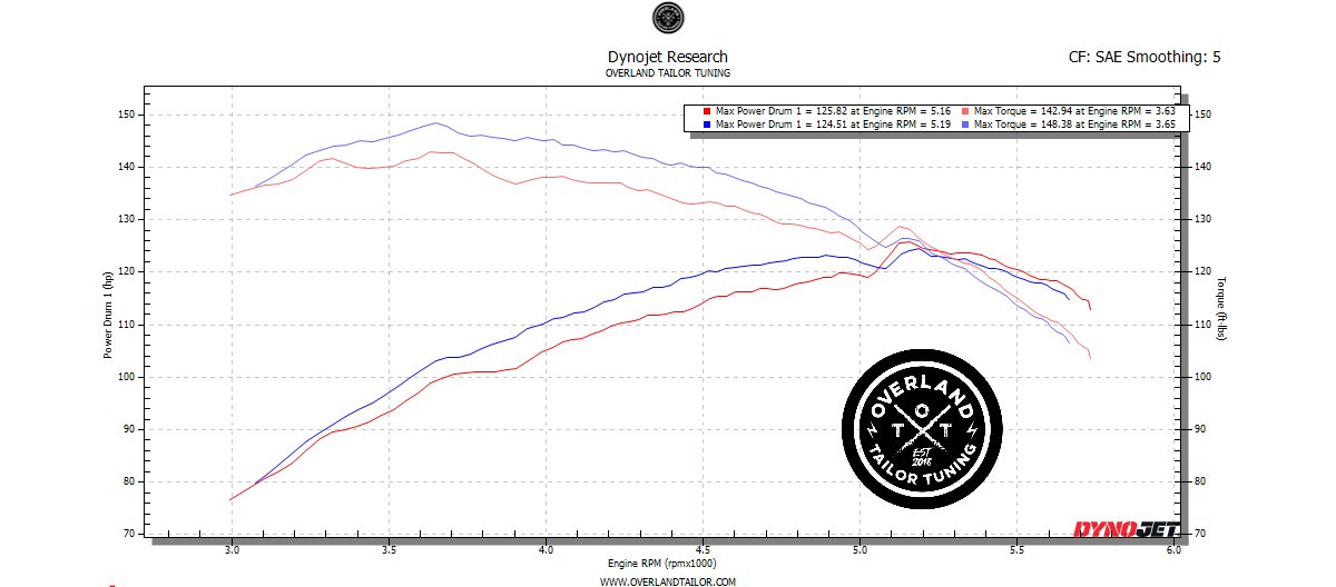

    Ok guys. We promised you guys some 2.7L Dyno Results. We're happy to be able to provide you this data and we're excited to have even more in the works for this platform which will significantly boost these numbers even on 87 Octane. We've got to revisit this at another time when we have some additional tools at our disposal to make it possible. But we were able able to explore within the calibration of the 2TR to see what the engine likes and responds too. Like many other modern Toyota platforms many areas of the calibration are rather well sorted for a stock-ish truck.
    We were able to extract the following out of a 04C10 calibration in a low mileage truck using 87 Octane from a quality station.
    The output above 5K RPM is run-run variance. We extensively tested VVTi, Ignition, etc. changes and were not able to extract additional output over the factory calibration, so any variance you see here is simple run-run variance and not related to the calibration.
    For any of our current 3G 2.7L customers: please reach out to us or your local tuner to receive your updated tune. Update will be free of charge. We do anticipate another potential update to be released but more to come on that as we coordinate with VFTuner on our needs.

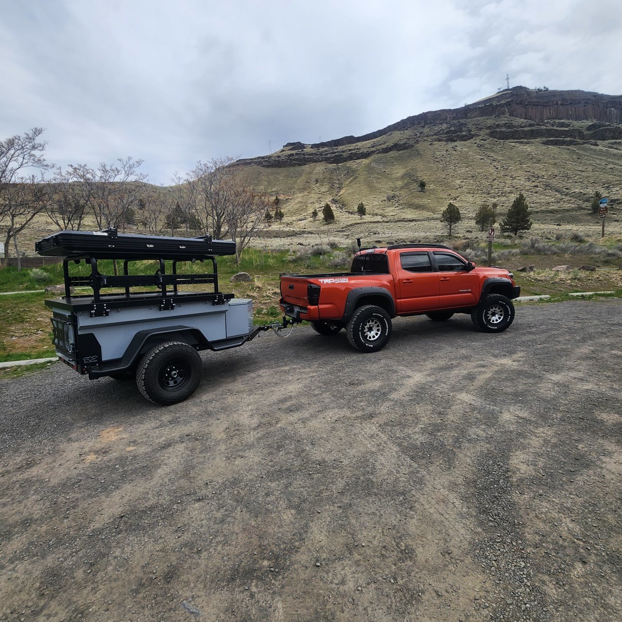

    Hay guys I'm jumping back into Ott side of the tuning community and I've done a few different updates in mods to my engine performance. I'm gonna be reviewing how the tune reacts to these mods. Some of you know or if you have been following me I've been updating elsewhere. It's that time of year where I'll be loading down my Tacoma with camping gear, hunting gear, and long road trips being loaded down. I recently bought a CVT trailer.
    This tune I know gives you that power that is needed for heavy hauling or towing . Bare with me as I like to give time for the tune to log miles.
    I'm here to give my best real world experience and the best opinions I can give . I'm very avid on Tacoma world and giving the best experience I can share . Look very forward to giving back to the community and any advice. Talk to you all soon .
