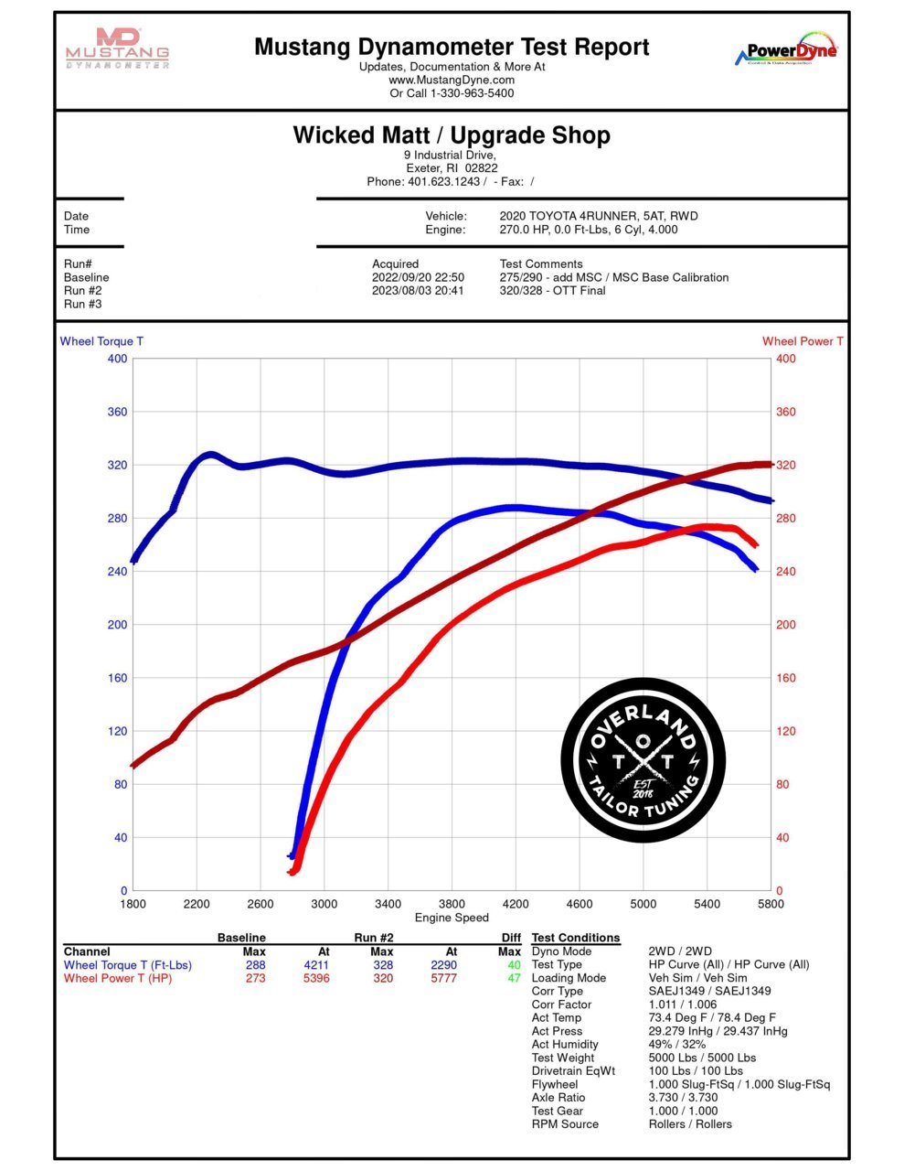

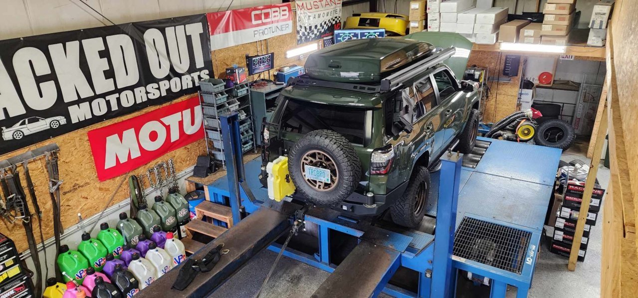

    Another big thanks to Wicked Matt for putting his personal 2020 4Runner on the dyno to help us in finalizing the OTT 5th Gen 4Runner Magnuson Calibration. We've had it in final Beta phase for some time now with many happy customers. However, today we were able to fully vet it, put the final polish on it and have it be a full production release. For those that may not know, Matt Miner (Owner of Wicked Matt Tuning) is a full service facility with an in house Mustang Dyno. He's our go to for those of you in the RI area.

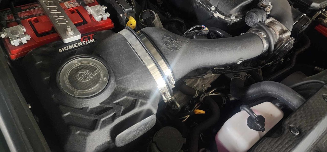

    This particular vehicle has an aFe intake and the Magnuson S/C kit (TVS1320) installed and was baselined 8/3/2023 with the supplied tune from Magnuson. Today, we loaded up the OTT T4R Maggy Calibration and here is what we were able to achieve with the OTT calibration on Premium unleaded fuel.
    Notes for this particular platform:
    • Upgraded fuel pump strongly recommended even for stock vehicle fitted with supercharger. ANY pulley upgrade MUST have fuel pump upgrade.
    • Fuel pump upgrade available from URD.
    • Aftermarket intake not required on this platform, very little improvement in output even in S/C applications.

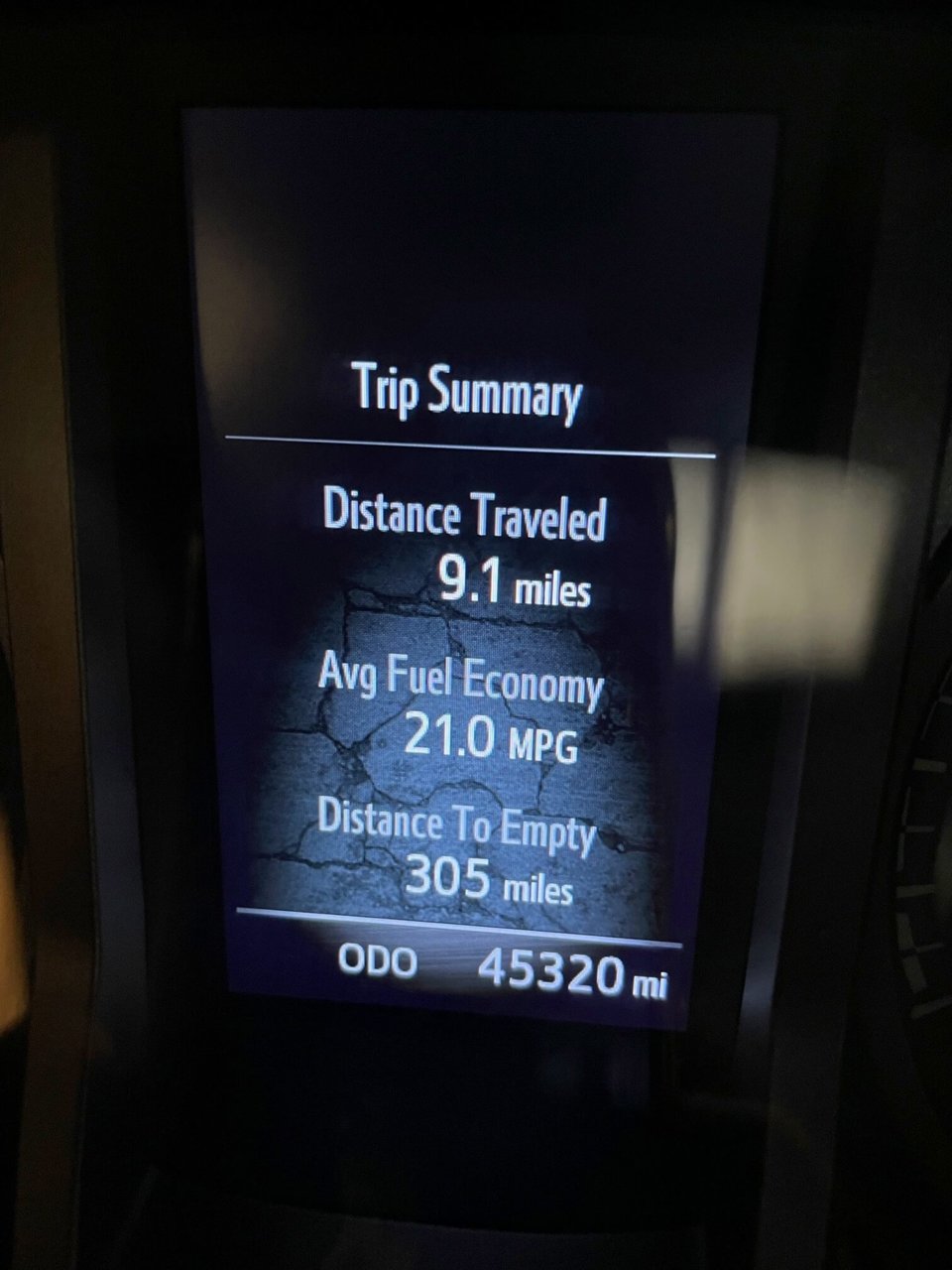

    FWIW I've had the light/mild OTT tune for about 5 months now and the mileage has actually improved over time. Here's a recent screenshot. Short trip, but it was almost exactly 50% freeway and 50% city street driving. At first mileage was not great, but a lot of it was my fault since I was "testing" the tune in every which way I could. Since then I've settled into just enjoying how it drives, powering up an onramp or tooling around town. Still the best money I've spent on our Taco to date. :thumbsup:
