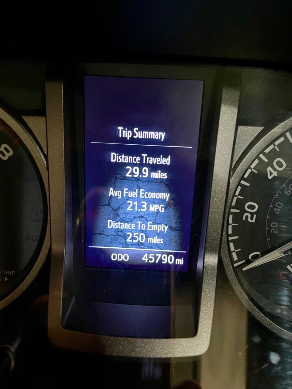

    Posted this in another thread where someone was concerned about negative mileage impact with an OTT tune. Thought I'd add it here as well. Today's freeway results (avg 70 MPH or so). Had the tune done last February - OE wheels with Toyo A/T III tires. Best mileage it's had since we bought it and best money I've spent to date! (OTT... tires are great too ;)). Thanks OTT! :thumbsup:

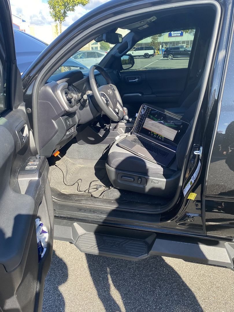

    Got OTT Tune update, V9, Mild/Spicy! (Mild drive, Spicy ECT) Thanks Allan!!!
    Love it...the response with ECT was astoundingly noticeable.
