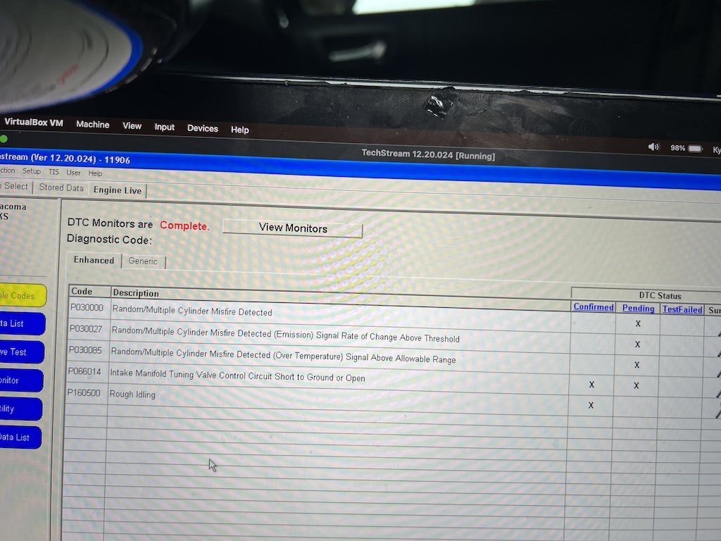

    Bold move to put a SC on so early. The fact that you are now getting misfires and other codes does not lead me to believe it is tune related. Though the OTT tune would probably be better. If tune related, it would rear its head immediately in my opinion. I would have it professionally diagnosed, hopefully not a head gasket. What plugs are you running and are they gapped correctly? High octane fuel?

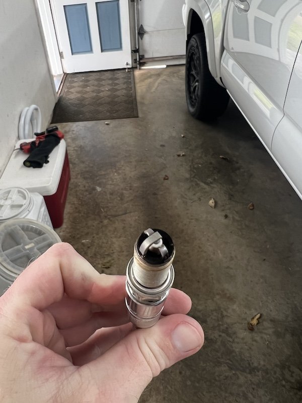

    There are a few things I'd be interested in seeing in your situation. Hopefully, you've not cleared the codes, as some telling information can be gleaned from the freeze frame data the ECU will store when those codes are triggered. I'd be very interested to see some of those details.
    I'd also confirm your spark plugs are appropriately torqued. A few of our members have suffered from improperly torqued spark plugs (finger tight from the factory), which could potentially cause some of your issues.

    I pulled and moved 4 of the 6 plugs around and they weren't very tight when I removed them. It took no effort to loosen them. I unfortunately did clear the codes. Pic of them. Have you seen anything like this before on a mag tune? After it happened I restarted the truck and continued on my way home and it drove completely fine. When I had the scan tool hooked up after and can see the live data it will show misfire for 5,6,3,1 all at different times, but if it wasn't for seeing it visually in the live data I wouldn't be able to tell otherwise it was happening.

    Since you tightened the plugs and cleared the codes and it hasn't returned. Maybe its ok. I've read on here somewhere where a misfire with no code is normal . I maybe wrong though
