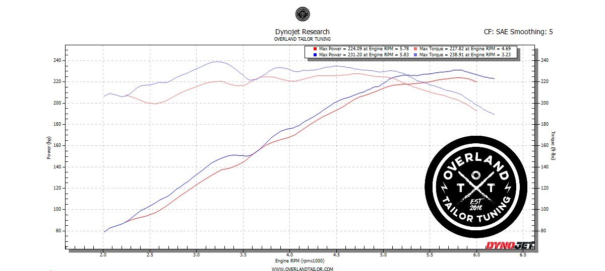

    Q: is the new CARB legal tune the same as the dyno chart for stock vs torque tune?
    If not, do you have a dyno chart for the CARB legal tune?
    The chart shown here is what I'm wanting for my entirely stock 2023
    Also, the DIY kit is far more appealing to me, than driving 320 miles and paying $500 to a tuner.

    The dyno chart previously posted is accurate and applicable for OTT-CE (tune w/ CARB EO).
