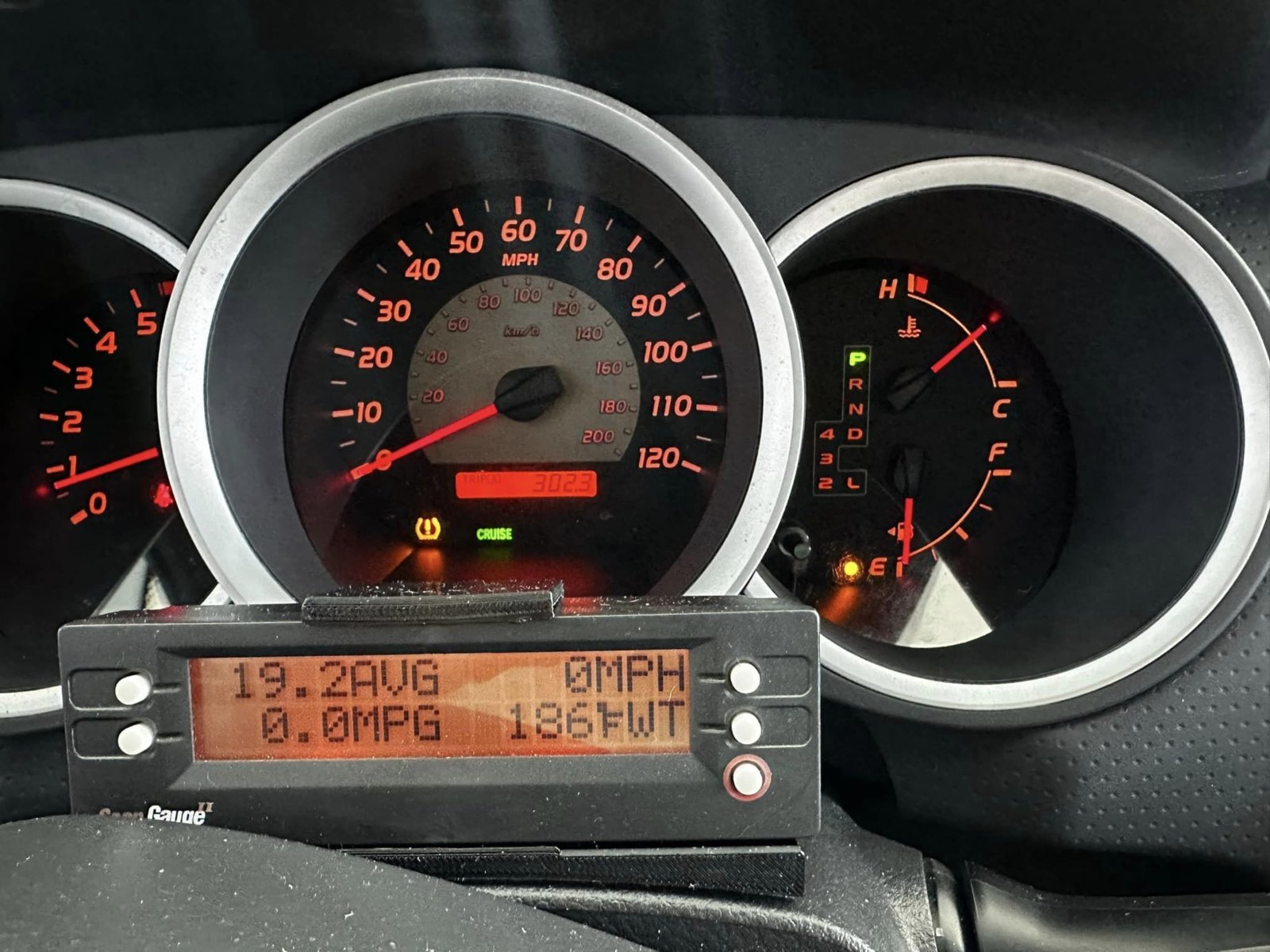

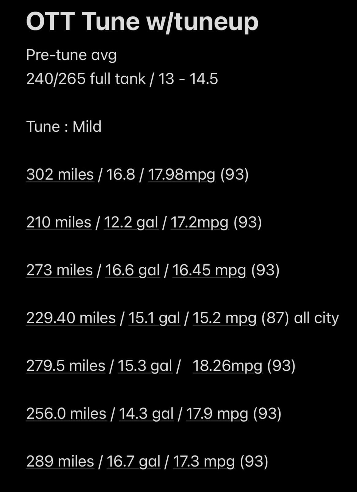

    Here is some factual feedback from a customer who recently got OTT.
    "I’m very happy with the tune I got right before my 2,000 mile 8 day round trip up to Virginia, then to blue ridge Moantain and then back home to Florida.
    I put new spark plugs, cleaned throttle body, cleaned k&n filter and got the mild tune. Was consistently getting 300+ miles to the full tank. before I was seeing 240 to 260ish in premium gas. Even less on 87. New average MPG 17-18.
    I logged every fill up for the whole trip. The average speed on the highway was 72 on cruise control. I’m very happy to be at this mileage again after all the weight added to the truck. It was myself with two passengers. Luggage in the back and a fridge as well.
    The shift points were great in the highway never had a hunting issue. I had told Rafi I wanted to improve my range in the trips. And here are the results. Got an extra hour of drive time per tank before having to stop.
    2011 V6/ tire size 265/70r17 Falken wildpeaks
    Tire PSI set to 36"
