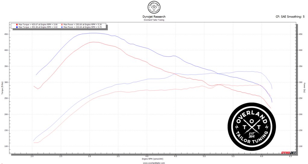

    I wholeheartedly disagree with your assessment, but never the less..
    Bring us a truck running the fuel you want tested and we’ll provide the testing free of charge.
    This was a vehicle supplied to us. We can’t (always) control what fuel is used.
    It should also be noted that this isn’t a “special” tune for 91 octane or premium fuel in general. Our Stage 1 calibration is designed to run regular to premium. What’s presented here is simply a data point.
