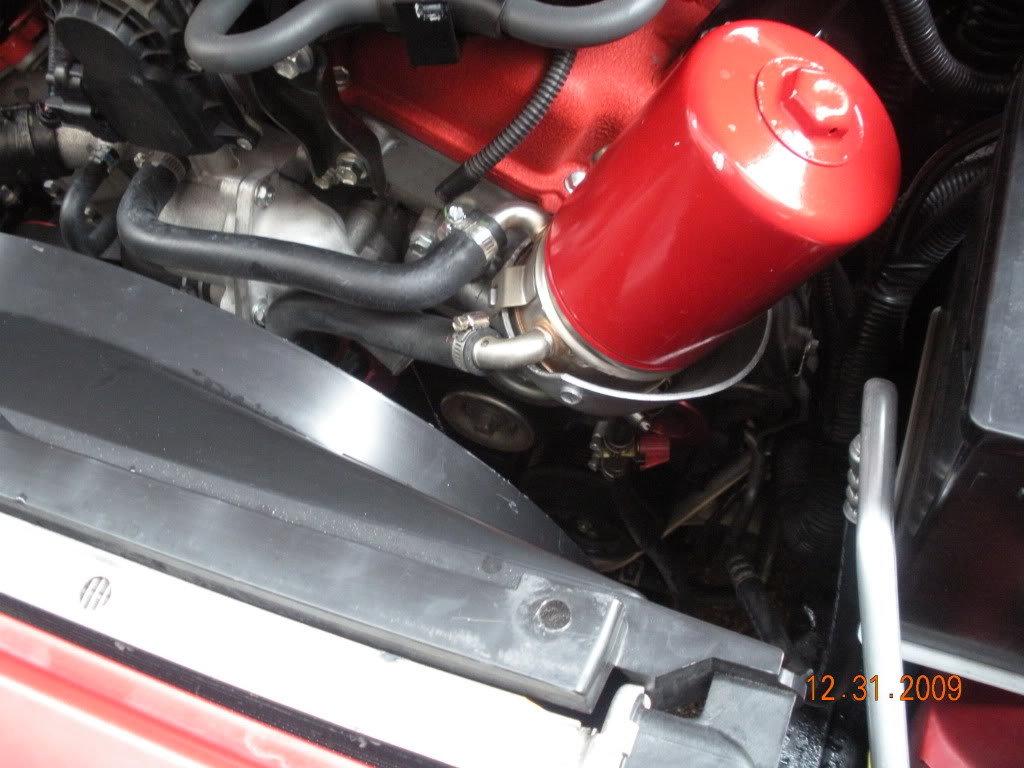

    I use a K&N 3001. This one has been painted RR.
    Shown with factory oil cooler.
