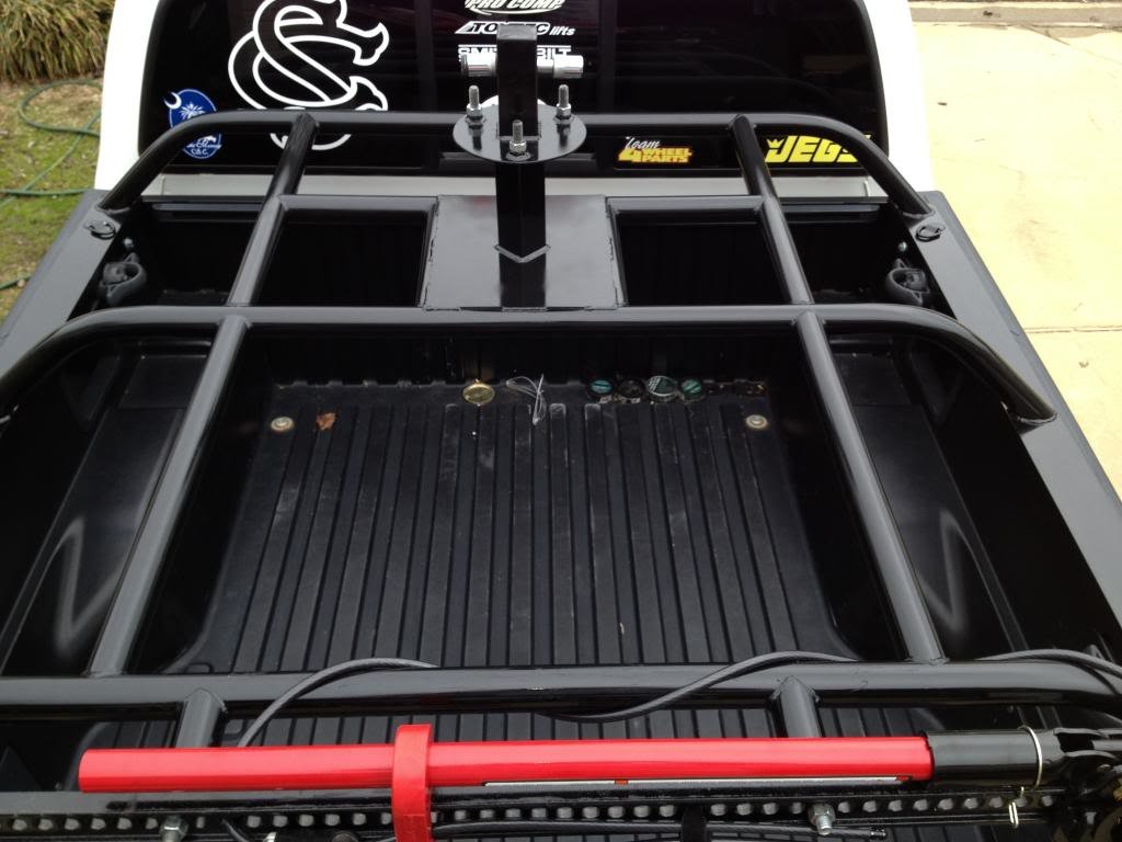

    If you ever go bigger than a 285 look into a bed rack to mount the spare & a Hi-lift jack.....
