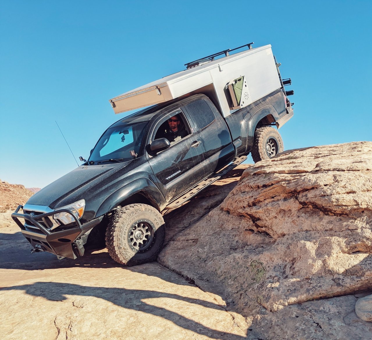

    Dreaming of days like this.

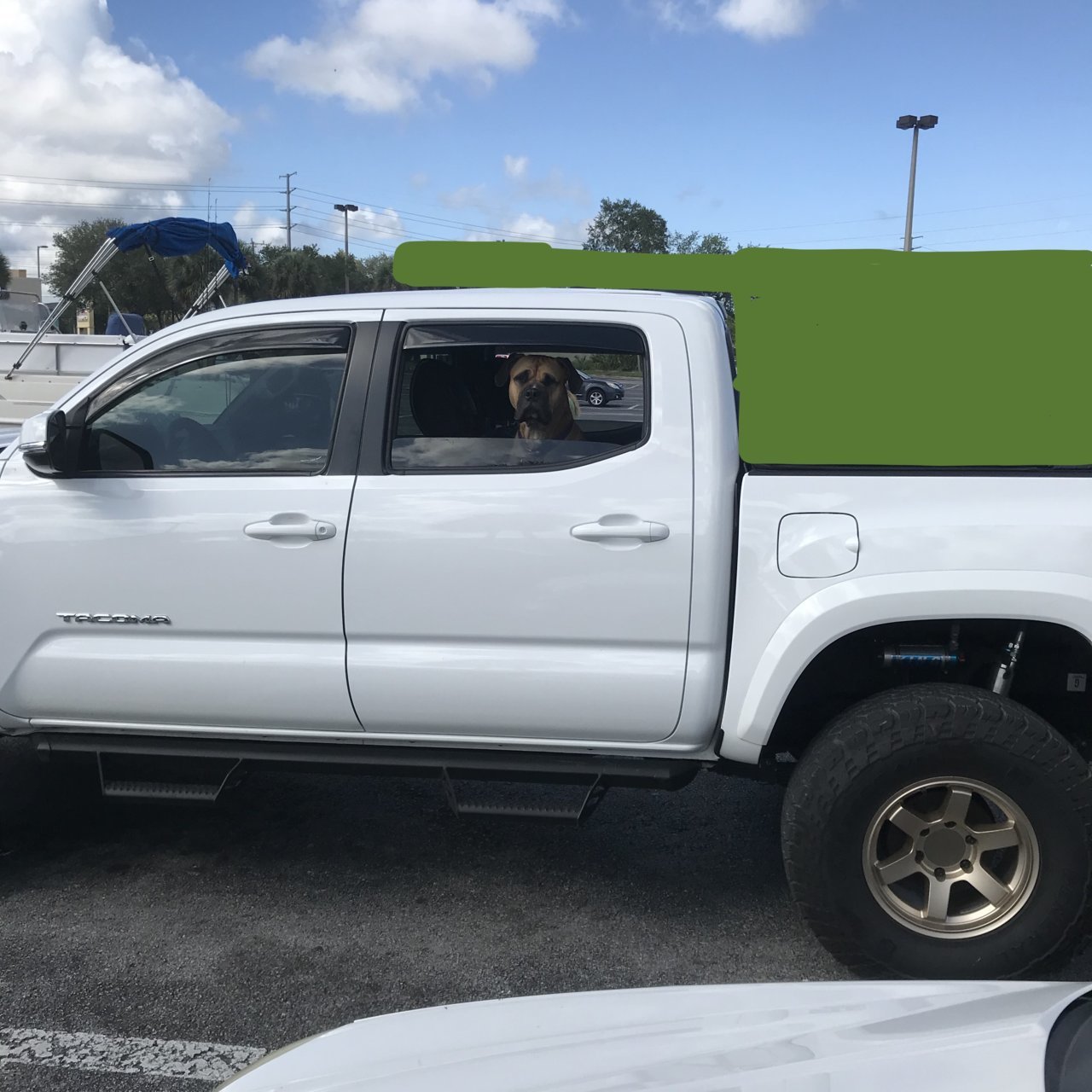

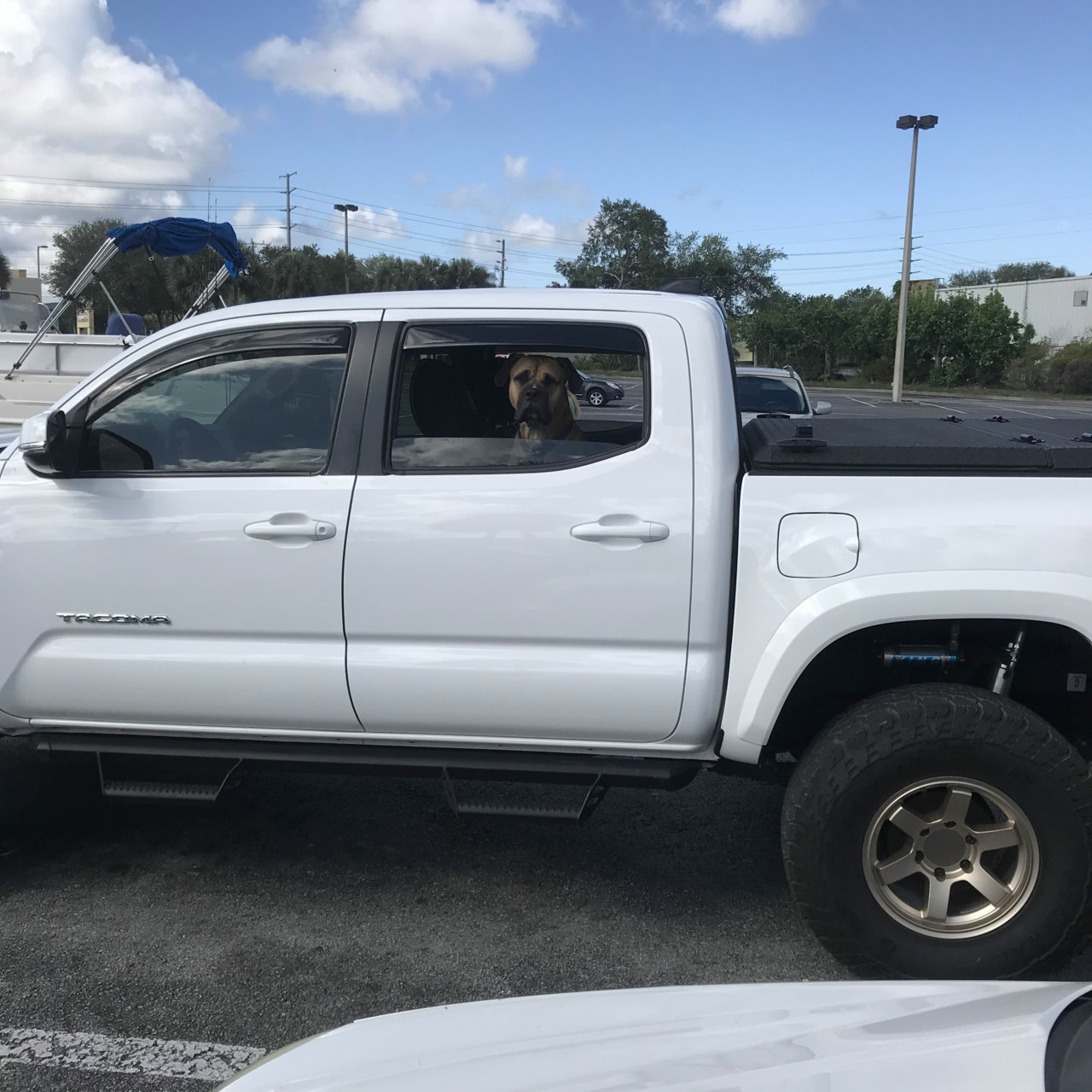

    D0BDDAC2-B087-4E2F-BDFD-79A498664EB7.jpg Here's my Baby inside my other Baby.

    There. I forgot this was an OVRLND thread.

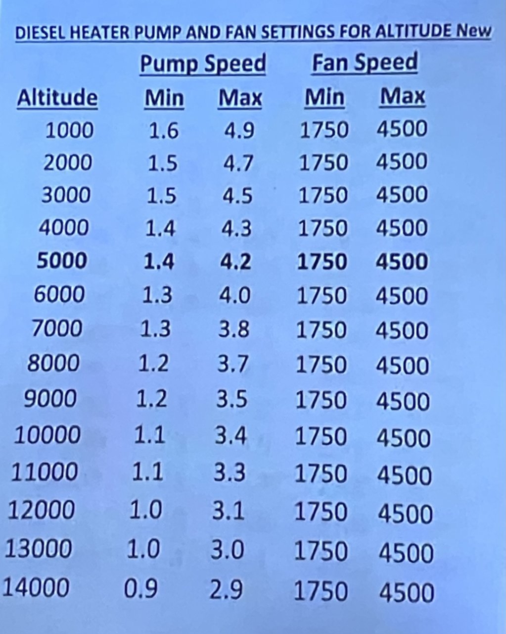

    I looked into these bc they are so much cheaper, however, I live at a higher altitude and would like to use it to go to different ski areas all of which are at high altitude. From what I have read the diesel heaters from Amazon don't have altitude adjustments?

    Working on the post now. Be done in a few. Also these manual settings have been passed around from someone that apparently did extensive testing with it. A friend is current using his in Breck at 9,600 feet with out any adjustments. But totally understand the better safe than sorry route. Let you know when finished with the post.

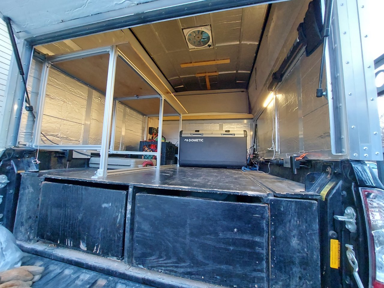

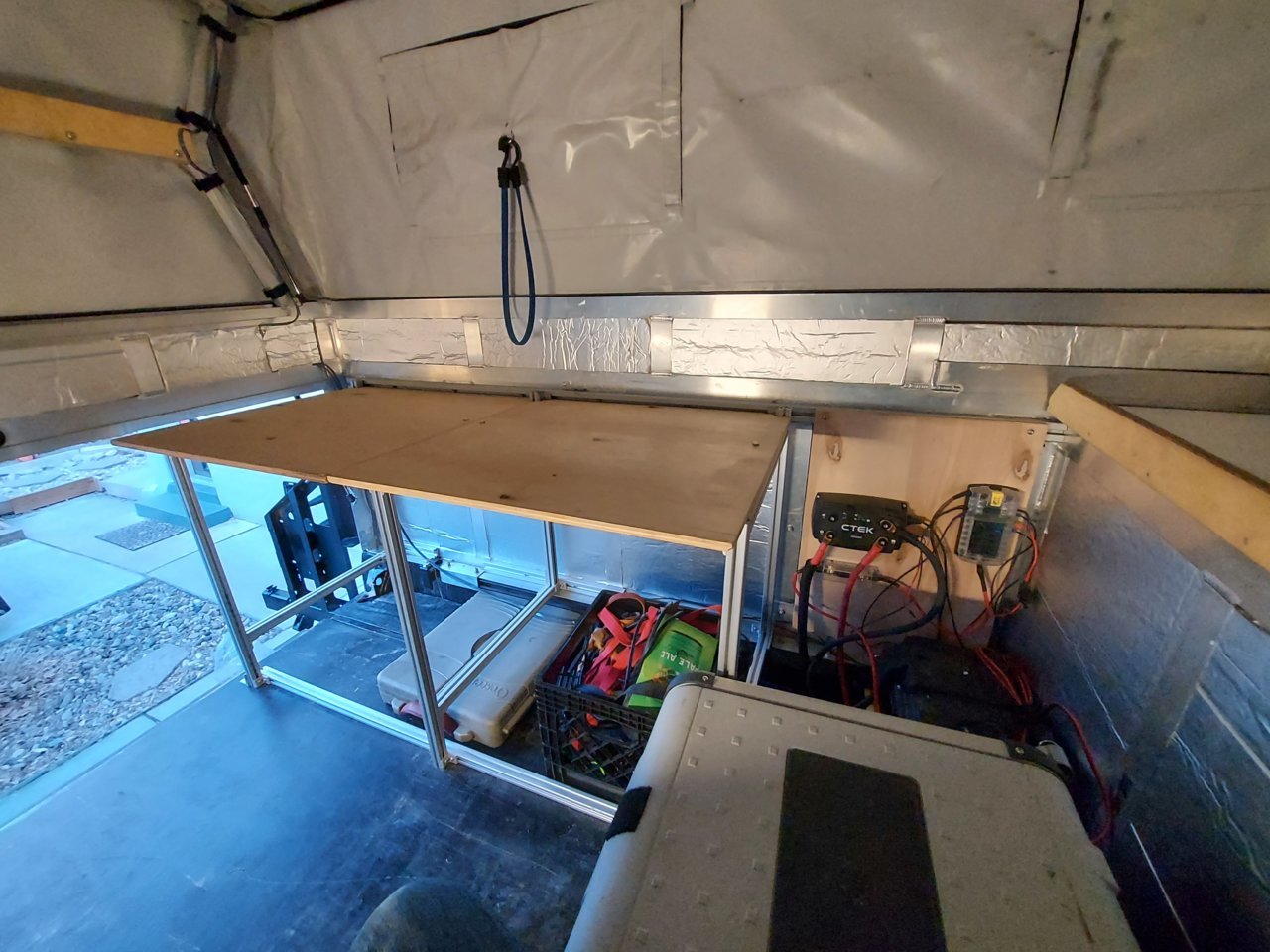

    I just finished building this frame of 10 series 8020 and put this plywood on top. I am stoked how it is going so far.

    Yeah, Baby! That's what i like to see. Nice work, Dave. That high table top will work well as a night stands also when the bed is pulled out.

    Thanks! Yes the night stand will help me not misplace my keys, wallet, phone, etc. Before I would have to fish these items out of the bed after I forgot and closed the camper. Now it just needs to warm up so we can go camping!
