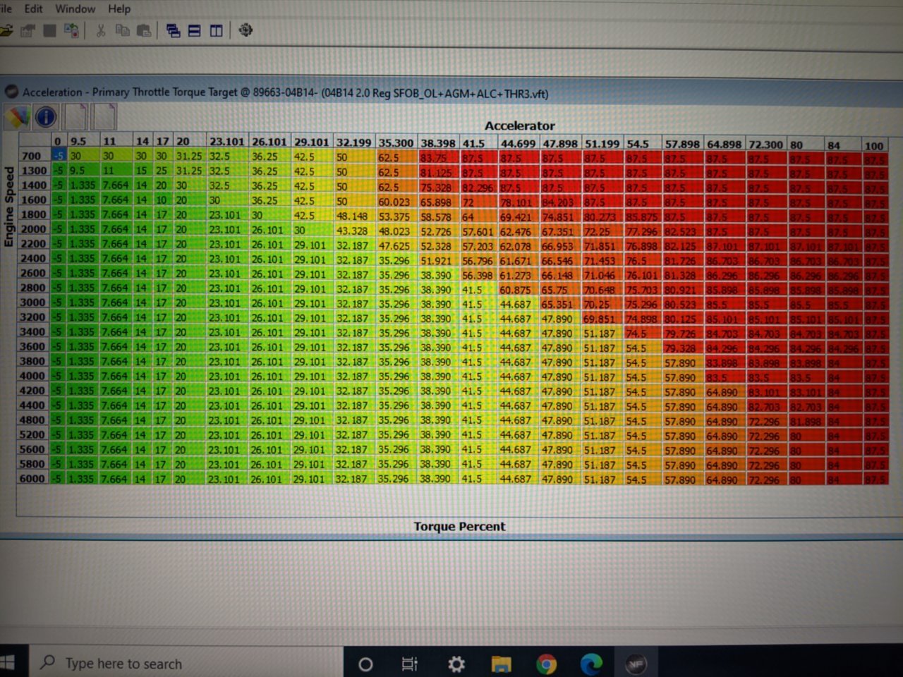

    A variation on the PTTT map edit:

    has anyone tried ctrl-I full PTTT table with first column zero instead of -5 ? i've seen a description but can't find it now, what is the purpose of -5 here in this table? or more specifically, was there a negative symptom of having zero there? too jumpy on tip-in?

    Yes. My kink is very subtle and could be gone.
    The -5 is for tip in and engine braking. Since @OVTune noted that we should keep 87.5 as the max, the min just sets the sensitivity. Think of it like a Pedal Commander. The only thing being said is that if you go too high there, the engine braking can fall off.

    looks like i understood it. but flattening that map didn't work for me. totally not a linear experience.

    As weird as it might sound, it feels very 1:1 to me? I actually got the vibe of older, responsive vehicles of ours. The throttle seems to be be following my foot, just taking a bit more of the throttle throw to do it.
    2.0 allowed me to generally forget about the throttle. No need to plan ahead, just drive with consistency. These edits somehow add smoothness and a linearity. I suppose with SFOB, I could just lay my foot on the pedal and it would react consistently but would still do some anticipation stuff? Reacting to conditions. With the edits, it seems that is back on me?
    The beauty if it all is that we can test, know exactly where the numbers are and what they are, and easily back 'em out if needed.
