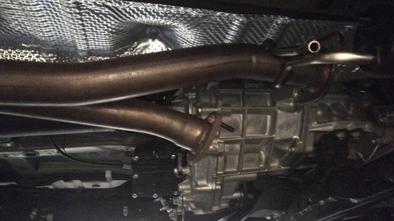

    The turbochargers are mounted right after the dump tubes, there is not enough room for the secondary cats. However primary cats are in place.
    We were able to do them in a top mount situation, but on the drivers side it requires moving the brake line, fuel lines, etc. Increased cost, and complexity.
    This setup is quite nice and easy to install, and the turbos are located where they will not see any damage off-roading either. Intake goes all the way back to the stock intake box so no water ingestion either.
    This is how they are mounted

    From this section back is stock
