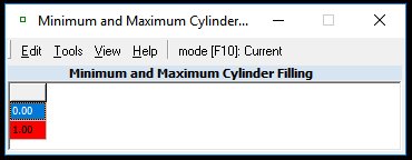

    No more VE filling limits!
    We haven't talked much about all the code work we have been doing to make boost work. But it has been going on behind the scenes. Unfortunately until I can find time to compile everything into a massive blog post I'll be posting forum crumbs

    So in English, what's this mean?
  19. Jul 15, 2019 at 10:14 AM
    #2599
    OVTune
    OVTune [OP] Well-Known Member
    Mar 27, 2017
    #214557
    8,112
    OVTune
    In English... it can be very difficult to make an accurate boost calibration/tune when you have no MAP sensor. (air pressure sensor). The stock ECU does not use actual air pressure when calculating things in the tune.
    It uses a static fill table for cylinders (basically 3D "cylinder VE"), it uses MAF and other 3D tables to calculate a "load" value, and then uses static "torque" tables to calculate a "Torque" value based on throttle.
    In stock form the ECU is not designed to supply the additional fuel requirements for boost, and as a result of having no map sensor, cannot see boost anyway, even if it were there.
    So, we have had to find multiple limiters in the ECU that limit "VE" / "Torque" "load" and change them. But doing only this is not enough. We also had to create our own tables, which we will show you, that compensates / multiplies requested fuel based on calculated load (from maf flow) and compensate based on current torque value (throttle position).
    this is so the ECU does not over-fuel when throttle position is low but load is high, where boost would be Pre-TB but not Post-TB. (The ECU would not know the difference because of a lack of map sensor).
    It's one of the most difficult code patches and algorithm I'e had to create, ever. It's still being tweaked.
    But think about it. How do you correctly tune for higher air pressure, if you can't measure the air pressure.
    NORMALLY, the ECU uses this method (which is shit!).
    If throttle position is less than X ... > target 14.7
    If throttle position is more than X > Target Fuel table OL
    I'm working on a 3D closed loop target fuel table but it's very difficult.
    That's it....
