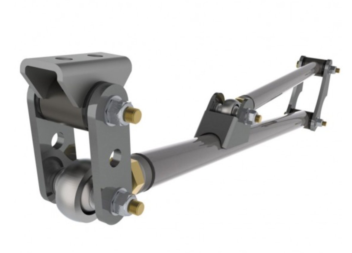

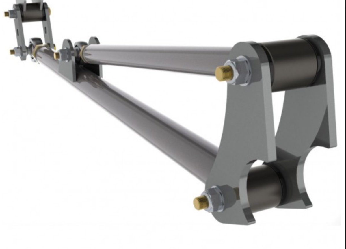

    Planning on installing the Chasis Unlimited floating ladder bar in preparation for FI. Pretty solid kit but I had them make custom brackets that will weld on closer to the rear diff housing instead of welding onto the axle near the exhaust & passenger side leaf spring. Takes some modification but I think it will work out better for off roading since the ladder (traction) bar will be running parallel and close to the drive shaft.Screen Shot 2019-06-30 at 8.26.19 AM.jpgScreen Shot 2019-06-30 at 8.25.59 AM.jpg

    Curious as to why you think you'll need traction bars with a FI setup. Is axle wrap that bad when going FI on a Tacoma? My Furd was pushing 500whp and didnt feel any axle wrap.

    Depends on how soft the leaf springs are.

    Ah that makes way more sense. I'm still learning the offroad suspension needs for high horsepower applications :thumbsup:

    I had Caltrac style bars on my Tundra with Deaver springs. They worked great and didn't limit travel/suspension movement while offroading at all.
    https://www.calvertracing.com/caltracs.html
    The issue was that those springs did not have an overload spring to act as a traction bar so the axle would twist so hard that the ujoints were binding. Also that truck was making about 600hp (crank) and had 325 series tires with a LSD so hopefully the power levels we're looking at on the Tacomas wont give us those kinds of issues that truck had.
