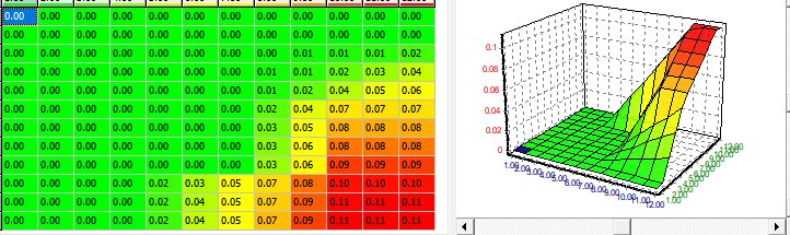

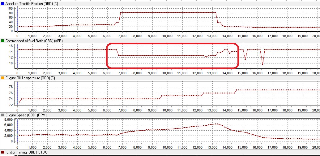

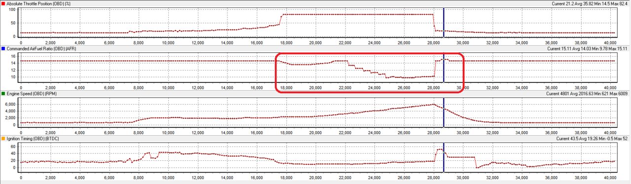

    We should have dyno results wrapped up saturday. I think you guys will be very, very happy
    Our boost fuel patch in action >
    You can see we have total control over the commanded fuel ratio, and resulting AFR. Unlike the stock tables which just goes from 14.7 to "full blast" after a certain throttle angle.
    This AFR commanded is a bit rich (this is on higher boost testing).. but you can see how the AFR will taper down as flow increases.
    vs stock which is just a set value
    - OVTune Fuel by load adder (*test version table)

    What are the x,y,z axis on the 3d table?
    No hints on power yet?
  3. Jul 31, 2019 at 11:43 AM
    #2883
    OVTune
    OVTune [OP] Well-Known Member
    Mar 27, 2017
    #214557
    8,112
    OVTune
    X = Absolute load
    Y = RPM
    Z = Command fuel compensation (add to)
    Hint: we're over 300ftlbs @ 2300 rpm on 3psi.
    I'm tuning from 3psi to 10psi. This engine loves the boost. However tuning for it is quite tricky, requiring a bit of code.
    But it's running and pulling beautifully.

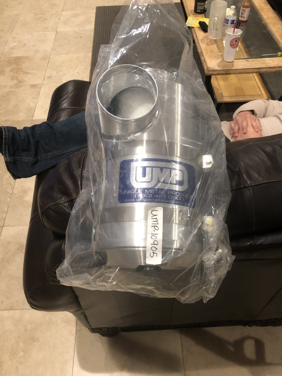

    What is this item?
    Is it a MAF sensor fitting for a auxiliary air box?
    I am wanting to install this in mine this weekend and that looks like the part I’m missing haha
    Inferno__Taco and PB FAB like this.

    Thats a Flux Capacitor ... wont work. You need 1.21jiggawatt alternator
    Shellshock and Torspd like this.

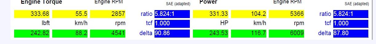

    Will this quench your horsepower thirst for a little bit?
    3-4psi runs,
    85+ ft lbs gain, 85+ whp gain
    This is on a HOT run from this morning.
    This is on the lowest boost setting.

    What is the thicker red line measuring?
  20. Aug 1, 2019 at 11:06 AM
    #2900
    OVTune
    Mar 27, 2017
    #214557
    8,112
    OVTune
    stock truck
