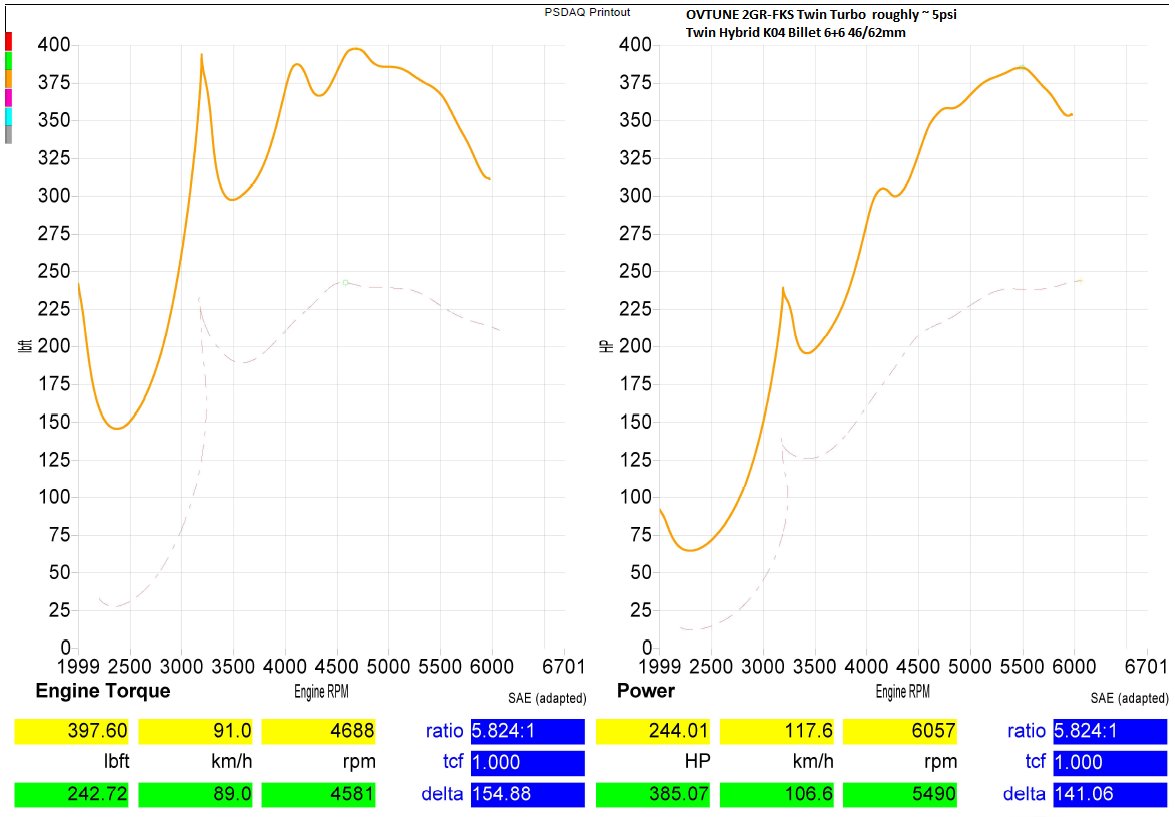

    So,
    here you go.
    Below 3500 rpm can be pretty much ignored on both graphs (due to shift control). It's a "stock vs boosted" 1:1 comparison. because to get accurate full torque readings in low RPM range requires gearlock + some additional TC controls, which we will show off in a separate graph.
    141HP gain
    155 ft lbs gain

    Still funny to see the stock motor does well over 100 easy haha
