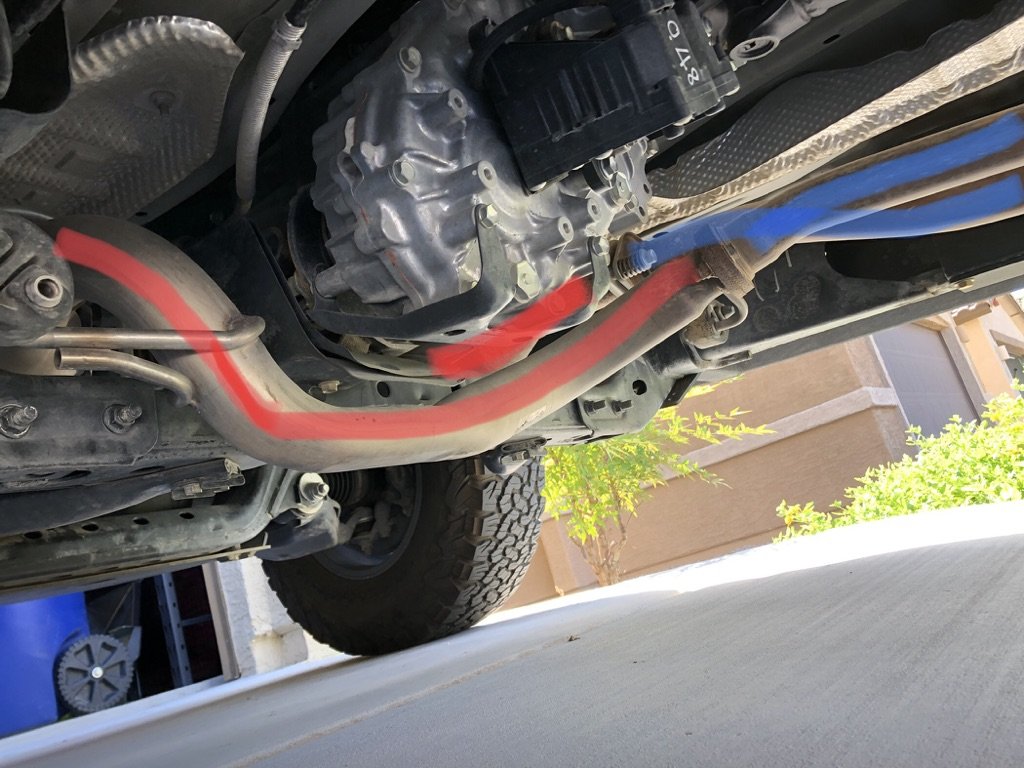

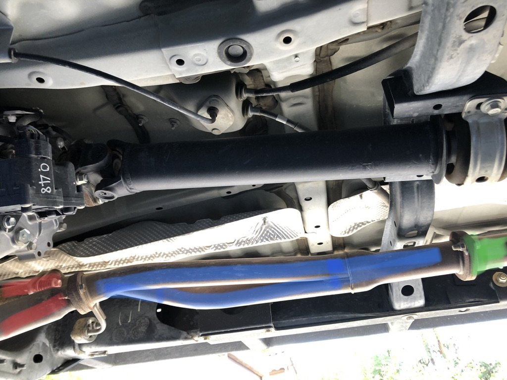

    @CaptainVoodoo , correct, the URD y-pipe handles everything from the dump tubes back to where the Y terminates. Considering the OV dump tubes terminate at the same location as the factory dump tubes, and the tubros will attach to the dump tubes, one could assume the first section (highlighted RED in picture) of OEM exhaust between the dump tubes and where the Y becomes one pipe, will be replaced by the turbos and modified exhaust that is provided by OV.
    I do recall him mentioning the possibility of an entire exhaust setup, so there is always at. Then we wouldn't have to worry about any bottlenecks at all with high boost applications.
    With all that said, this will likely not be an issue at all with lower boost applications. It looks like he made plenty of power on just 5psi of boost, that will keep plenty of people happy.
    RED = replaced by turbos / ties back into factory y-pipe.
    BLUE = possibly an optional replacement. No known alternative at this time to OEM.
    GREEN = OEM 'cat-back' to rear of truck
