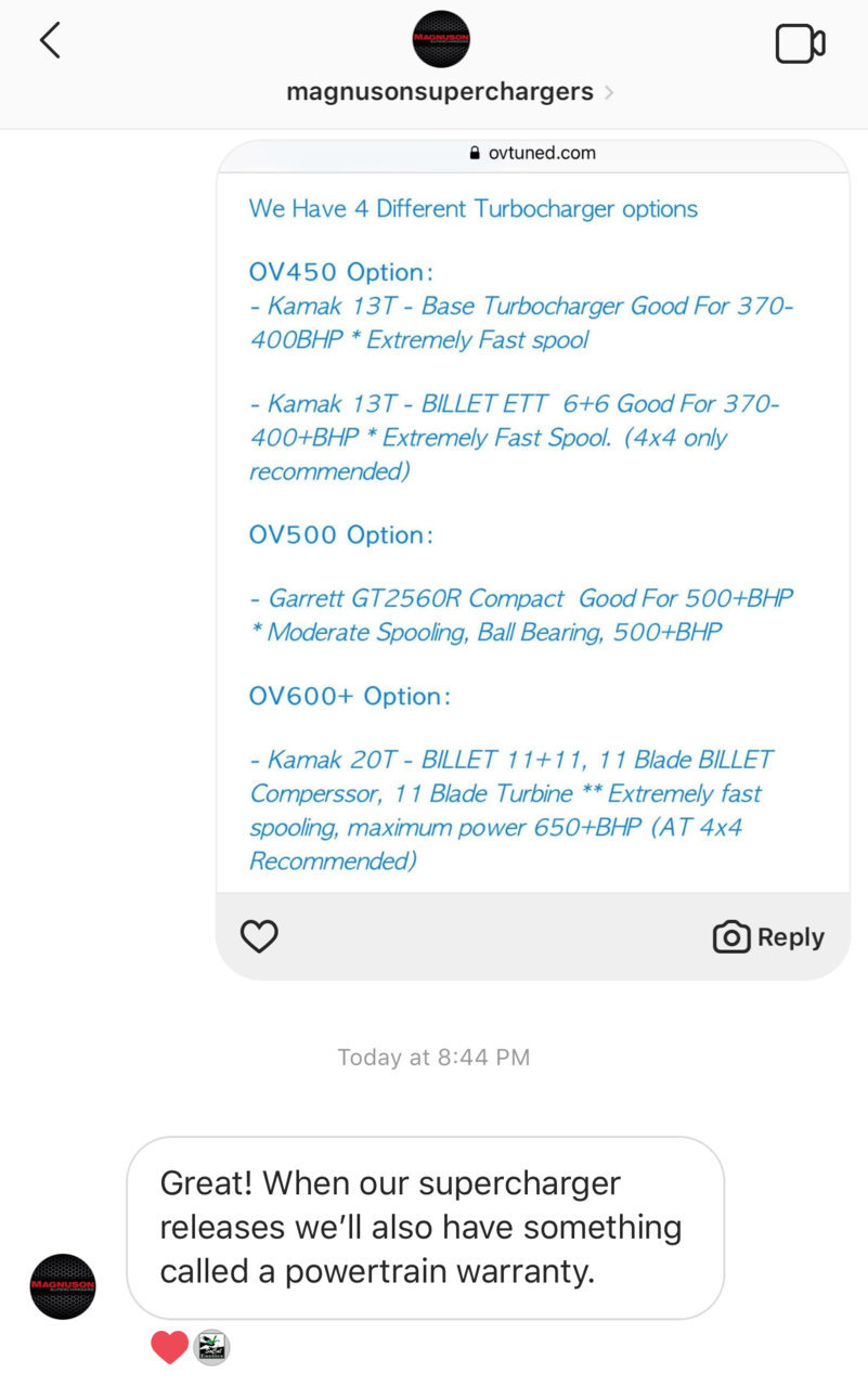

    I think Magnuson is mad.

    Maybe they should have built something then.

    what supercharger

    That SC will never release lol you'll be done with the 4.0L Tacoma and whatever else before then

    The first 2 are what look to be modified Mitsubishi Heavy Industries TD04-13t turbos. The most likely have the same small exducer housing and cartridge and probably the same shaft. The small exducer housing size is the key to the “extremely fast spool”. They likely share the same compressor housing however the second option will have a more aggressive machined billet compressor wheel and the compressor housing should be machined internally to match that wheel. So basically it they should spool the same but the 6+6 will build more boost than the first option.
    The third option is a Garrett ball bearing turbo. Which means the shaft rides on ball bearings in place of bronze bushings. That sets it apart from the other 3 bushed turbo cartridges. I am assuming that the 3 kamak turbos are bushed shafts as there is no mention otherwise.
    I offer little input on ball bearing turbos as most of my experience is with diesel turbos with the exception of the 3 Supras I have owned. I
    The 4th is going to be a larger turbo than the first 2. It is also I believe to be a modified MHI turbo. Will have larger exducer and compressor housings. Thus it’s sligh slower spooling time and ability to support more HP.
