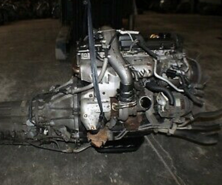

    Still hoping that there will end up being some sort of test or at least feedback from someone with regards to hot turbos being suddenly exposed to cool water, i.e. water crossings

    Turbo diesel Hilux, or any other turbo diesel vehicle. Should be a good start for searching.

    In reference to my water crossing comment? Do they also have turbos mounted low?

    I would imagine if you search around a little, you will find something online documenting this. Even though it’s mounted higher than the OV twin setup, it is still well within the possibility of submersion. Here’s a pic of where the turbo is located on the 1kz-te that comes in the land cruiser prado, and other Toyota vehicles over seas.

    I think guys know damn well what will happen when hot metal is submerged in water, I question motives as there's clearly a supercharger option

    I agree.
    Here’s the thing.. quenching a turbocharger in water is never going to be an ideal situation, but there is a huge difference from taking a hot turbo that has been run hard and loaded up, thus increasing the housing temperature dramatically, opposed to fording a river with a relatively cool turbo. You won’t find me doing it, but it’s 100% been done on many occasion without any immediate issues resulting from said forge. There is plenty of documentation online if you search for it.
    I would be just as concerned for items like my Alternator, A/C compressor, general wiring, transmission shift modules, and of course the waste-gate actuator(s) that will also be submerged.
    Tl/dr submersing your truck is never ideal, regardless of turbos or not. Can it be done without a cracked hot side? Yes.
    If you absolutely have to ford water with a turbocharger that will likely become submerged, stop, let it cool down, and you won’t have to worry about a cracked housing.
