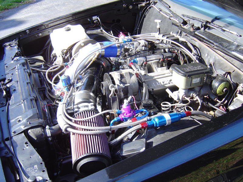

    Big fat ditto to this.
    Why the fuck even bother for 75-90hp at the crank ? @$6500 ??? :crazy:
    I've owned turbo cars and supercharged. My vote is for turbo(s). and 450hp at the wheels. The 8.75" rear diff will handle it. It's the same gears/pumpkin as the 5.7 Tundra.
    @OVTune
    Have you considered a setup similar to the old Buick Grand Nationals ? I've owned several over the years. Stupid simple and stupid fast with old school tech on 231 cubic inches.
    The factory single turbo was IIRC a 36mm unit with a 3 bolt flange, but it came with a vacuum actuated wastegate setup. The LH exhaust was plumbed under the engine and brought up the passenger side, integrated with the RH exhaust manifold where the turbo mounted... in the same approx real estate you are using for a centrifugal blower. Turbo downpipe followed alongside the RH manifold and had a single pipe exit under the car. The cold side outlet dumped straight forward, conveniently in the direction of a FMIC.
    Just thinking outloud.
    Carry on fighting the good fight. :burnrubber:
