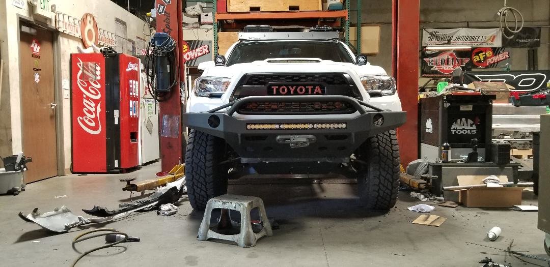

    That low intercooler location is going to cut a huge piece of your market out. I would bet a large number of those who want this are also the people who already use that space for bumper and/or winch.

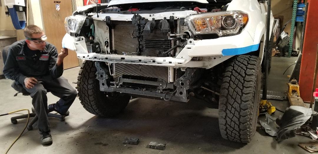

    If this intercooler is in the way then there must be quite a few other things in the way on these trucks from factory, like the big transmission cooler, the bracing for the hood latch, etc.
    Regardless, the intercooler can be moved pretty easily.
    The only thing is the hood latch support. You can't close the hood without it, as the metal is flimsy and bends. But I have a billet piece made for that.

    I’m less concerned about collisions from aftermarket things. I’m more concerned about airflow restrictions caused by aftermarket things

    Make them fit in here! I think the winch makes this a no go unless Mat can get more creative! Ho would SC work on trucks with aftermarket bumper and winch?

    Should be a simple job for a competent fabricator to reweld the inlet and outlet and readjust the location of the intercooler.
    Modified trucks need modified parts...

    It's not difficult to move the intercooler people.
