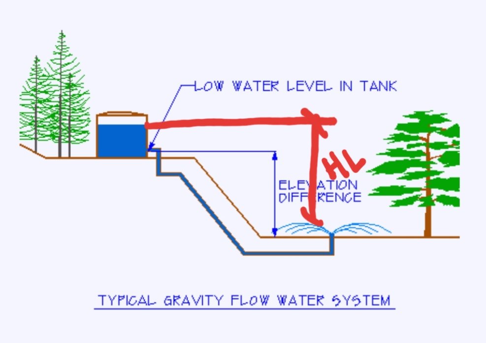

    Question, how are you able to flow oil back into the pan through the oil drain plug? The last time I turbocharged a car the one major requirement was that oil had to drain back into the pan ABOVE the oil level.
    At the time this was because the oil return required gravity to flow. Keep in mind, this was on an old 90's Honda Civic. I believe this had to do with oil getting stuck in the turbo and oil leaking into the hot side causing oil to burn.
    J
    Reh5108 likes this.
  10. Dec 9, 2019 at 3:51 PM
    #4710
    soggyBottom
    soggyBottom Well-Known Member
    Sep 19, 2018
    #266818
    1,991
    It'll drain as long as the turbo is above oil in the pan.
    Just think of the turbo as that water tank on the top of the hill.

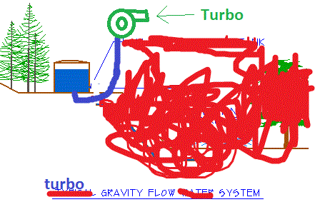

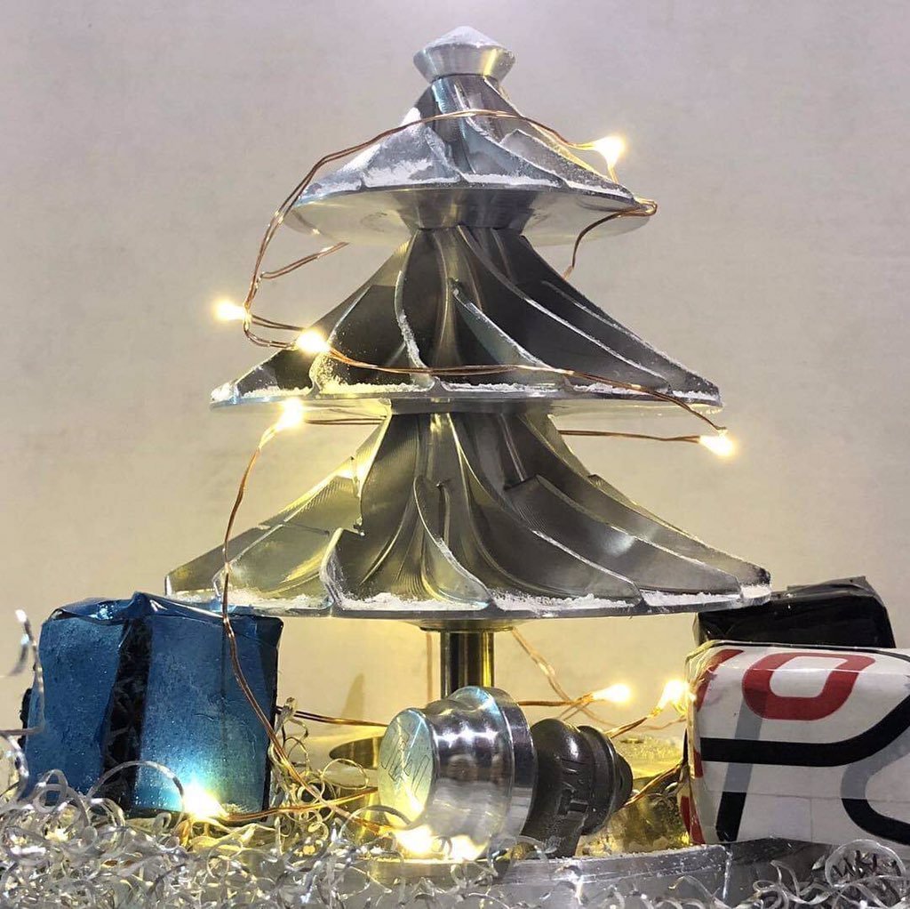

    but what do the trees represent in the turbo system?
    Skydvrr likes this.
  12. Dec 9, 2019 at 5:16 PM
    #4712
    GoldenBrew
    GoldenBrew Insufficient Privilege
    Dec 18, 2016
    #205159
    2,758
    Golden, Colorado
    Gen3 4X4 TRD OR AT - SOLD not Forgotten
    Those are all the non-turbo charged / boosted 3rd Gen, 2nd Gen and 1st Gen Taco owners GREEN with ENVY of us BOOSTED 3rd Gen owners! :broccoli:

    Those are the compressor wheels

    All the things!
    Damn, that's a pretty inefficient conveyance system. Look at that head loss.

    1,991
    Must be all those 90deg bends

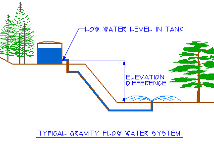

    So we aren't gonna talk about how terrible of an analogy this is?... Not really ideal to plumb it there unless there is something OV knows that I don't. I can see issues arising if the oil level is at higher levels in the pan, like being off-road and having the truck at different angles. Or maybe there is a scavenge pump on the drain pushing in back to the pan? Again, maybe there is something I don't know but I've never done a turbo drain setup to the bottom of the pan like that.
    Also not to mention low hanging oil return lines that can get snagged offroad, or smashed under a skid plate.
    Try this for a better diagram...
    EDIT: I did an experiment on this years ago on an old BMW 3 series. Used a clear piece of tube to watch the oil level in the drain and tapped up high it stayed pretty low. While at a lower spot on the pan the oil level in the clear drain tube was nearly at the bottom of the turbo...
    Just an idea but if y'all haven't tested it with a clear tube for a drain you might try that and see what it does at different angles/oil levels in the pan.
