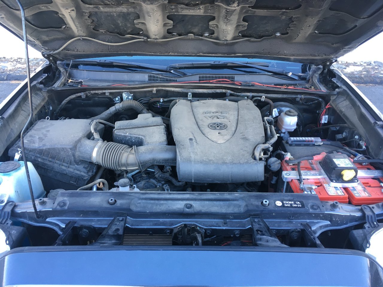

    @OVTune can you post some pics of the engine bay with the complete turbo system installed? I’m trying to figure out if these will fit in the SR5 trucks since the ABS is in a different location from TRD models

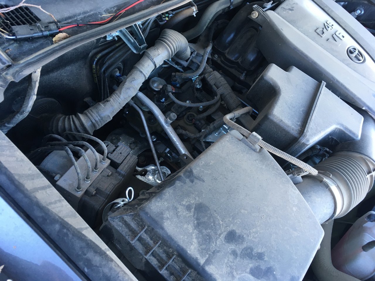

    Passenger rear of engine bay is ABS location for non-TRD models
    Also, are my dual batteries in the way?
    87E09DC9-89DB-4338-8AE9-FD1ECB0C6837.jpg 58D4CCC9-6740-4185-8AA9-BB256FC14A31.jpg

    How nice, will fit even easier on this version
    Batteries look fine

    What size batteries are those? I’ve never thought to put two that way.
    Sleipnir likes this.

    Group 35, ODYSSEY part# 35-PC1400T

    Be careful if you actually wheel hard with that dual battery side by side setup.
    I managed to break of the entire oil filler head on a trail in Arizona the engine has some play obviously and will knock the filler neck. If you wheel that is.. I went with the other option and put my other battery behind the air box
    understand I might be moving my second battery to the bed to fit the TT

    Cant put it behind the airbox, ABS is there on non-TRD models

    Also, some people are ripping/cracking their trays with a dual setup like that.
