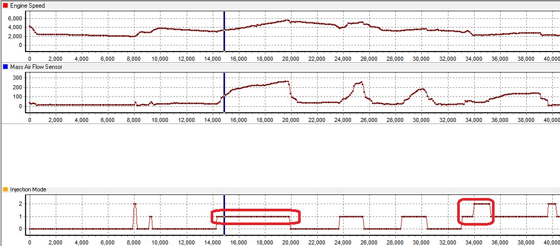

    you can see here we have full port fuel control at high loads
    PFI = 1
    DFI = 2
    normally impossible on stock ecu
    using this new table.
    you can see in the second red circle, PFI and DFI cross can happen at lower RPM and high load to cool the cylinders to prevent knock.
    So we use PFI to (20%) to mist the charge, and 80% DFI to control knock
    this allows for.....
    an excellent ignition curve for boost
    with the ECU increasing from no knock detection.
    and you can also see less than 1* KR transient correction going into boost
    most of this is just raw data as we dial it in. Just want to show you guys we check, test, verify everything.

    What's the x/y axis?

    Question from pure curiosity.
    In the high RPM ranges are you switching completely over to PI? And if so, is there no advantage to DI while in boost?
    I recall from my own research that DI engines allowed for more ignition / compression simply due to more fuel making it into the combustion chamber which I am sure you are well aware of, especially with your background, Although with its own problems (ie, Carbon Buildup on the intake valves). With that being said can you apply these advantages of DI for more “efficient” power? Less fuel but more power?
    Or is it simply that PI provides enough fuel for that sweet air/fuel ratio while in boost?
    Hope what I’m saying makes sense. Thanks for all the updates here on what you are doing. Can’t wait to see this get into people’s hands.
