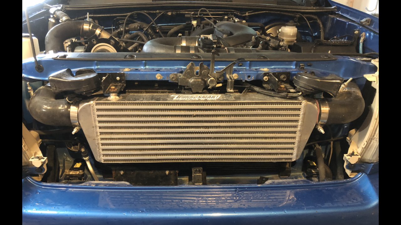

    In the summer it can get pretty hot, I run a 170° degree Urd thermostat kit and monitor the water temp and tranny temp using a scangauge 2 and usually the coolant temps float around 80° Celsius (176°F) and up to 88° When towing.
    To answer your question I didn’t monitor the ‘before’ temps so I can’t tell you the difference but it’s well within range post SC install. If you live in hot climate and have concerns a few good guys on TW help pioneer the CSF aluminum radiators for the 2nd gen. Maybe it can work on the 3rd??

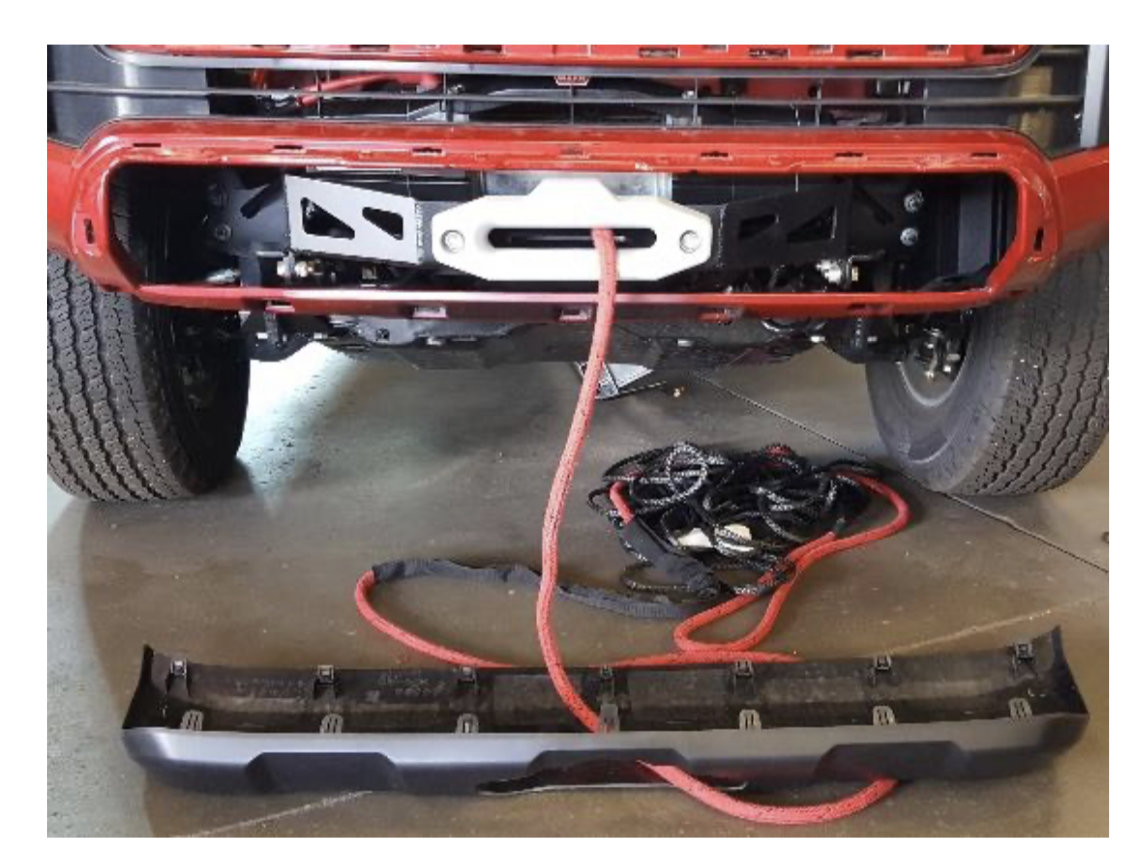

    So far nobody has shown me exactly how and where these winches mount so I cannot make any decision on any design change.

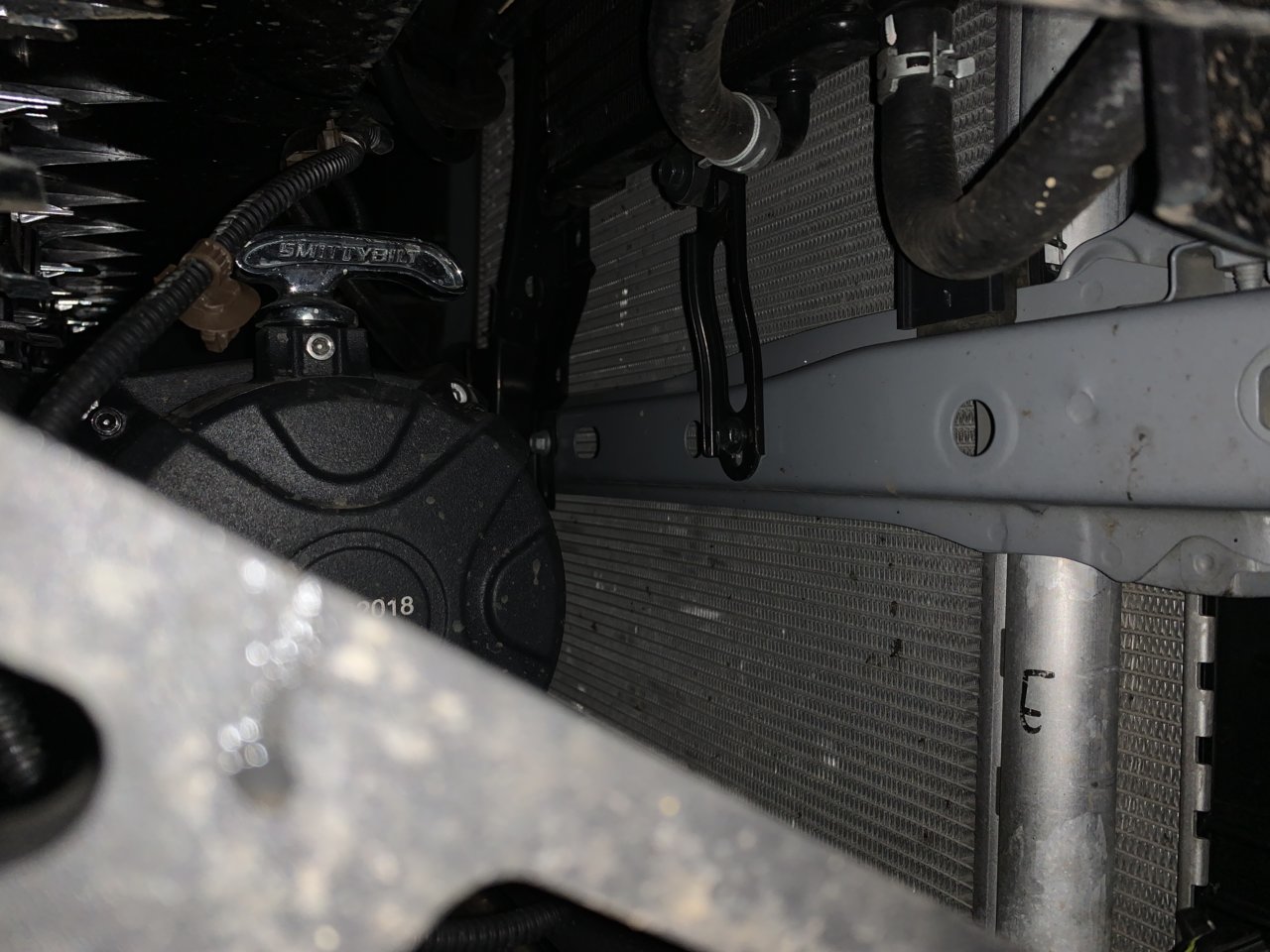

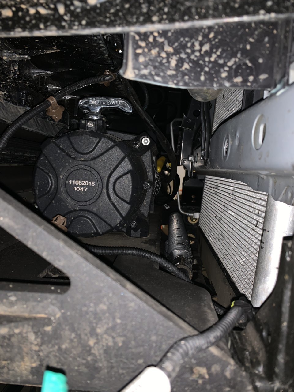

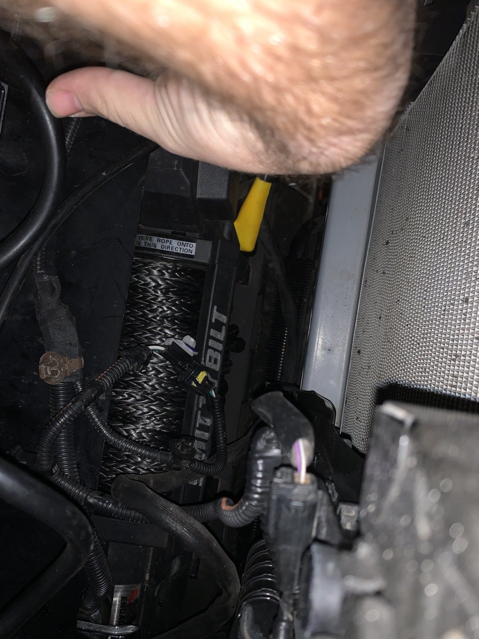

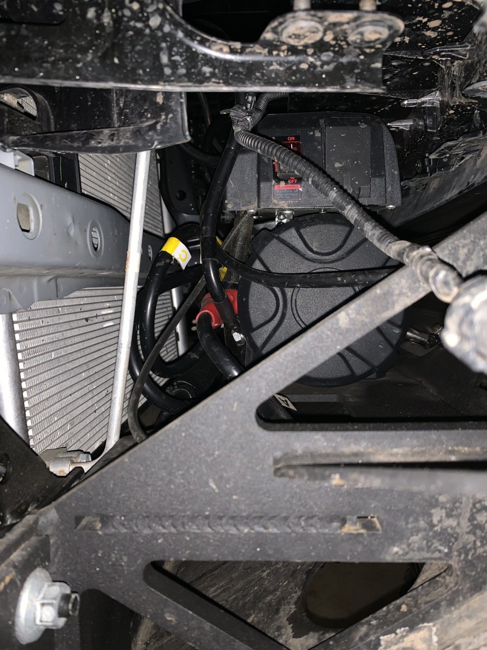

    Maybe these will help @OVTune

    most of them are something similar to this. They remove crash bar and mount there right where the black nose is. The lo pro ones are the same just a bigger piece installed and that bumper section cut out.
    Install instructions for SDHQ hidden winch
    https://cdn.shopify.com/s/files/1/2493/2184/files/55-1650-G3_Install_Instructions.pdf?17415
    https://sdhqoffroad.com/products/16-current-toyota-tacoma-sdhq-built-hidden-winch-mount

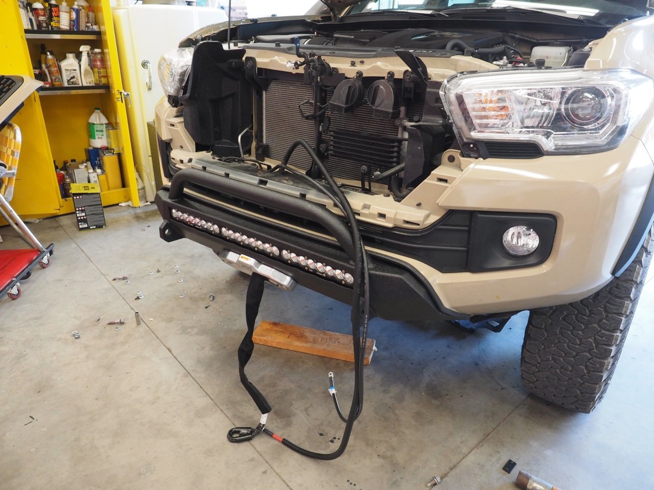

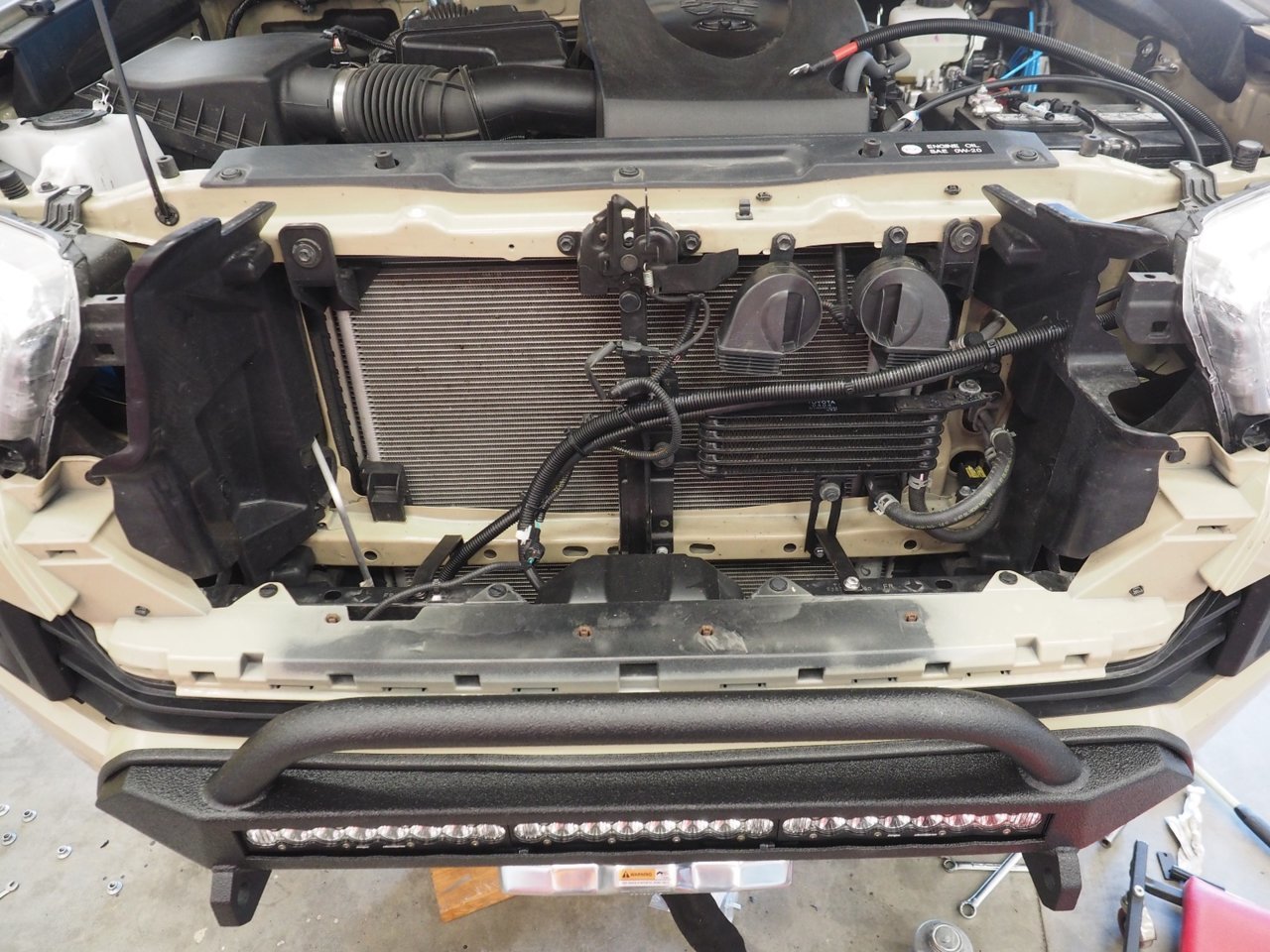

    While people use different winches and bumpers, one of the most common bumpers is shown in this winch install thread. All other bumpers that I'm aware of install in the same general fashion. As others have implied, it would only take a few inches to be a problem, but the more room you can give us, the more room we have to move other stuff around.
    My apologies for it's length, but it does have some very good pictures. NOTE: The installer (Hodakaguy) removes a brace/bracket that others installing the same winch do not remove.
    @Turd Hawg a few pages back confirmed he has this same winch. If this one can be made to fit, others will not be a problem.
    To non-winchers: Thank you for your patience. Don't worry, Mat can manage his time and we'll be off this subject VERY soon as there really is only so much he can do. And it will be on to other things for him.

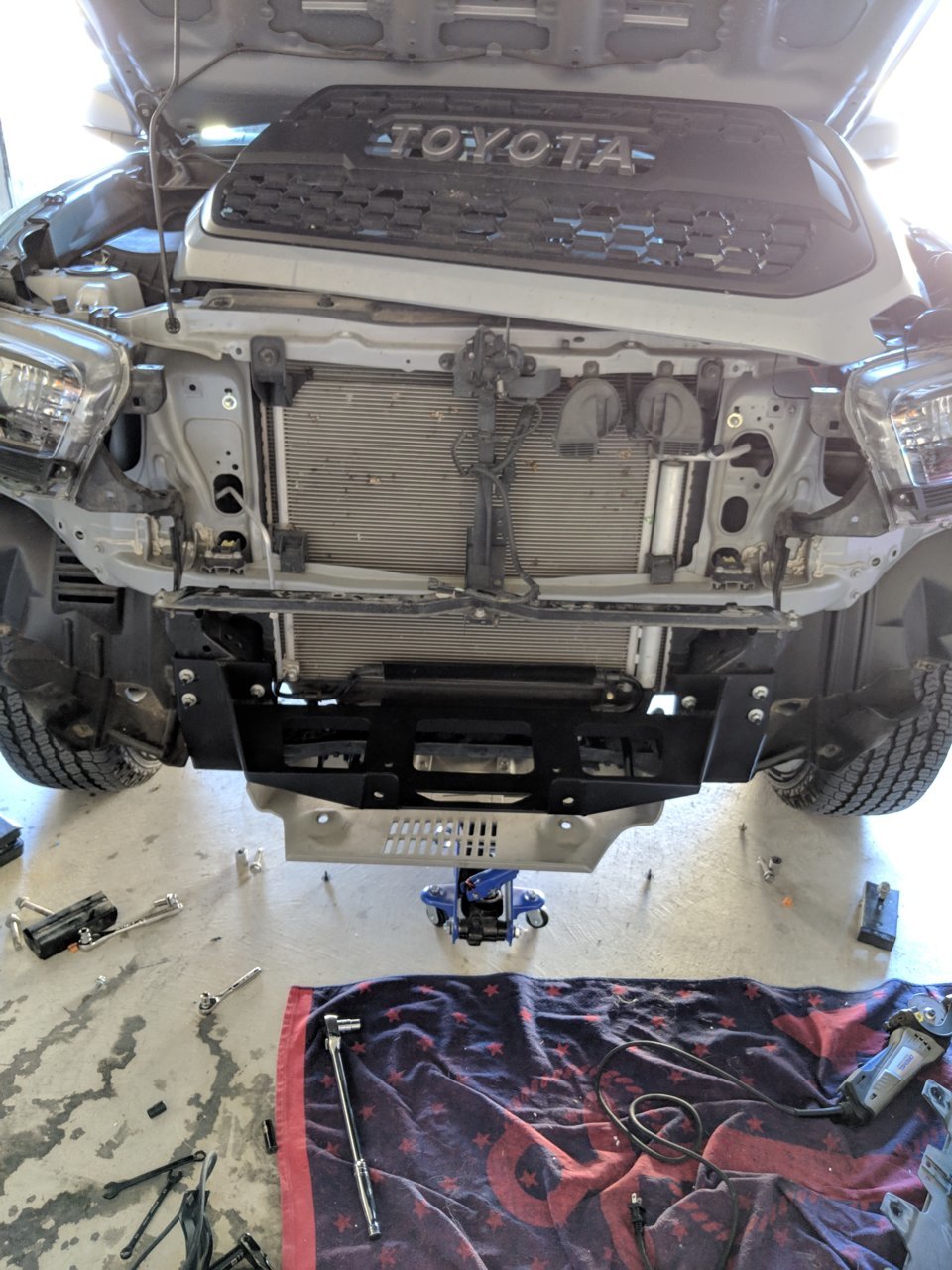

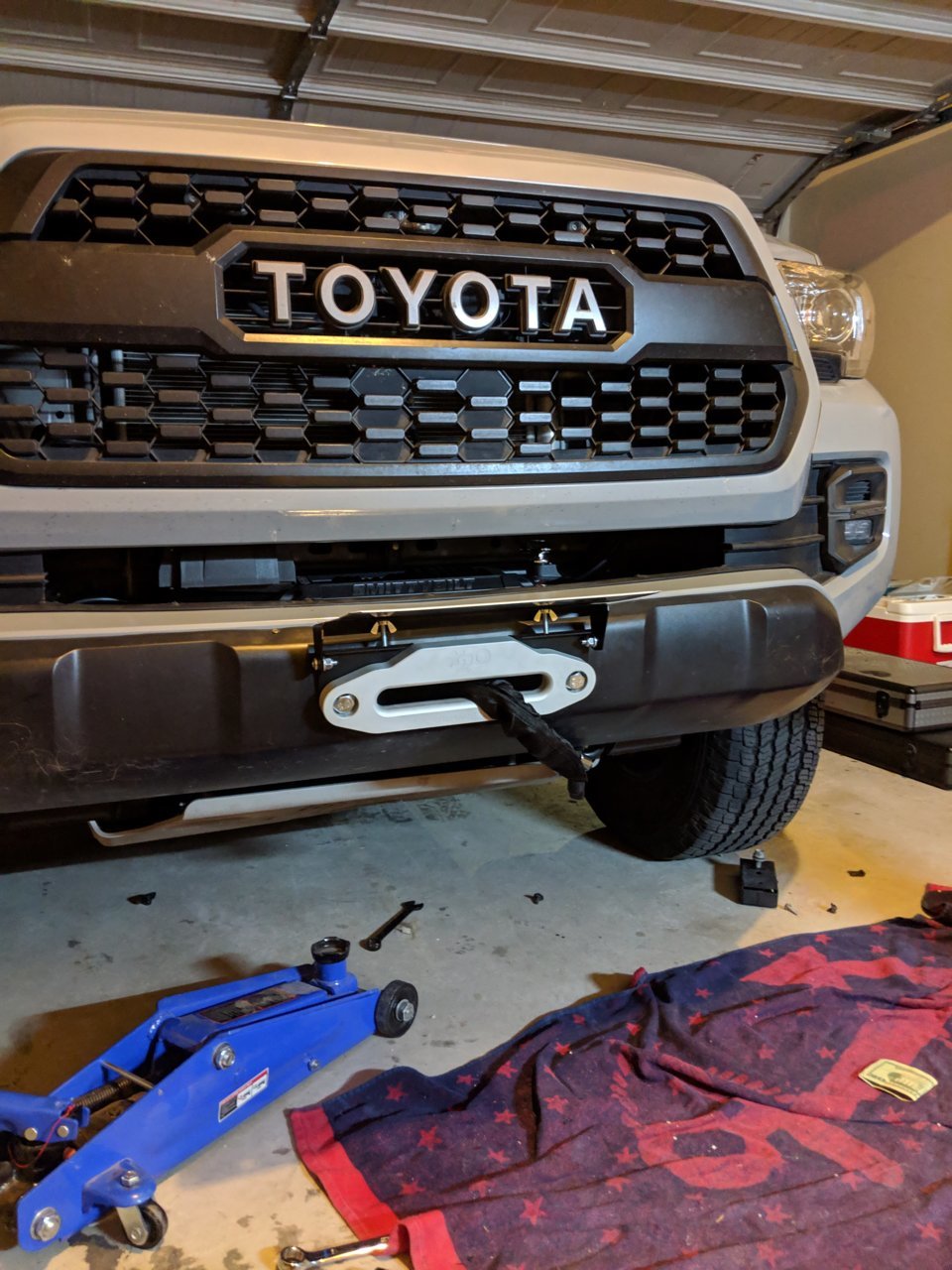

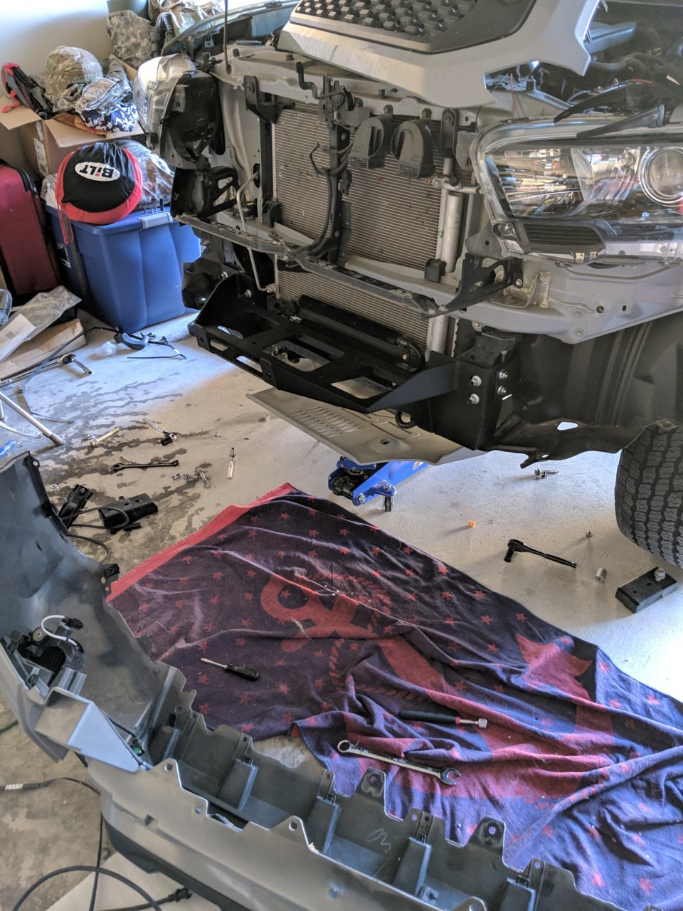

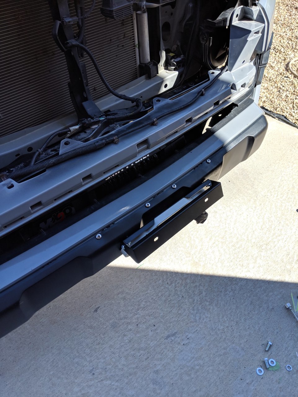

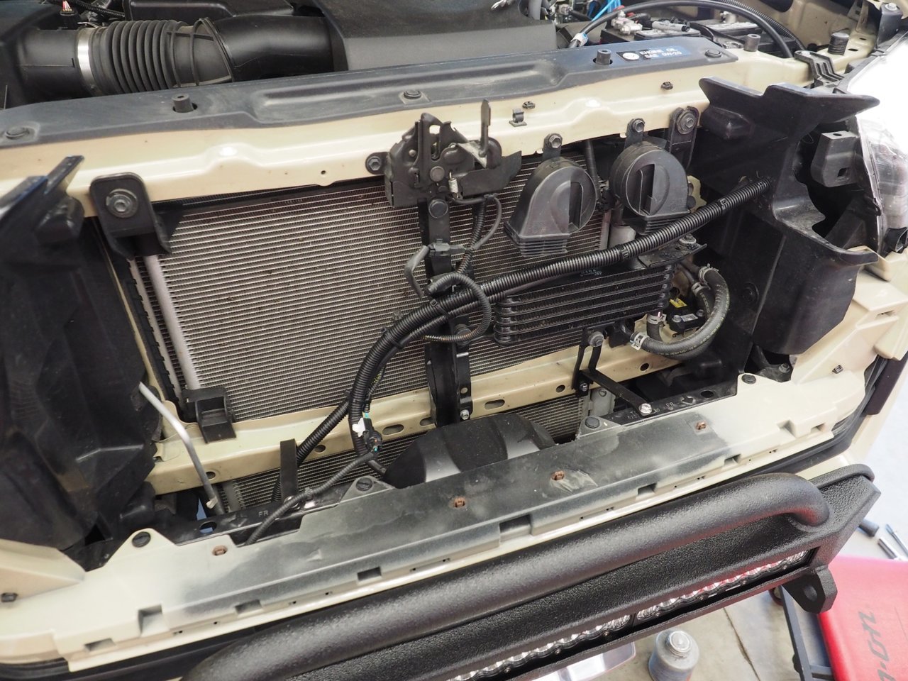

    Not my pics but. This is the SSO slim line. I think it would be similar to all the slim line bumpers and probably many other plate bumpers.
    Hope this helps!

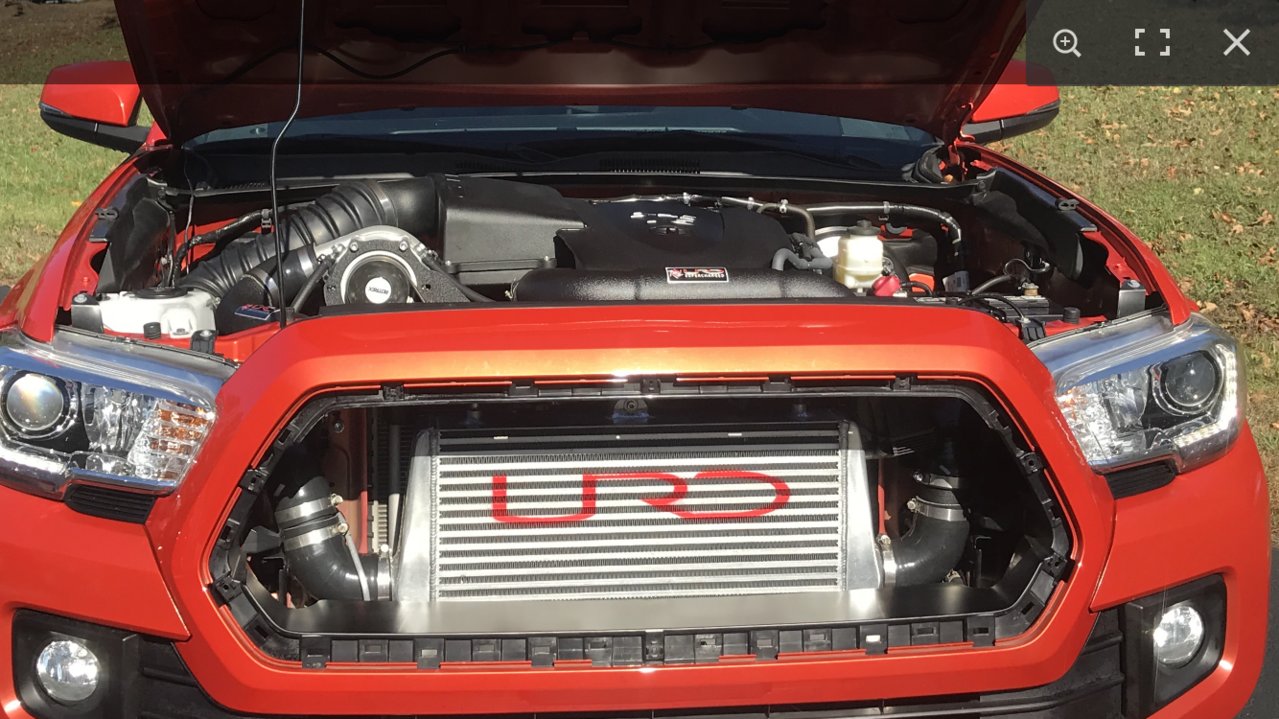

    For those who have winches (myself included), it appears that the intercooler will easily fit in front of the radiator. The intercooler will otherwise not fit any lower than that with the winch. Speedwaytacotuesday has shown how this can be done with a little customized bracket and piping. If you are not able to do the fabricating, there are plenty of local shops that can likely handle this. I personally would rather OVT concentrate on tuning and getting the TT kit to market for both the MT and AT trucks.

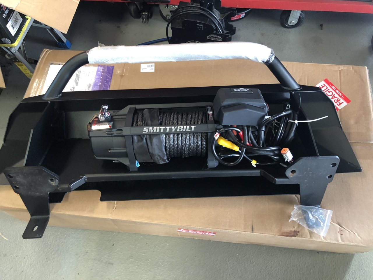

    I have the CBI hidden winch mount and the Smittybilt 10k X20 and it mounts to where the crash bar mounted. That bar gets removed and placed with the mount for the winch.
