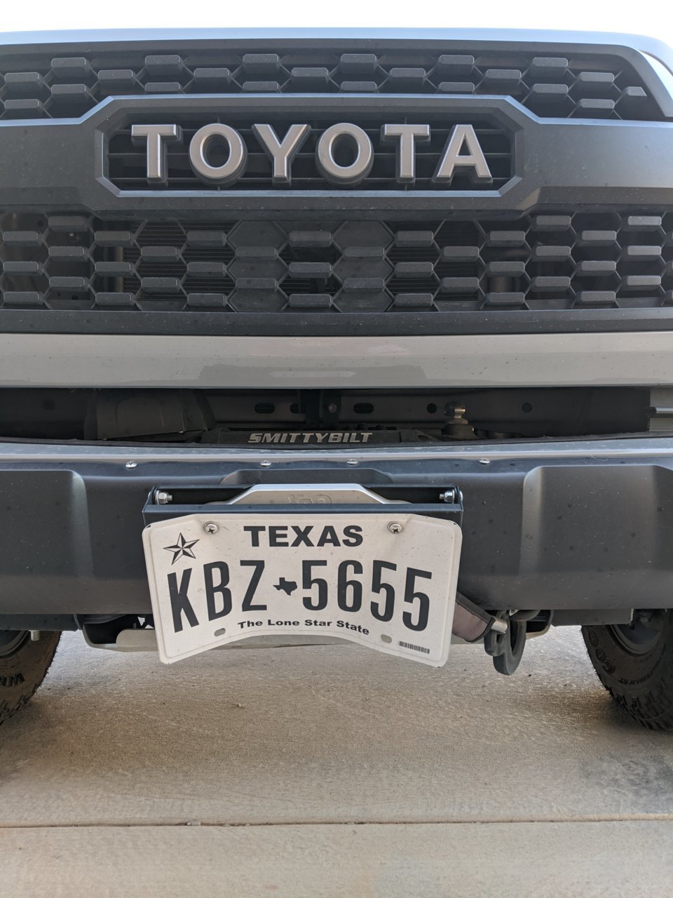

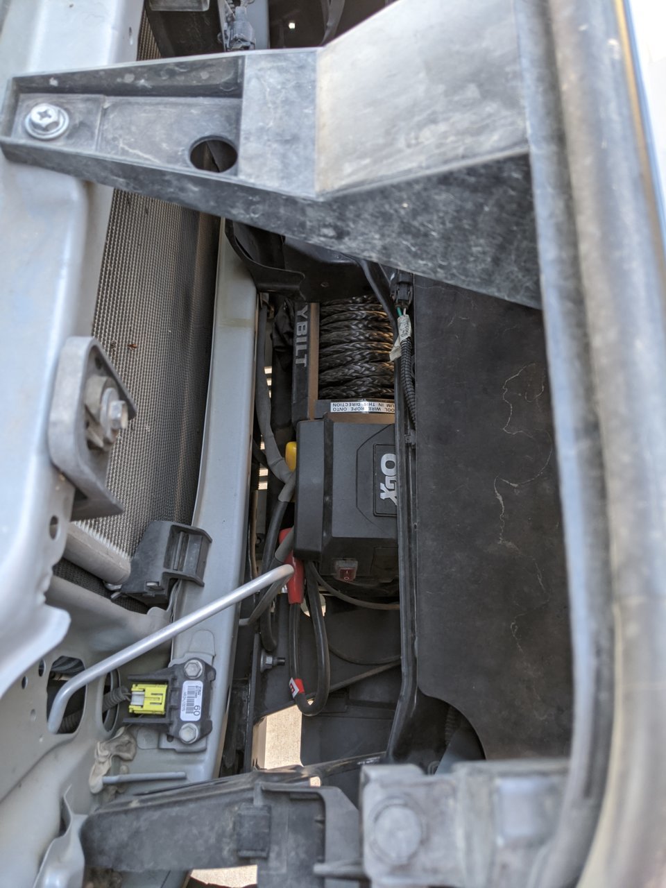

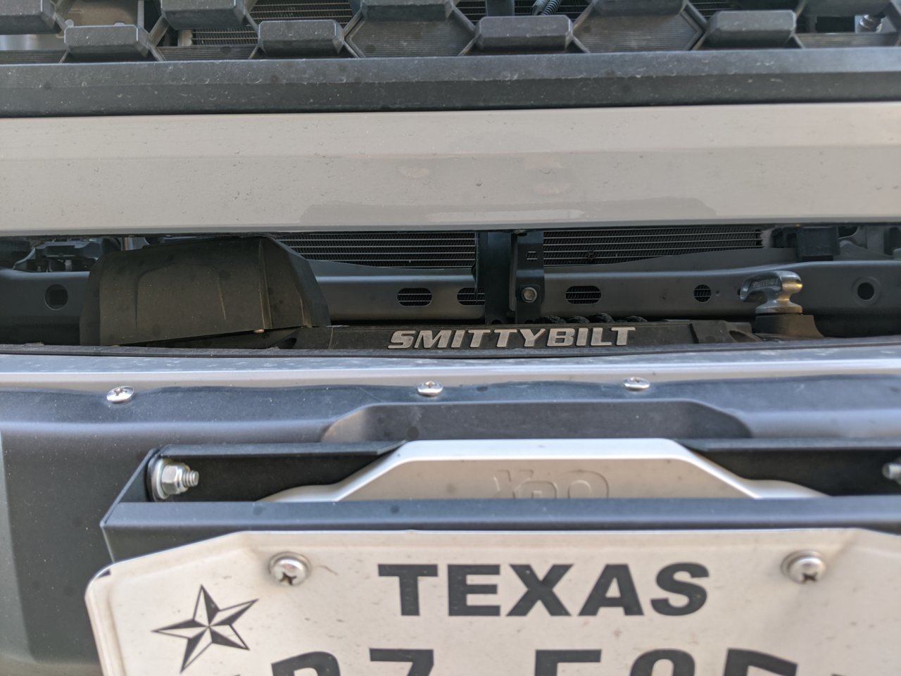

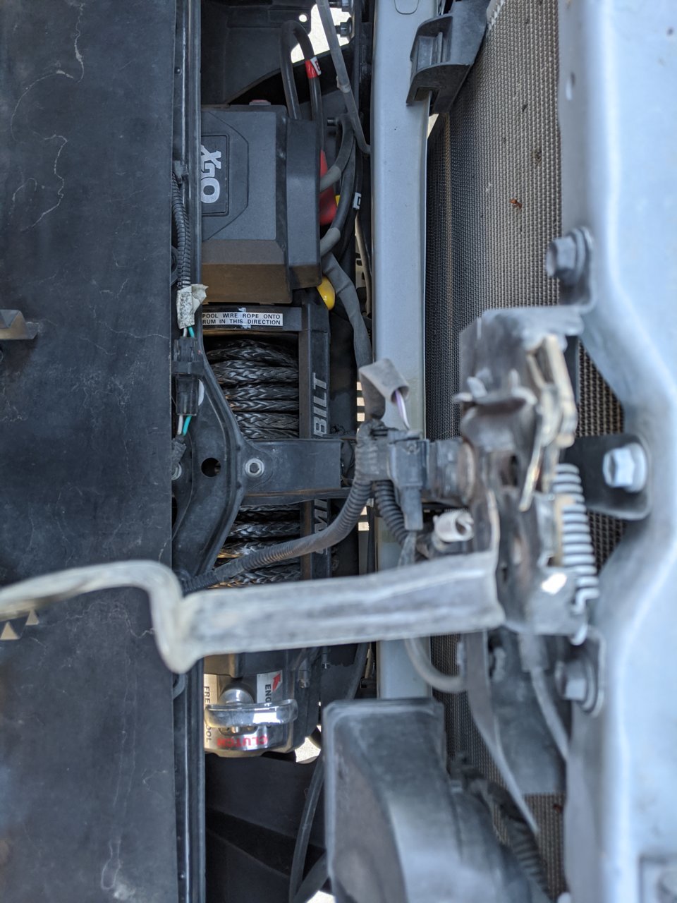

    Here's a few more photos that I just took @OVTune
    Hopefully these and the ones I posted above are at least somewhat helpful
