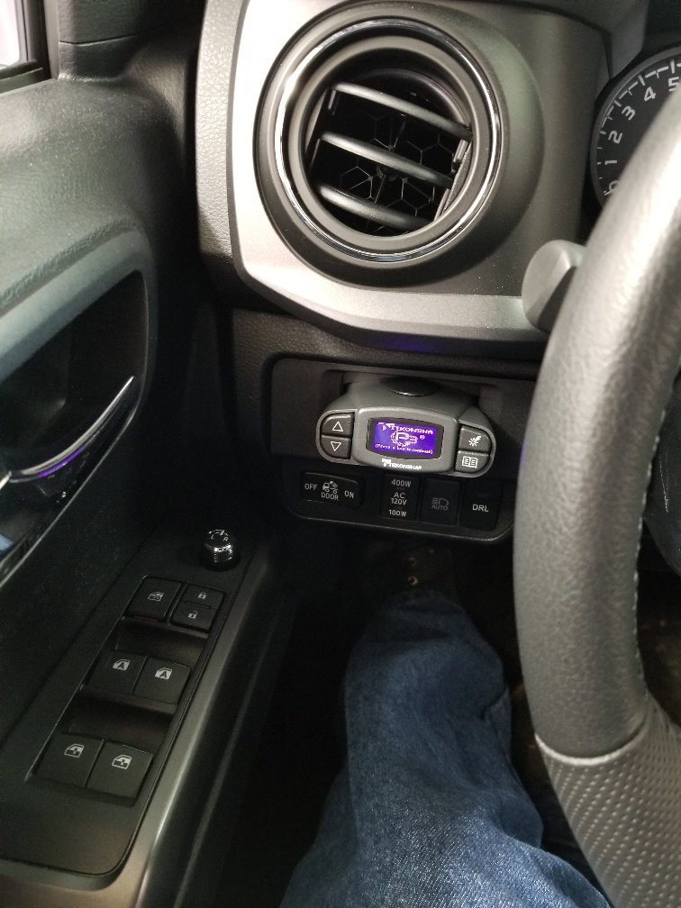

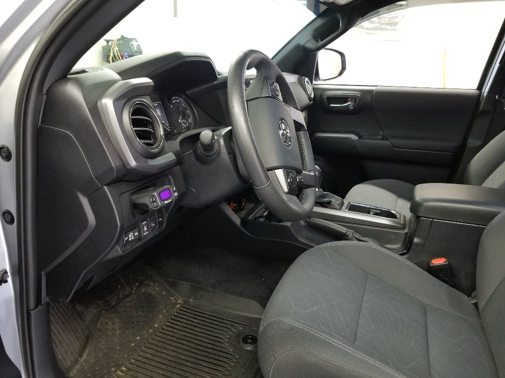

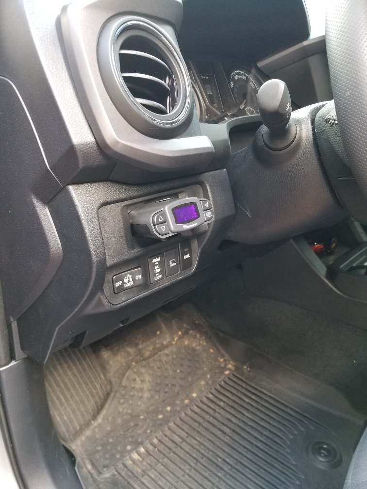

    I have this on my truck and it's worth every penny.
    Super smooth brake application.
    Just set it and forget it.
    Mounted mine in left side cubby with the trim kit mentioned above.

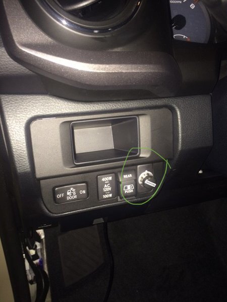

    Sounds like a challenge. Can the cubby (upper left) of the circled in your picture be popped out? I've been looking at the tekonsha for a long time and considering 3d printing something.

    Yes. There’s a couple ways you can go about it. When I first bought the truck in early 16 there wasn’t a replacement cubby made to fit the P3, although someone now sells one. I took mine out and cut the rear out, then stuck the controller in the cubby. I found a replacement at the dealer when it comes time to replace the truck, However it seems more cost effective to just buy the cubby designed to fit the controller if you ever plan on taking it out when you sell the truck. It would cost less too.
    I can’t remember where said cubby is sold, although I bet you could find it with a little googlefoo.

    I put one in my 16, I just drilled a hole in the back of the cubby for the wiring and did some filing and shoved it in there. Worked fine for the 2 years it was there.
    esp makes the mount most people use

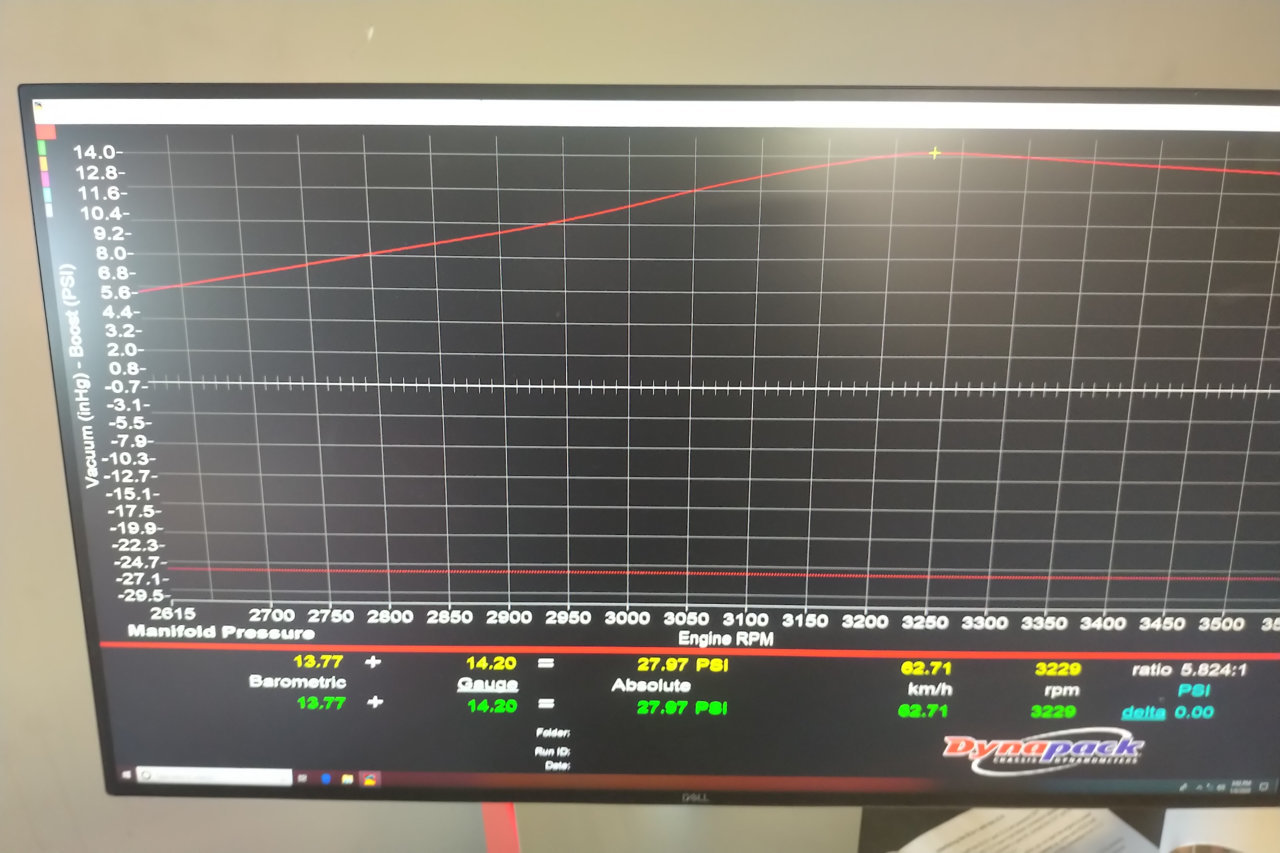

    Powermax turbos are installed. Fit very nicely. We are using different wastegates, so the kit will come with new wastegates that are adjustable by spring rates.
    Tuning starts on 6~7psi.

    Will test from lower rpm soon.
    Stock fuel system is fully taxed above 10 psi on these.
    14psi peak at 3100 rpm (starting at 2500)
    Spool on these is very very nice.
    Dyno reads 5-6psi @ 2000 rpm.
    We're tuning it for 14psi peak on the big boy kit :)
