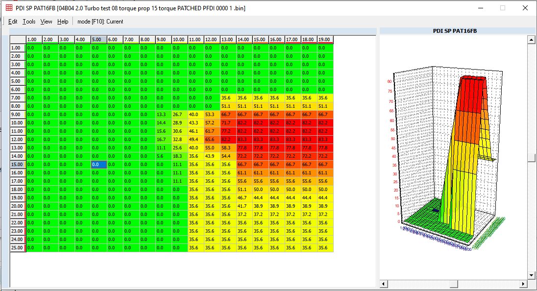

    I know I mentioned this in some post before, but I wanted to update that here,
    our code patch for PI / DI control works well, and is so useful for boost tuning to eliminate fuel guess work.
    The stock ECU has 3 injection modes, and 3 injection mode controls.
    Basically, there can be port only, direct only, or combined port and direct.
    Then, it can be modified by engine temperature, load, rpm (3 times).
    To eliminate this and ensure fuel is still safe even when the engine is cold and only wants to use a certain injector, we have eliminated the 3 modes,
    we now have 1 mode, and direct split control. (port, direct, combined).
    This table (see below) and our code is active from the moment the truck is started, regardless of engine temp.
    Fuel is critical to engine longevity with boost, and I don't plan to "hope" the ECU will figure it out in XYZ mode.
    So this fuel patch uses only our table, with a requested Fuel split from this table. (0 = pure DI,)
    also, the DI system alone can't handle 14psi :(. would be nice though.
    So, we are going with our previously explained method, of splitting the fuel. Direct injection is great for reducing cylinder temperatures, while PFI can supply huge amounts of fuel and cool the incoming charge.
    All of this will be in our Twin turbo blog post this weekend.
    I am excited to get this powermax kit on the street.

    Have you guys thought about developing a high pressure fuel pump for this? I know Xtreme di makes aftermarket pumps for certain applications but would be cool to see you guys make it work with them to make one. Also have you thought aboit a hpfp cam grind to allow more fuel in? Not sure if it'll help with the 14psi issue or not though
