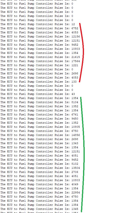

    Busy day.
    cleaning up our signal processing, and changing some algos.
    We have steady and reliable ECU feedback for the pump.
    Red - cranking event
    Green - Truck is running
    This is raw data being fed back, calculation of microseconds to complete 1 wave cycle period. This is then internally calculated by the FPC to a duty cycle for the pump.
    I know all these little updates don't mean much but this is actually really fun. I'm thinking we will have this wrapped up and dyno'd by the end of the week.

    Nice. Looks like you have plenty of resolution there...
