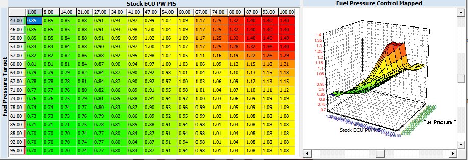

    compression tester, new plugs and such are on my desk.
    Haven't updated this in a bit, a lot of the time spent has been dialing in this fuel pump controller.
    a lot of signal processing/filtering was necessary as we were getting between 20 to 40 second "duty" time in the span of 5 seconds. So that's been fixed.
    So...our fuel pump controller code takes multiple measurements the ECU has sent, filters and averages them, does a sanity check on values, then calculates the duty cycle for the pump
    FYI
    stock fuel pressure release valve is 95 psi
    The sucky part is the stock fuel pump controller does not get to see fuel pressure as a value.
    instead the ECU sees fuel pressure calculates duty freq.
    Then the stock fuel pump pressure calculates the necessary energizing charge bullshit. bullshit.
    So pressure is an emulation based on quick changes in ecu frequency.
    pain. in. the. ass.
    here is what our fuel pump control look up duty would represent.
    these values are stock PW * VAL

    2018 TRD OR M/T
    Out of curiosity, would there any reason to monkey with the fuel pump controller/pressure on the non-turbo tune or just an issue for the more serious requirements of boost?

    I would think it's more of a thing for boost. More boost means more air which means it'll need more fuel. Even if you mess with the controller on non-boosted it wont be near the same scale as you would with boosted applications. Kinda like how they make tunes for the 5.0. Gives you like 30hp but nothing near what a turbo 5.0 could produce.
