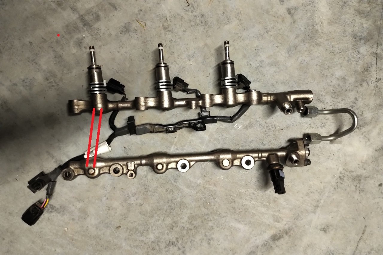

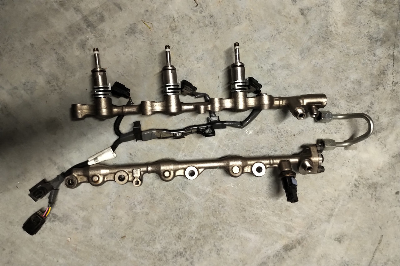

    no exact date, but shooting to be on release around the same time as the upcoming superchargers, if not sooner...since we are already working on solving issues they will inevitably run into.

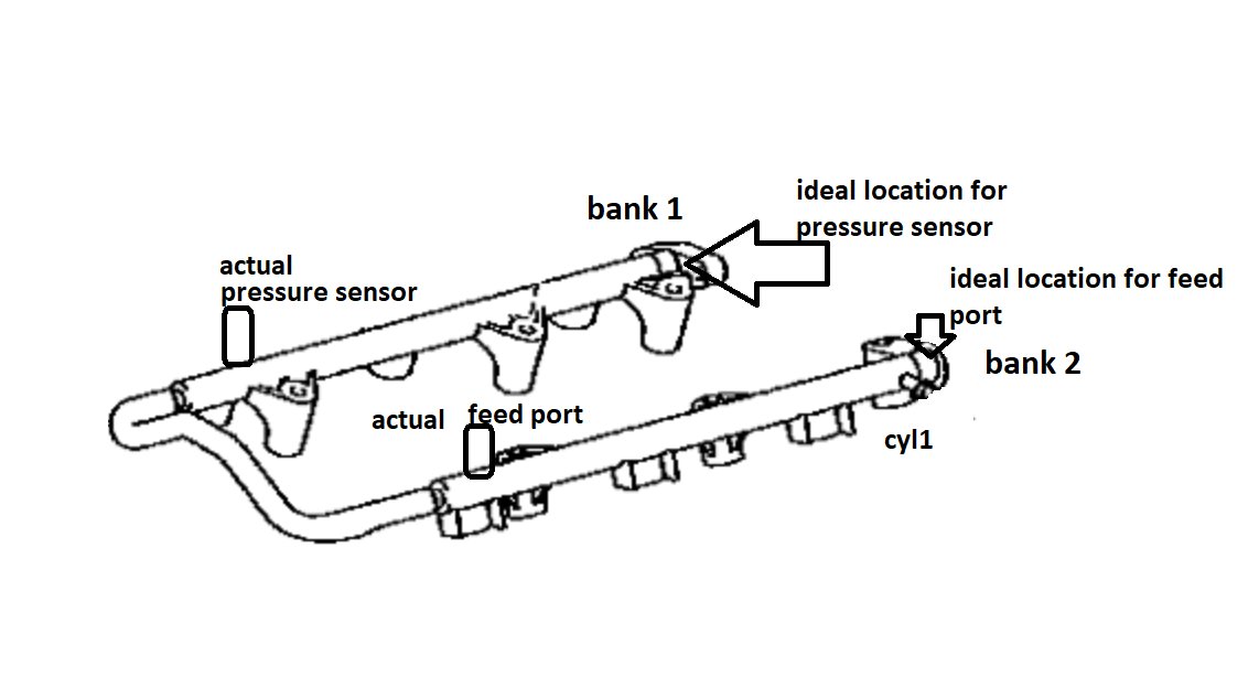

    So, our direct injection rail setup is just … doesn't make sense from a per cylinder accuracy perspective.
    I have the rails pulled off our spare engine, but here is the basic of how it is...
    couldn't find an accurate diagram of it online.
    But basically, the way it is setup allows for cylinders 1,3 and 2,4 to receive less fuel than cyl 5 and 6. This is because of the location of the feed port and pressure sensor.

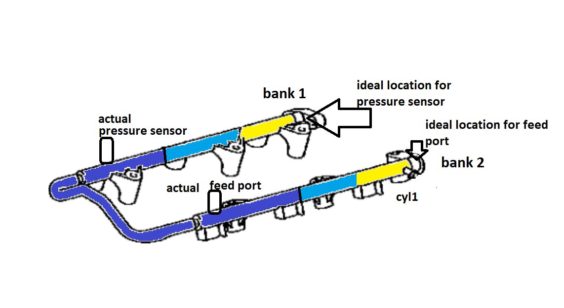

    unfortunately, with stock design
    dark blue is where pressure will remain near target
    as you move away (lighter blue) there will be more pressure drop during each injection event
    and as you get to yellow there will be the most pressure drop (and equal flow drop)
    I have datalogs showing pressure fluctuating during injection events in boost up to 600 psi drops. (from 2400 psi to 1800 psi or LESS ).
    That's a 600 psi drop AT THE SENSOR.
    could be much more during injection events @ yellow

    Is it packing issues? On the stock engine, the pressure drop must not matter very much?
  10. Feb 4, 2020 at 3:57 PM
    #6170
    OVTune
    OVTune [OP] Well-Known Member
    Mar 27, 2017
    #214557
    8,112
    OVTune
    You can see here what I am showing.
    On a bone stock engine you're not really flowing enough fuel to cause concern.
    On high boost applications this setup just says "kill cyl 1 and 2 for me please"
    Pressure is measured before any pressure loss from cylinders.
    So a 600 psi drop at the sensor...imagine the flow loss at the far end of the rail.
    The most.....confusing part is bank 2 (the bank with the fuel feed) is the bank consistently dropping fuel vs bank 1 ( pressure sensor side)
    The longer I look the more confusing this is from an accuracy perspective.

    So we still will be supplementing fuel with Port injection, but we still primarily NEED direct injection at low RPM and high boost in order to ensure there is no pre-ignition. At higher RPM this is not as much of a concern, but 3000 RPM and below, it's critical. Since we are capable of producing more than 20psi on the powermax kit as early as 2400 RPM, it's required.
    to be safe in my opinion I need a minimum of 80% fuel to be given by direct injection and 20% or less for PFI just to reduce the charge temps as they are coming into the cylinder. at higher RPM, it flips, and we rely much heavier on the port, because pre-ignition is not as much of a concern.
    We may not even have to upgrade the HPFP if we have a better rail setup.
    Either way, it looks harder than it is to fix.

    Heck even just creating a connection here would fix it.

    Drill and tap that bad boy!

    I haven’t messed with hpfp systems as I have been out of the car game for a while. If I’m looking at the fuel rails correctly, what about using a larger fuel feed line for a bit more volume? I’m specifically looking at your picture, the thinner U shaped line.
