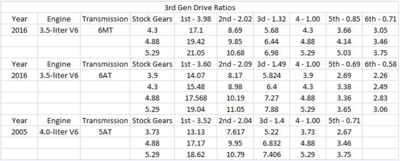

    I didn't realize how poorly geared the AT was in comparison to the MT. Even with 5.29 gears the AT 5th and 6th drive ratios are similar to the stock 4.30 MT 5th and 6th drive ratios. No wonder why the AT owners complain. With a little boost, I think the stock 4.30 in MT will work great. Curious to see which gear ratio works best for the AT under boost

    yep the stock AT sucks. if I still had mine, I'd have definitely gone to 4.88s with my stock tires.

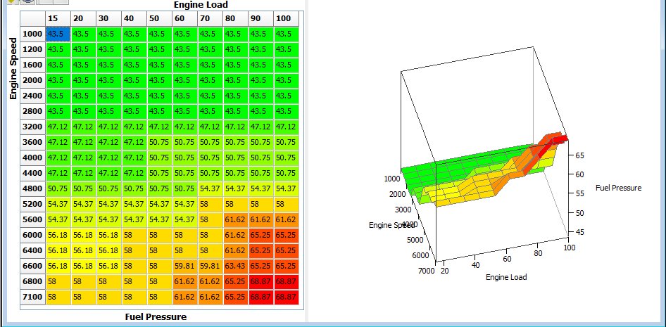

    OVTune
    not for sale yet
    but our software will let you control the pump, target pressure, etc :)
    check it out, target low pressure
