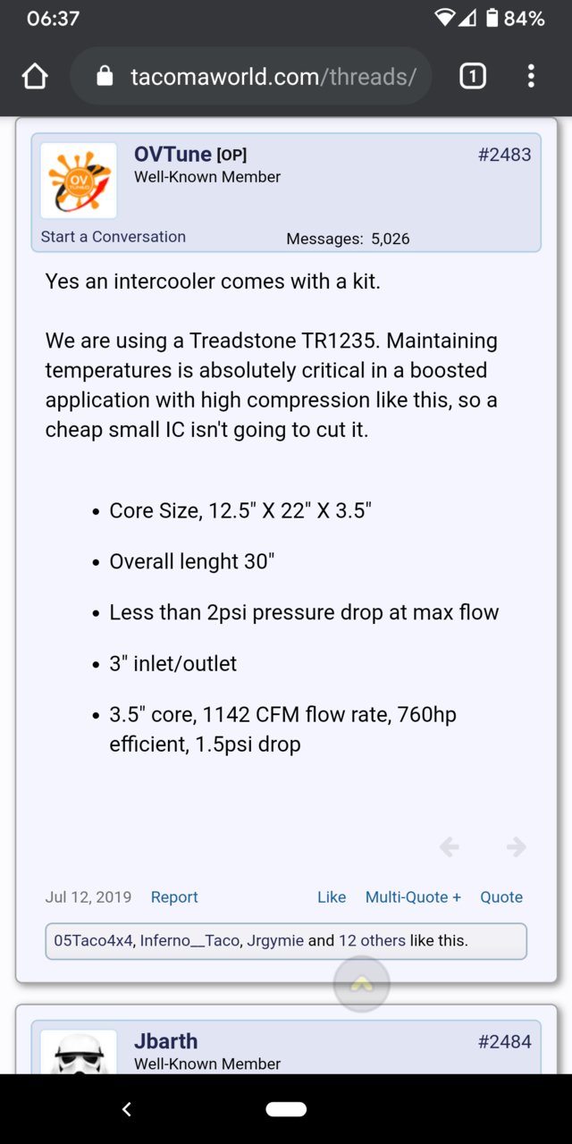

    @OVTune mentioned which intercooler comes with the kit sometime in the past, months ago, I can't remember what it was though. Treadstone I think, maybe a TR8 or even a 10? Idk.
    I'd be interested in any brackets you came up with since I'm really interested in the base kit and have a winch taking up real estate behind the bumper.

    @OVTune can you confirm or give an update on whether this is still the intercooler you will be using, and if it's the same for both kits?

    Yah, I could be wrong but I don’t think that’ll work for winches, it’ll sit too high for top inlet/outlet.
    Will probably need something with side inlet/outlets that can 90 back towards the motor.
    Past making something fit and cutting shit, I’m out of my element. I have no idea the affect on tuning/cooling when you start talking about changing intercooler type/sizes, adding 90s, etc, to get the ideal fit.

    Maybe someone local to Mat who has a winch can stop by his shop and test fit the intercooler, either to see if it works out or to assist with development of a solution. I'd do it myself if I were nearby.
