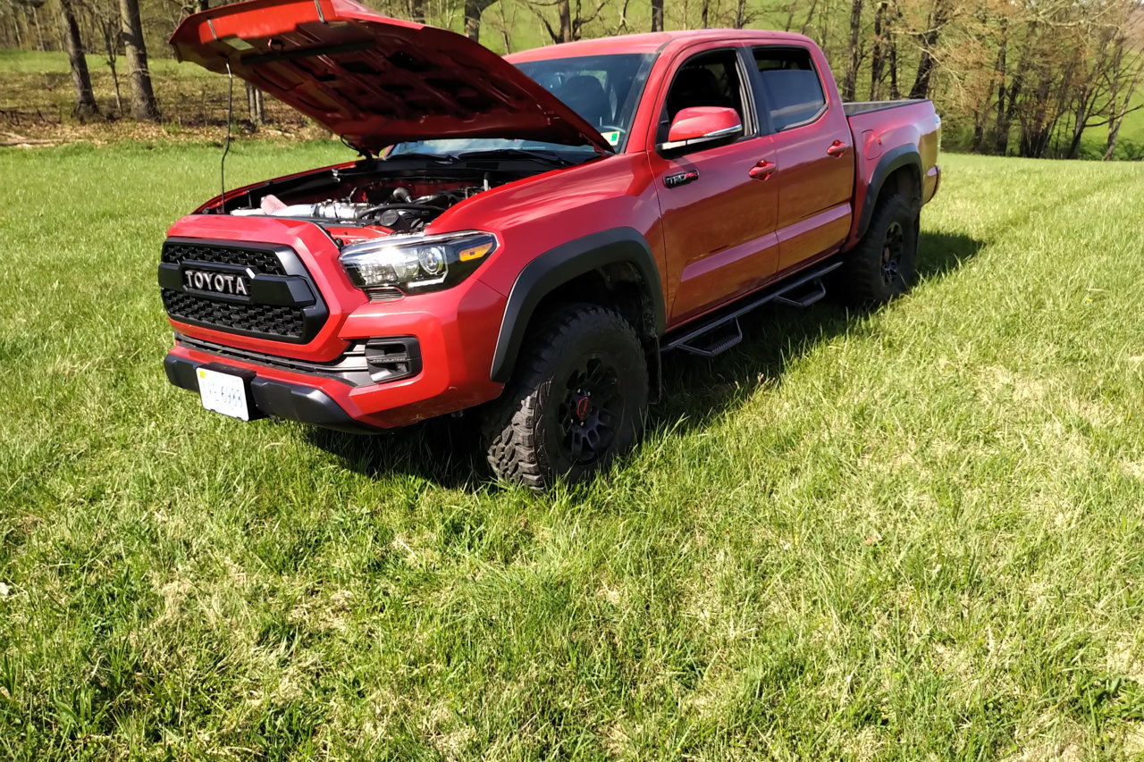

  18. Apr 4, 2020 at 1:50 PM
    #6438
    OVTune
    OVTune [OP] Well-Known Member
    Mar 27, 2017
    #214557
    8,112
    OVTune
    All fueling issues are solved, which was the biggest hurdle.
    We now have total, and complete control of the entire fuel system and both injection sequences.
    So, step 1 of course, some casual off road testing.
