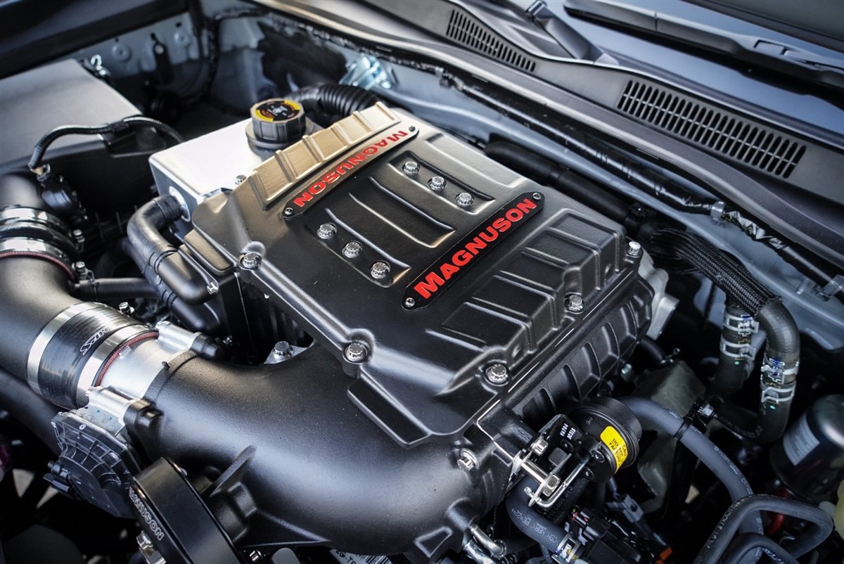

    I can't say with 100% certainty on this but I'm pretty sure Magnuson said they expect the baseline SC to produce 10-11psi, but they did have several pulleys at the ready to find a happy medium.
    If the stock fuel system is the limiting factor...price to hp ratio is gonna suck

    The old port injected 2GR w/ 10.8 CR in the Lotus produces 410 hp at 9.8 psi. So if you say the fuel isn't there with the FKS, the boost will have to be lower.

    The FKS engine is in a bit of a unique predicament.
    1. it relies heavily on the direct injectors for fueling (almost all, outside of idle).
    2. the stock Direct injection system has difficulty keeping up with fuel demand at higher boost levels. (pretty much higher than the base kit we developed)
    3. It has a port injection system. So we *could* upgrade the port injectors and rely on them to provide all the extra fueling
    4. Relying on the port injectors to supplement fueling causes a problem. Knock. The compression ratio of this engine + Boost + port injection for fuel = knock.
    5. So in order to get decent ignition numbers in boost, you still need to rely heavily on the direct injection system.
    6. To get the direct injection system in a state that is capable of handling this, you have to upgrade the direct injectors, target higher fuel pressure (2500psi) at high loads, and retune the Fuel Pump duty, duty limits, etc.
    Slap a SC with 10psi on a stock fuel system and you will destroy your engine.
    LUCKILY...upgrading the fuel system is not very hard. It's just expensive.

    Pure speculation here - but since Magnuson's Jeep kit is the same price as the Tacoma kit for the same size blower I think that the Tacoma kit would include new port injectors since that is what they include for the Jeep kit.
    Now the dreaming part is that OVT comes out with an upgrade kit with new direct injectors, fuel pump/controller to maximize the Magnuson SC.
    At the end of the day i'm really curious to see the dyno charts of all the FI options stack up against each other - especially once OVT has his chance to work his magic on them.

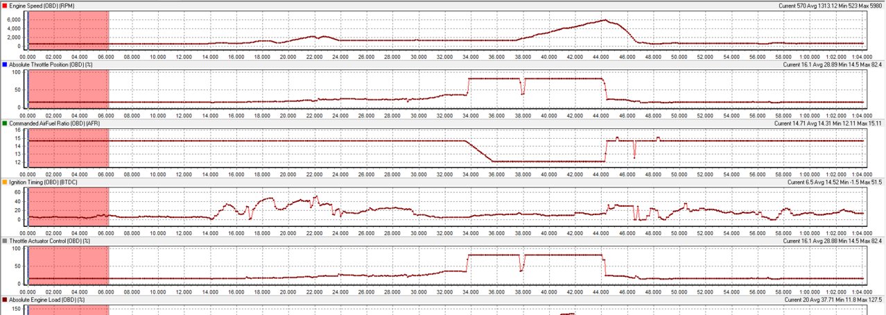

    Here is *a* video I have.
    my drone is fxxxed so... in cab vids.
    Yes street videos next. It's just much easier to test out here. The cows were pretty interested.
    this is 4Low testing which is spins all 4 in dirt
    check engine light is due to missing rear 02s (using the bungs to log wideband AF)
    The metal rattle is the lug nut wrench. Loose under the seat.
    it's running beautifully.
    but as you can see.. the turbos are really loud.
    This is with the torque converter NOT locked in 4L. It does better when locked. (working tuning that)
    it feels "soggier" when unlocked in boost
    https://youtu.be/L7ZFc_6CTGE
