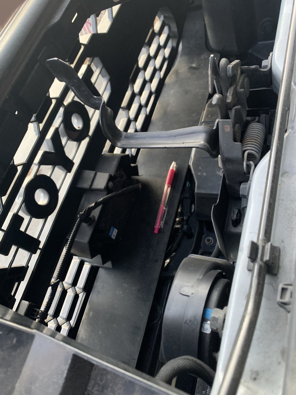

    Yah, it’s looking like I’m going low boost powermax. Thanks for the info.
    I hate to bring it up again, but need to ask. Any thoughts on a higher intercooler? I’m going to try to attach a pic, your truck should be the same I would think.
    I’d like to get something that sat on that black plastic shelf where my pen is. I know it’s tight, but if you could give it a think or two in the upcoming weeks that’d be great for a bunch of us.

    In order to fit an intercooler there it's got to be pretty small. There is less room there than it looks when looking down in there.

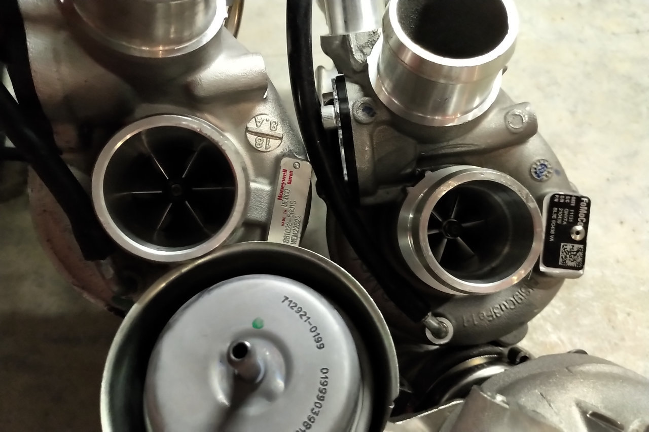

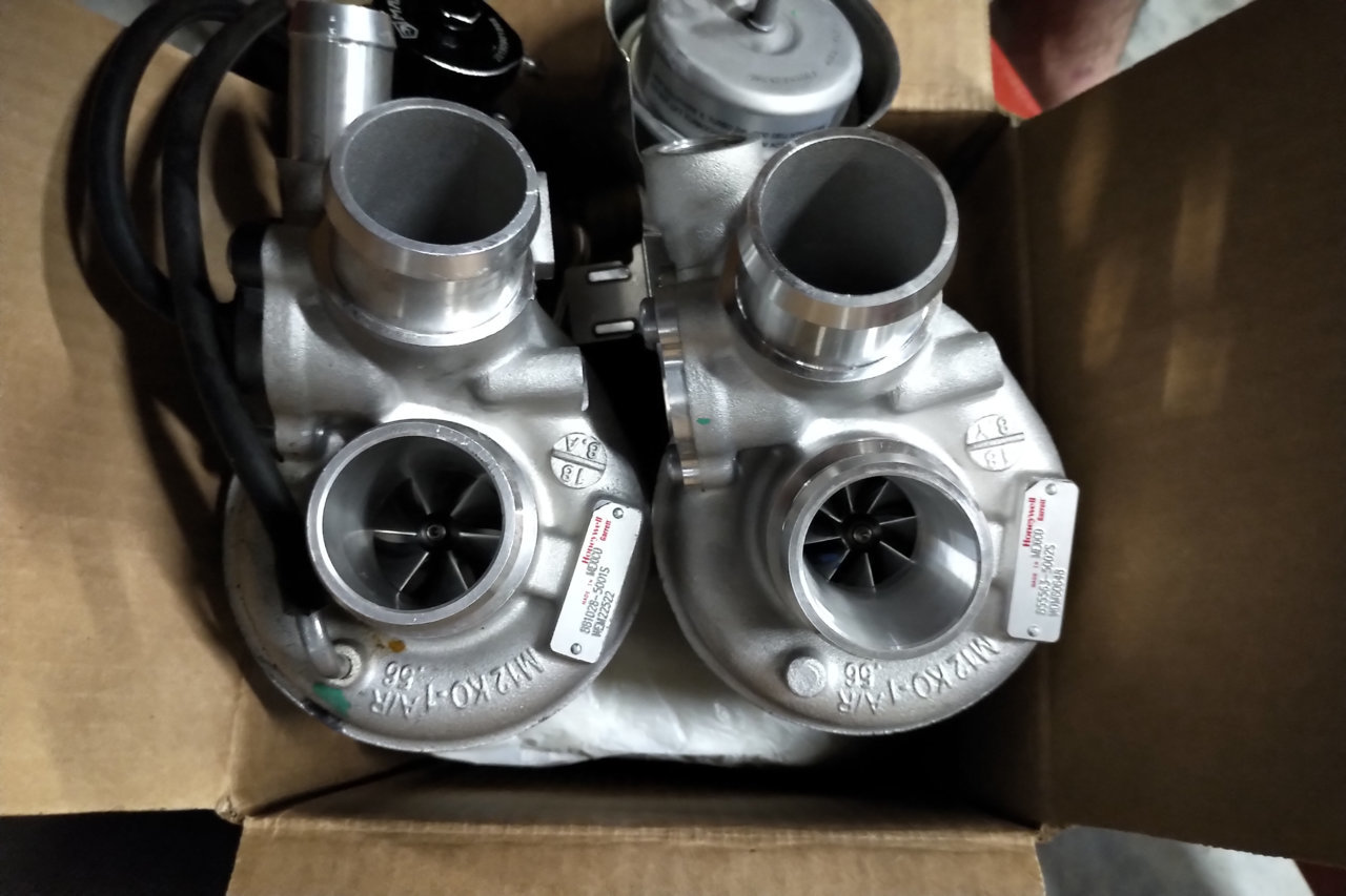

    (check BASE Turbo kit on the right of first image. You can see it is "bov-less." This is how all kits will be coming, powermax and base)
    Base kit Turbo vs PowerMax
    PowerMax vs Ford OEM
