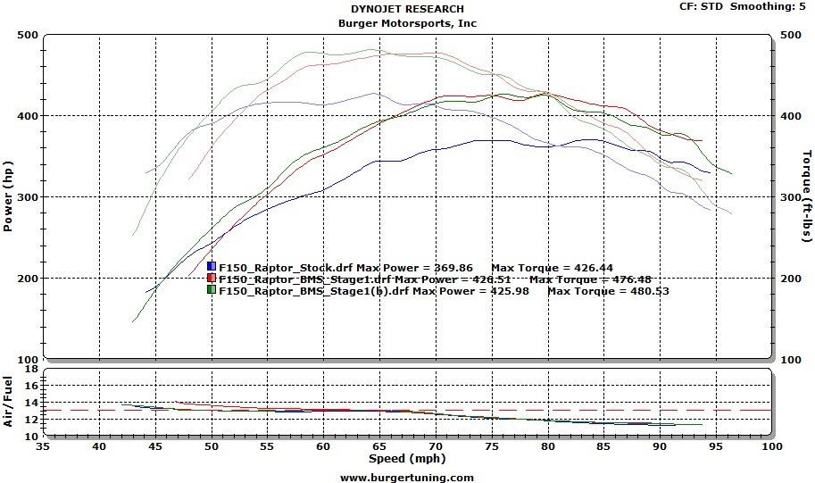

    Looks like those are power to the wheels figures based on this dyno Burger Tuning has on their website.
    Excerpt from their product page:
    Power Gains, Features, & Benefits
    • Power gains of up to 100hp and 120wtq to the wheels on a stock vehicle
    pinochle likes this.

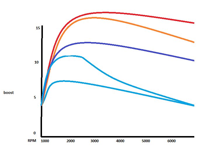

    This would really help my decision making.
    Is this graph still accurate, more specifically the light blue lines?

    I just posted an updated graph yesterday on the previous page

    Okay, just had a look at the new one. When looking at the base turbo blue lines on both graphs although the boost could be turned up a few psi the boost seem to taper down pretty fast beyond 2500rpms. That would deem the base kit + DI option not exactly worth it even with the extra fueling. Base Turbos just aren’t up to the task for too much more without running out of breath. I guess all roads still point to the powermax for me.

    You can definitely run more boost on the base turbos.But you NEED fuel upgrades to do so. They are not out of breath on 6psi, the stock fuel system is.
    That old graph you quoted had a "what is possible" without fuel upgrades but at this point I don't recommend trying to replicate that boost curve.
