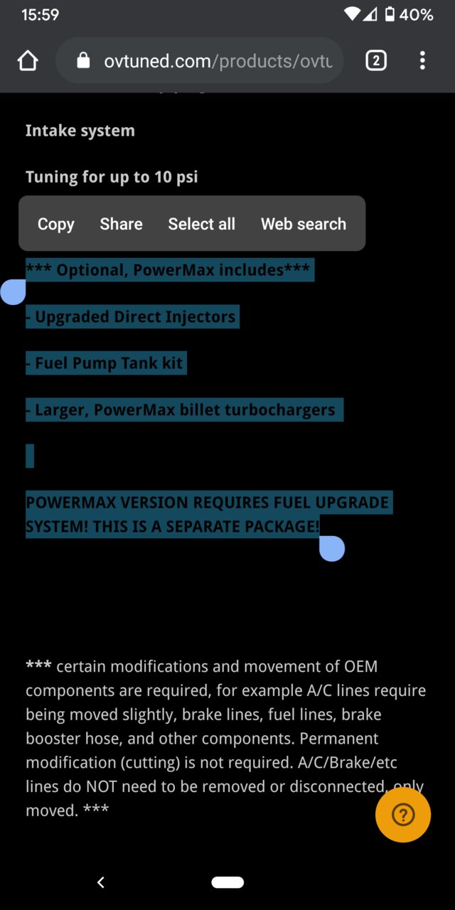

    I think this is correct but I've had some questions based on Mat's listing online. @OVTune can you clear something up?
    Based on the screenshotted and highlighted section, the text first says the items are included in the powermax kit for 5200$, but then you have to buy them separately? Which is it?
    If they're included for $5200, then the powermax low boost is a better option compared to the base + DI which comes out to $5500? Correct me if I'm wrong.

    I don’t think the DI are included with the powermax.
    According to the updated webpage:
    Base kit: $4399 w/tune
    Base+DI=$4399+$1849 = $6248
    Powermax: $5908 w/tune
    Powermax + DI(required) = $7757
    Powermax + D4-S = $8696
    so for people like me deciding between the Base+DI it would be $6249 vs $7757. Difference of $1509

    it is not included, sorry I need to update the listing.
    Hopefully this clears it up? sorry I didn't think it would be this confusing
    1. Base kit. Nothing else 6.5 psi limit
    2. PowerMax kit + required option (DI) ~ 9.5psi standard - 15 psi limit.
    3. Base kit + DI option = boost range 6.5 to 14 psi
    4. Power Max kit + option (DI + PFI + In Tank) = As much boost as the engine can handle
    4. Base kit + option (DI + PFI + In tank) = ... not recommended but as much boost as the base twins can provide.
    2 in 1 out intercooler will actually be more difficult to setup so not going to do that. I like how I have the hot piping done.

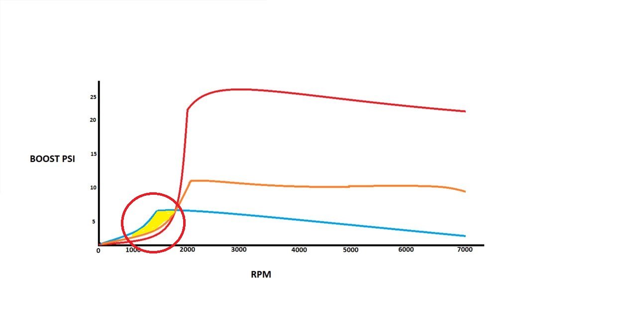

    further to post #6598
    I see a "boost" advantage to the base kit in low rpm (highlighted yellow)
    everything crosses over at ?1800rpm
    Curious as to how this translates into low rpm torque comparison, as the powermax are more efficient. OVTUNED, do you plan on publishing dyno curves? Stupid question probably, as these will eventually make the rounds. I'm interested in the whole torque curve, not just peak numbers in post #1 spool.jpg
    I've driven vehicles where boost ramps up quick (all sports cars however), and while great for Shts and giggles, and a kick in the ass, it might not be practical for steady delivery of power. Thinking about the best solution for towing. #notracetruck
    I stand ready to be corrected :)

    It boosts so quickly at 1700 rpm that I don't you will notice the power surge that I think you are referring to from turbo lag. This will literally be spooled and at peak boost at like 5 mph during normal driving conditions by the sounds of it. Followed by peak torque shortly after.
