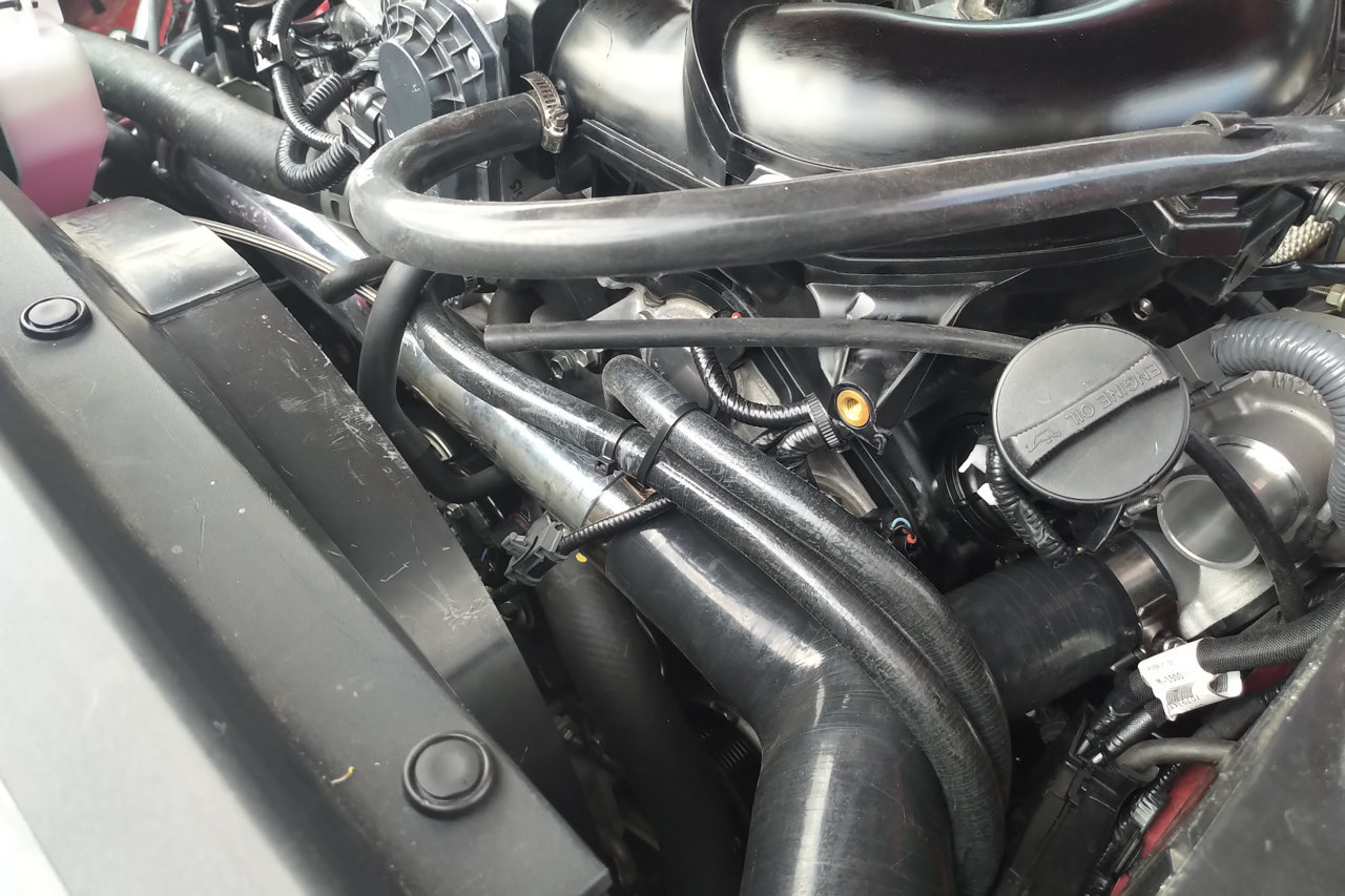

    I think i got everything right incase someone one wants the turbo info more consolidated.

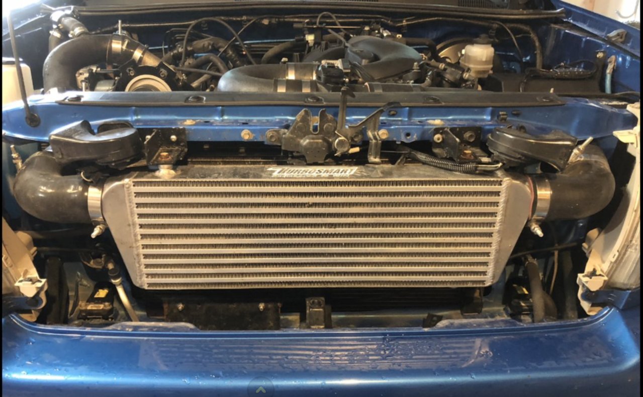

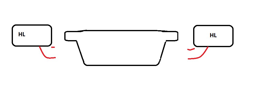

    OVT, is this configuration of the intercooler set up in the picture below how the existing TT kit will be configured? Looking to keep the placement and routing of the intercooler tubing the same through the front engine bay wall and try to modify the tubing within the grill space. Screen Shot 2019-12-15 at 11.03.37 AM.jpg
    Would appreciate any other updated pics of the FMIC installed with the plastic grill off so we can see the how the intercooler and tubing is configured. It appears that the intake and outlet tubing is routed through the openings just behind the headlights, correct?

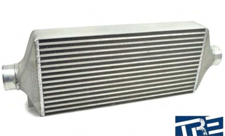

    Might want to check out the Treadstone TR10C. The specs are similar to the 1035: TR10C (700 HP with 1050 CFM) vs 1035 (575 HP, 1000 CFM) but has slightly smaller overall length compared to the 1035 ( 28" instead of 30"). The core dimensions are exactly the same as 1035.
    I wonder if the inlet/outlets being centered will work better not to mention its 2" shorter in length

    With out a merge of the twin outlet tubes, that would need to be fabricated to merge into just one side of that style of core.
    Another option would be a twin inlet core with single outlet. May or may not require as much fabrication.

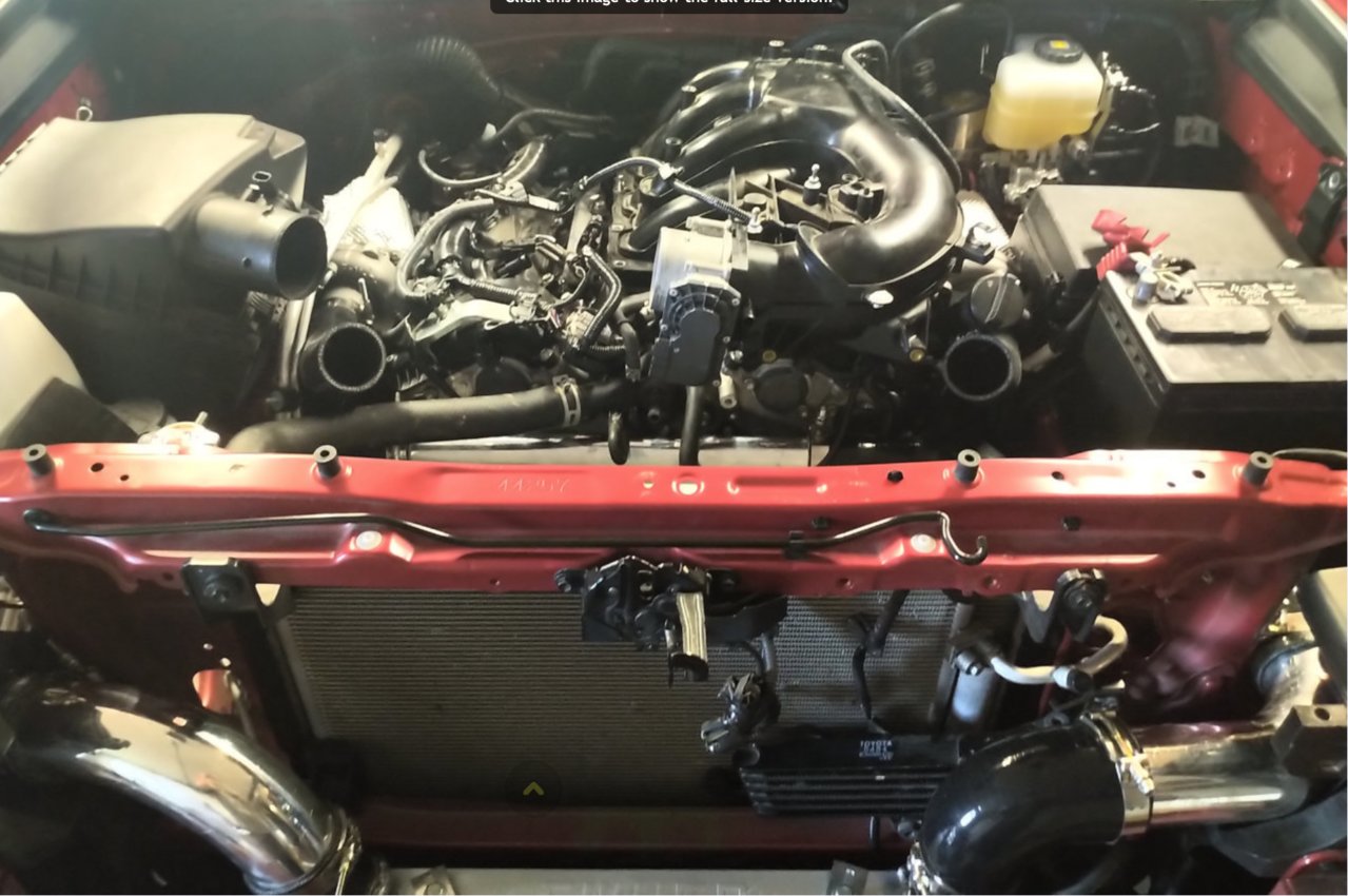

    The intercooler I am using is 1 in, 1 out. You don't need 2 in 1 out.
    you can see how it is setup here:
    Torspd likes this.

    I saw that one too, thought the higher ports would be better when I was measuring. Either way, too late, ordered the 1035 yesterday.

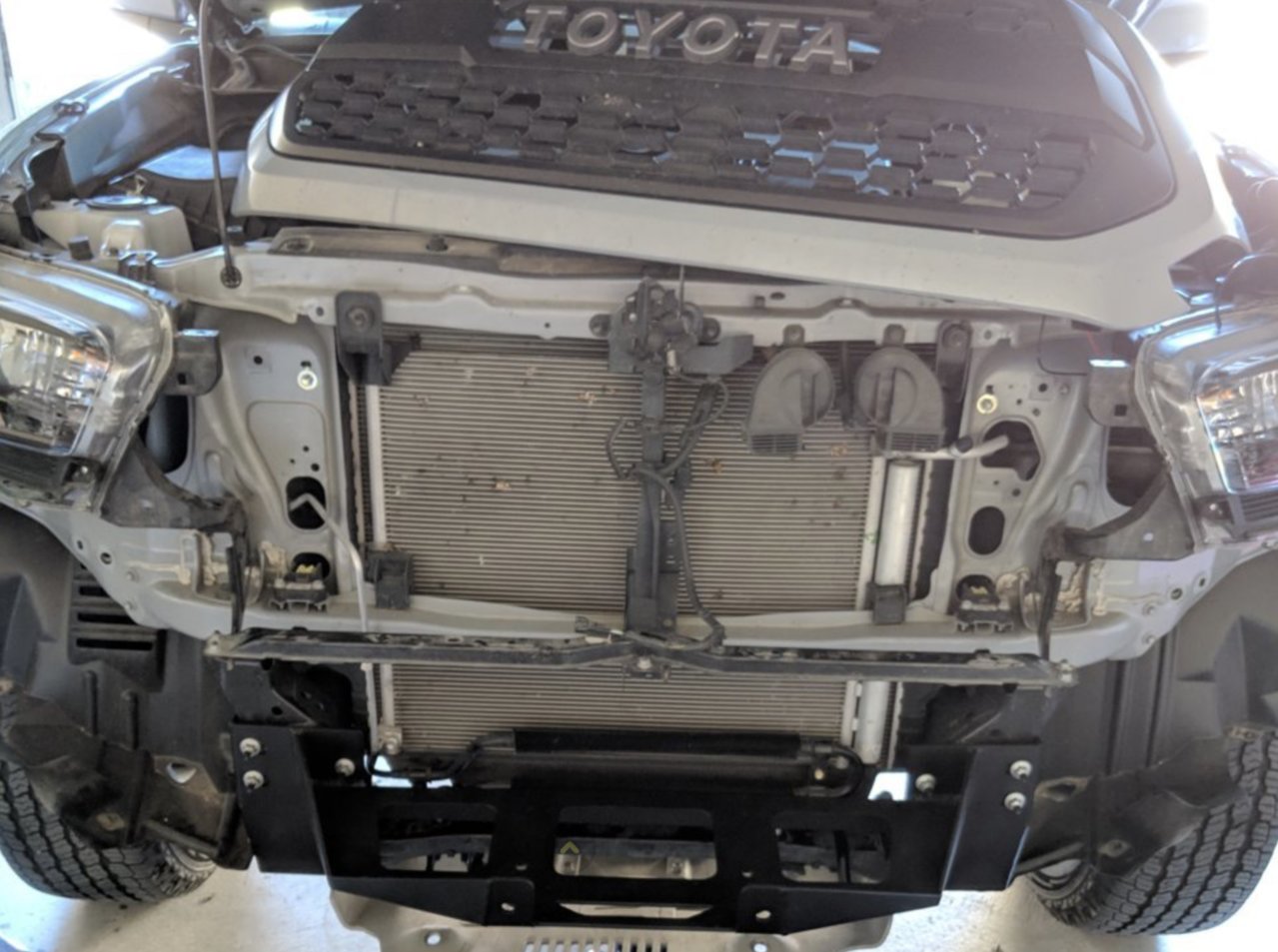

    I'm going to mount my FMIC higher up directly behind the grill. Horn relocation, Hood latch support relocation, whatever I gotta do...

    This is what URD does with their Rotrex kits. The intercooler becomes the support in place of the hood latch support. But the latch stays in place.
