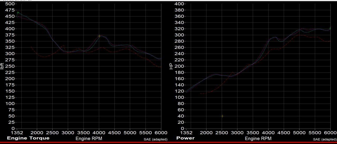

    Okay here are a few runs during tuning and testing
    Here is base vs ford OEMs. 6.5psi
    There are some other dyno runs in here I have to find, in this thread.
    This is with torque converter unlocked.
    and for some reason the forum is making these pics crazy dark..

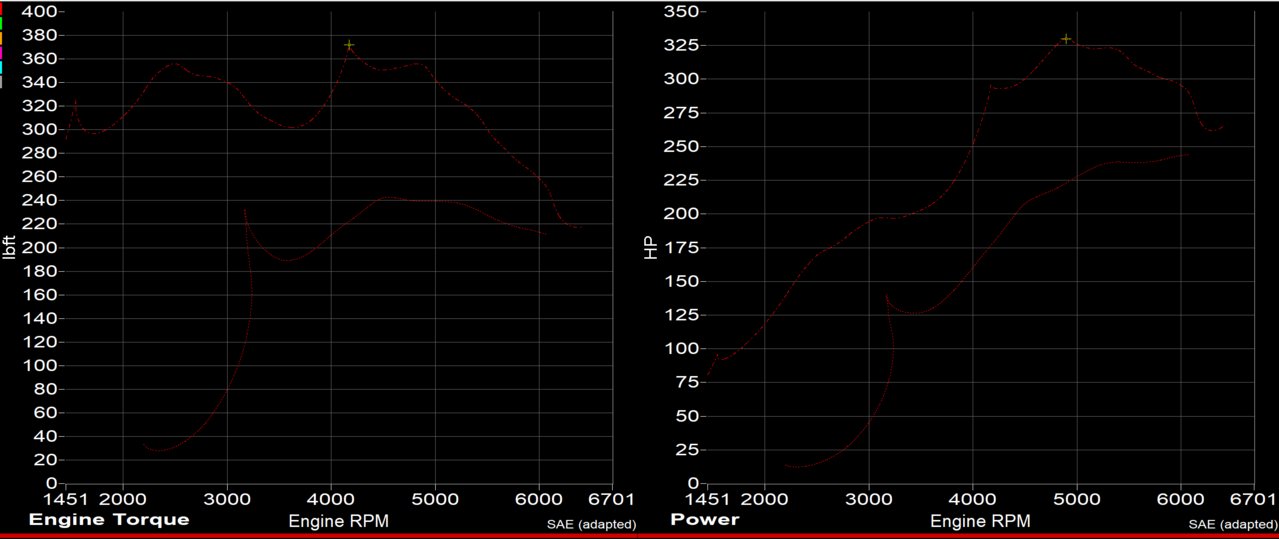

    stock vs base locked

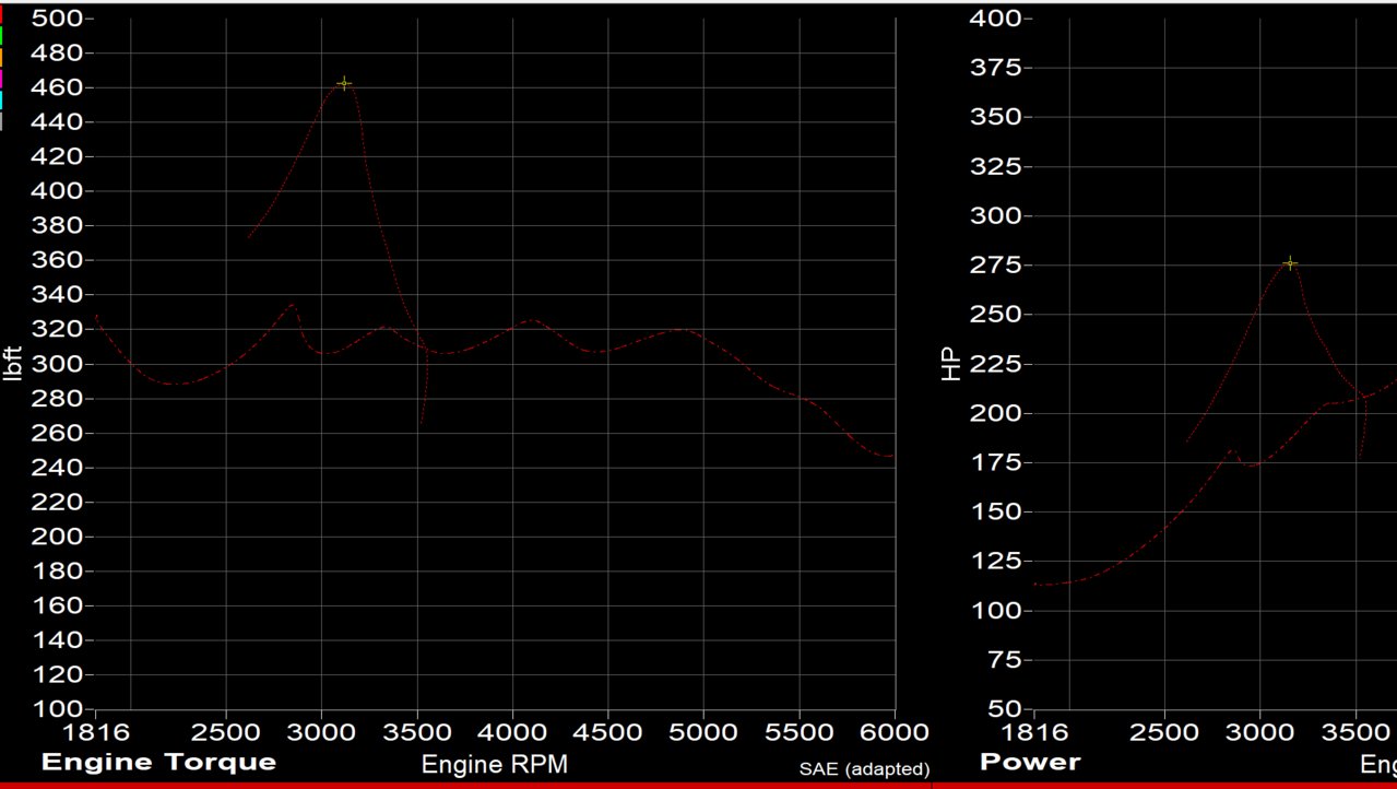

    stock vs base unlocked
    Garrett powermax peak torque test @ 14psi, during fuel testing.
    I still need to get the other powermax runs off.

    i must be reading those wrong, it appears the base makes more torque up to 3000rpm at 6.5psi than the powermax at 14psi (or is the red line = the base comparison in the last graph)?
    Edit
    answered my own question - the last graph red line looks like the base curve from the previous pictures.
    Thanks for these.
    Look forward to the production graphs, and the full powermax curves

    It does not. The Torque converter unlock graphs are skewed on the lower rpm. I explained some pages back in here, that with the torque converter unlock, there is a slight variation in engine speed to axle speed, so the torque numbers produced at very low rpm look higher than reality.
    Reality, with locked it shows peak 350+ in low rpm
    91 octane is the minimum.
    another important thing.
    The dip you see @about 3000. Originally when tuning I believed this to be the torque converter. Actually it is not. It's the intake manifold ACIS. I tried trigger points from 2000 rpm, 2500 rpm, 2700 rpm, 3000 rpm. Each one produces a small dip in torque during activation regardless. The dyno picks this up but you can't really tell on the road. They probably would not be noticeable at all if I ran the dyno where it did 100 rpm per second. But that would be a ridiculously long run. The current sweet is 500/sec so it exaggerates it. Because my dyno is a hub, it is extremely sensitive to these changes.
