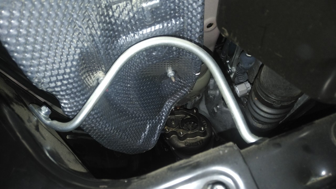

    Current information regarding the turbo kit
    - Our initial system used 2x Garrett GT2560 turbochargers. T25, internally gated.
    The fitment was tight but overall fit well. However the drivers side turbocharger location is not really ideal. On my R&D truck which is a Pro version with larger tires, there is plenty of clearance from the ground which wouldn't really make it an issue.
    However the location of the drivers side turbocharger, after more thought is very likely to be a bad location for a stock height truck. Even worse a 2WD truck, as the drain tube has nothing to protect it
    So with that, the GT2560R Turbo option, due to the overly sized compressor housings, is being scrapped. (image below you so can get an idea of where it was at).
    Hopefully that can give you an idea of what I am saying.
    By scrapping the GT2560s we will also be able to leave both secondary cats in place.

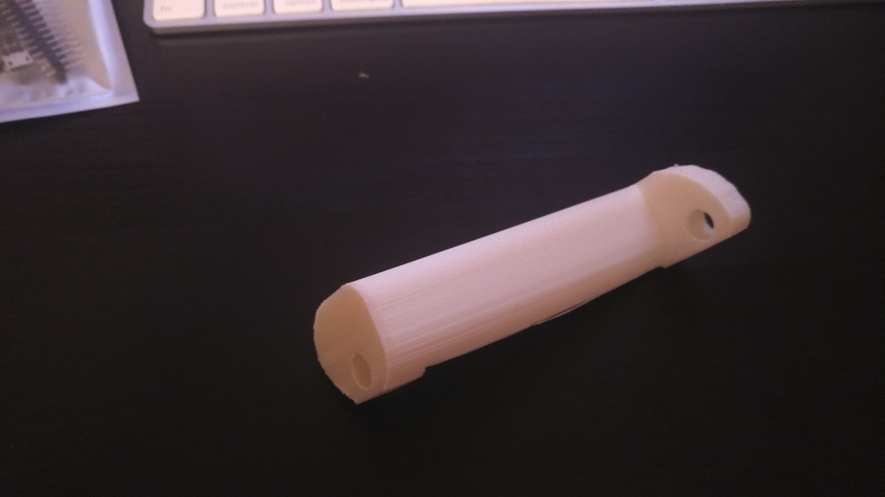

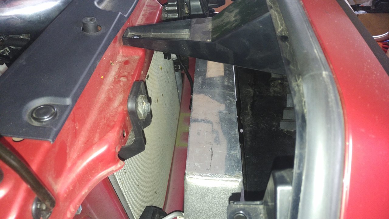

    Third - Intercooler
    Many people were asking about the intercooler,
    here is a quick image I grabbed of the intercoolers location. It goes behind the thin bar, only 1 piece of the truck needs removed for fitting.
    I am working on have an aluminum piece to replace the bar. I will show how the intercooler is mounted when the mounts are finished. Currently I have the prototype pieces and the 3D printed prototypes only.
    more information regarding how it's setup will be available soon.

    Mounting the intercooler is very easy. However I do not know how it will interfere with other front bumper items.
    If you guys could give me pictures of the things that may interfere, I can take a closer look

    Can you define what you mean by what may interfere? Stock or aftermarket? Because I know some people might have behind the grille light bars

    Depending on where the bottom of the intercooler is, an aftermarket bumper might interfere with air flow to the bottom portion

    Can you show a pic of the intercooler from the front straight on with the top grill removed? I think based on the dimensions of the IC in the first post it won't interfere with bumpers or winches at all

    I think that’s why he mounted up so high.
