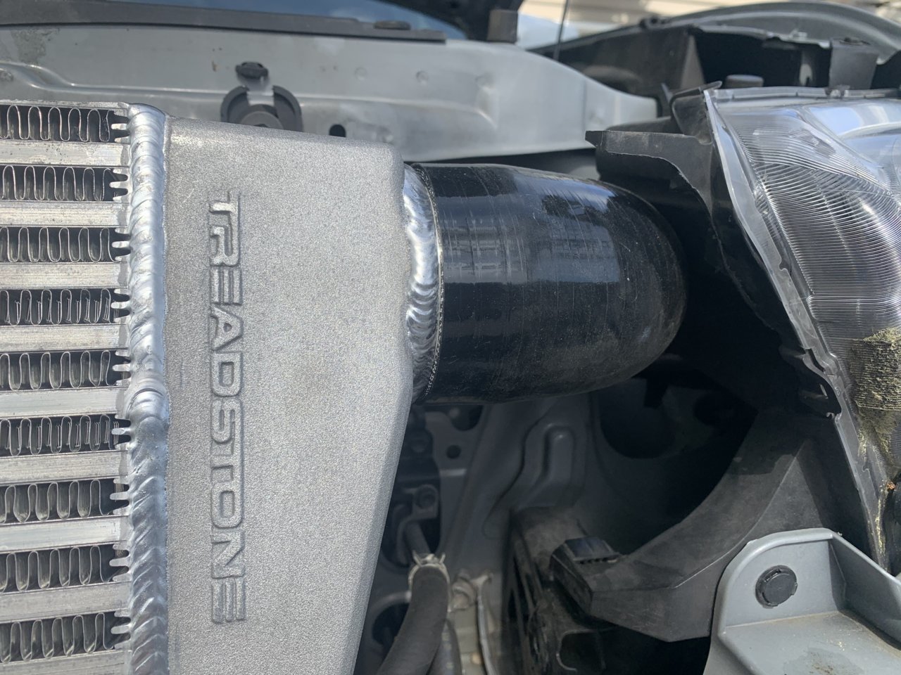

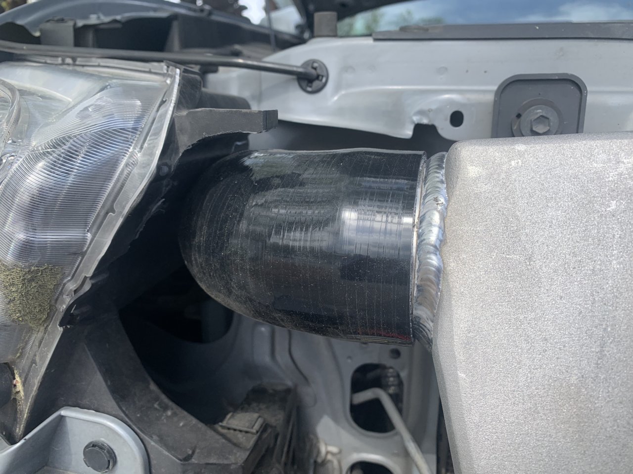

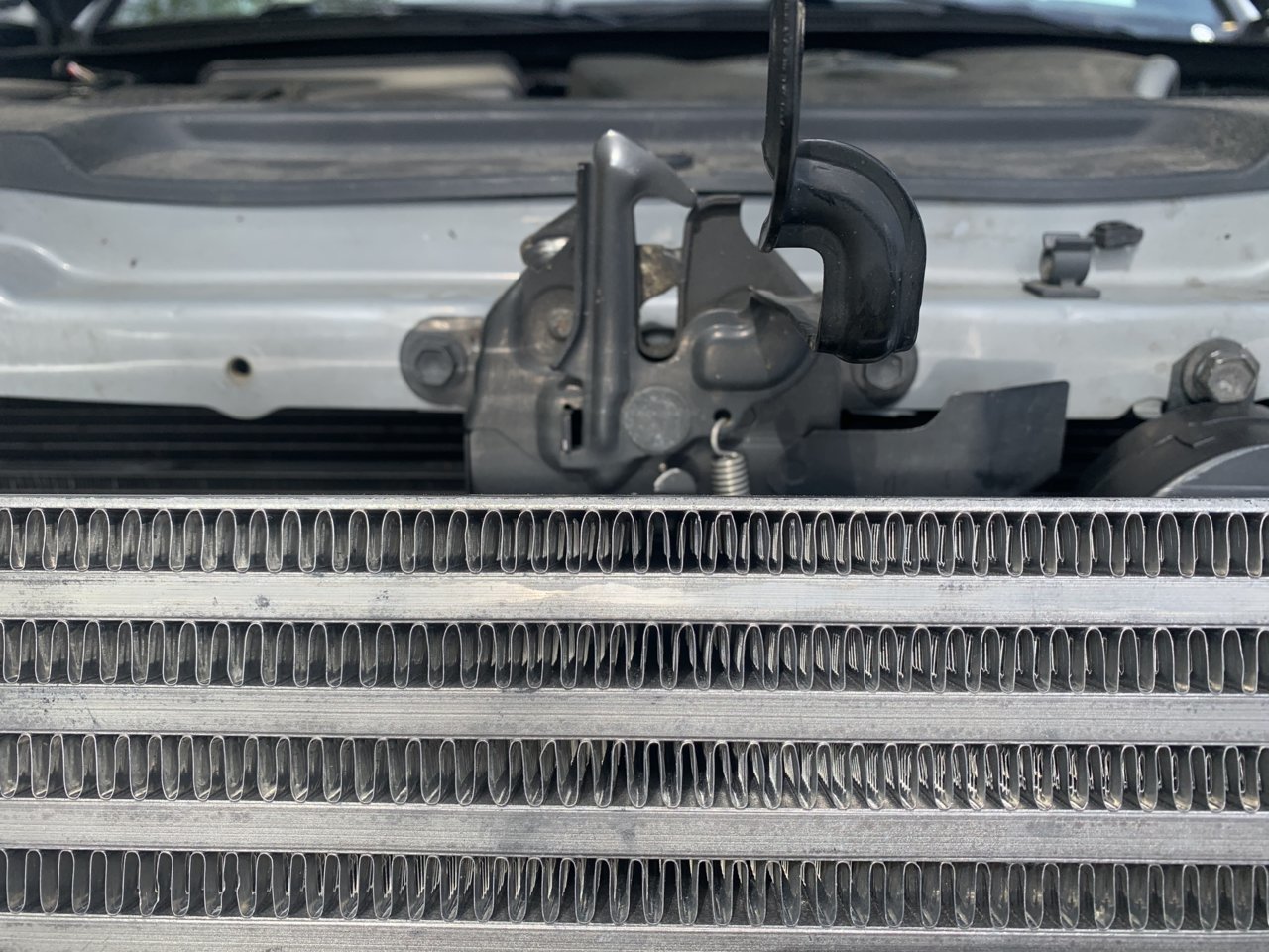

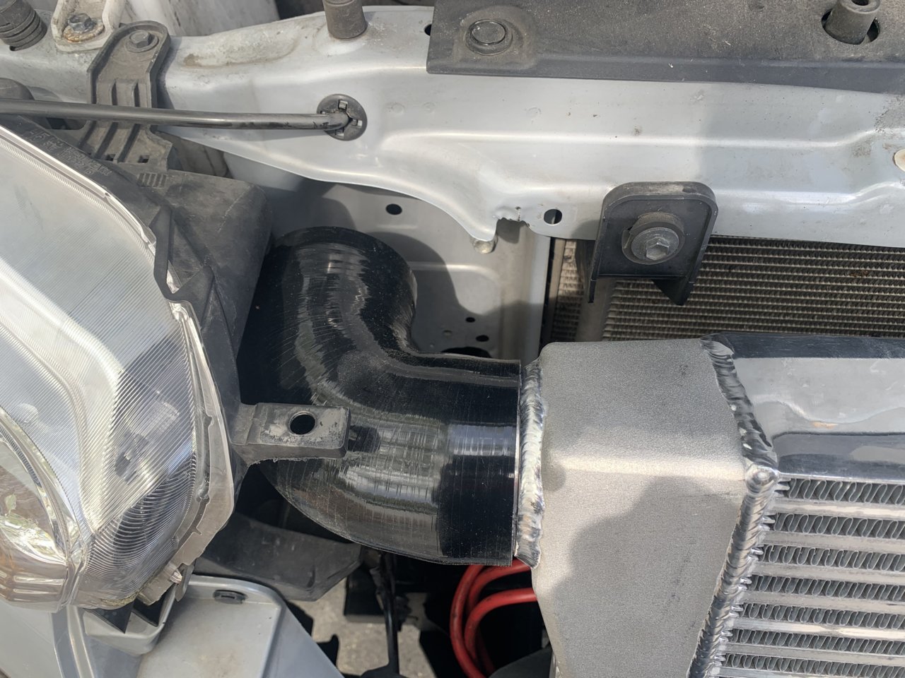

    Got in the 90s, fits like a glove. Juuuuust touches the headlight assembly on both sides. It couldn’t be any closer.
    I’ll cut out the metal after I get the mounting brackets done and it mounted.

    Nice buddy! Welds look good! Gonna reenforce the tubes so they don't rub a hole?

    I can’t claim the welds, the TR1035 comes with the endtanks already welded on.
    I was thinking about welding a mount onto the tubing to catch an existing bolt somewhere in between the intercooler and turbo. Don’t know if it’s needed or not but can’t imagine why it’d hurt. Good thought, interested to hear others.
