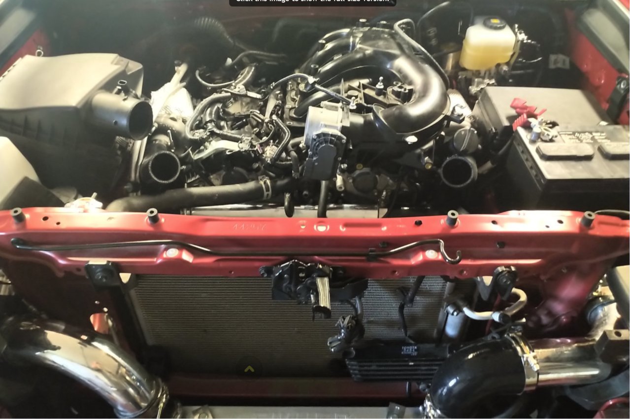

    I believe OVT's inlet/outlet tubing is routed through the existing holes just below & inside to the headlight assemblies on either side as seen in the pic so no cutting is required as I recall.
    My goal was to keep the OVT tubing routed as designed and match it up with the TR10C intercooler with as little modification as possible. No idea if it will work that way until I get the intercooler and measure.
    Cutting a hole through the front engine bay wall would not be difficult either so both options will be an easy DIY project.

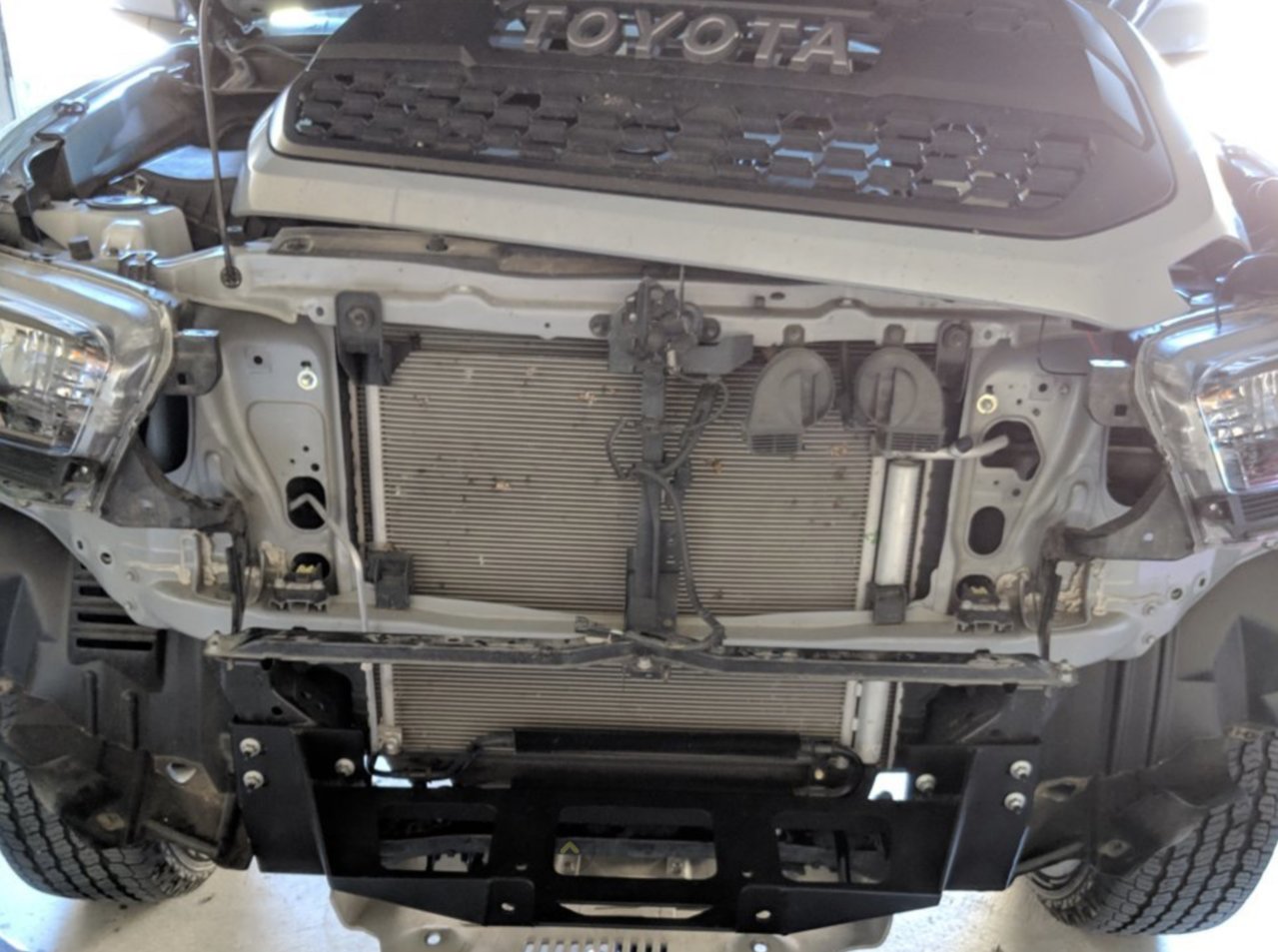

    I was thinking "oh he's got a cement too" and then I realized I was looking at a picture of my own truck from my winch install lmao

    on our setup the piping does go under the head lights and there is no cutting involved.
    the hotpipe side on ours has changed from the pictures though. in the pics a 3 inch pipe is used, it's not necessary and fitment is better with 2.5 inch.
    this does not sacrifice any power or response.
