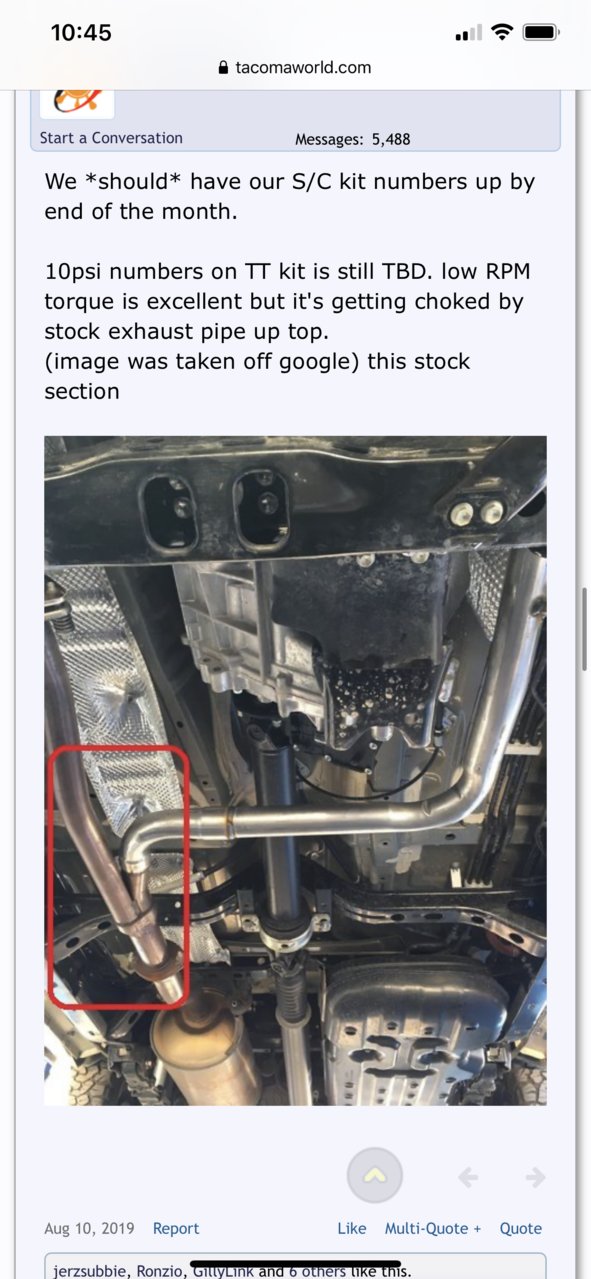

    Wow, I literally thought about this same thing this morning and was going to ask
  2. Apr 27, 2020 at 12:03 PM
    #7142
    OVTune
    OVTune [OP] Well-Known Member
    Mar 27, 2017
    #214557
    8,112
    OVTune
    the stock exhaust is still a choke point yes.
    however, these turbos do much better on stock exhaust than the K04s did
