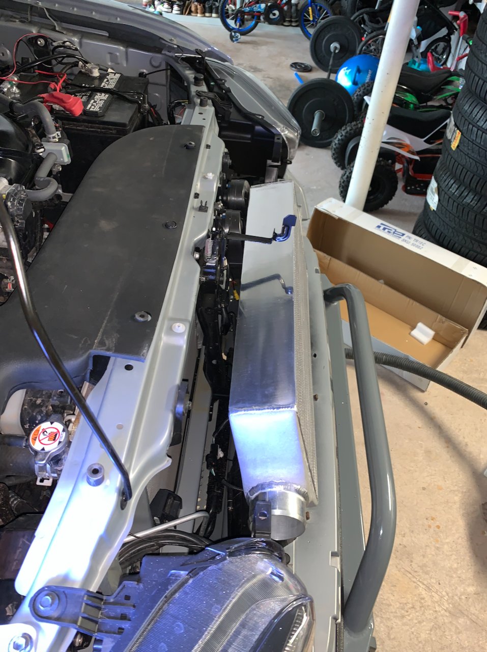

    Is this an accurate picture of the turbo's mounted?
    Sleipnir and mZiggy like this.
  4. May 18, 2020 at 2:13 PM
    #7344
    OVTune
    OVTune [OP] Well-Known Member
    Mar 27, 2017
    #214557
    8,112
    OVTune
    Yes

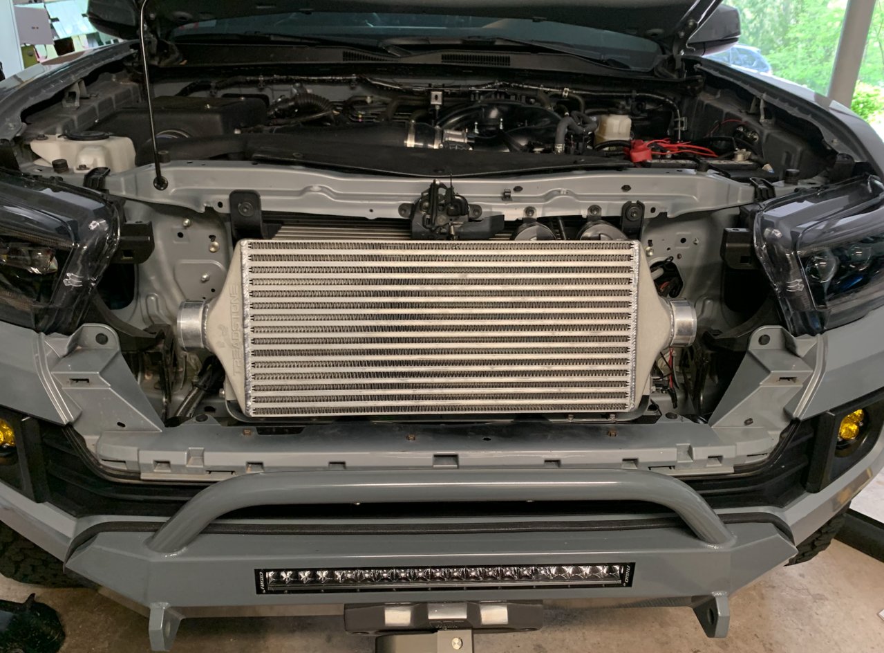

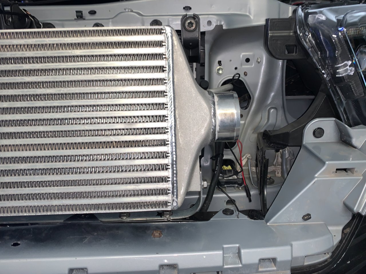

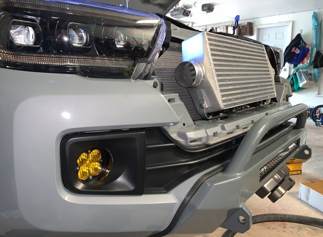

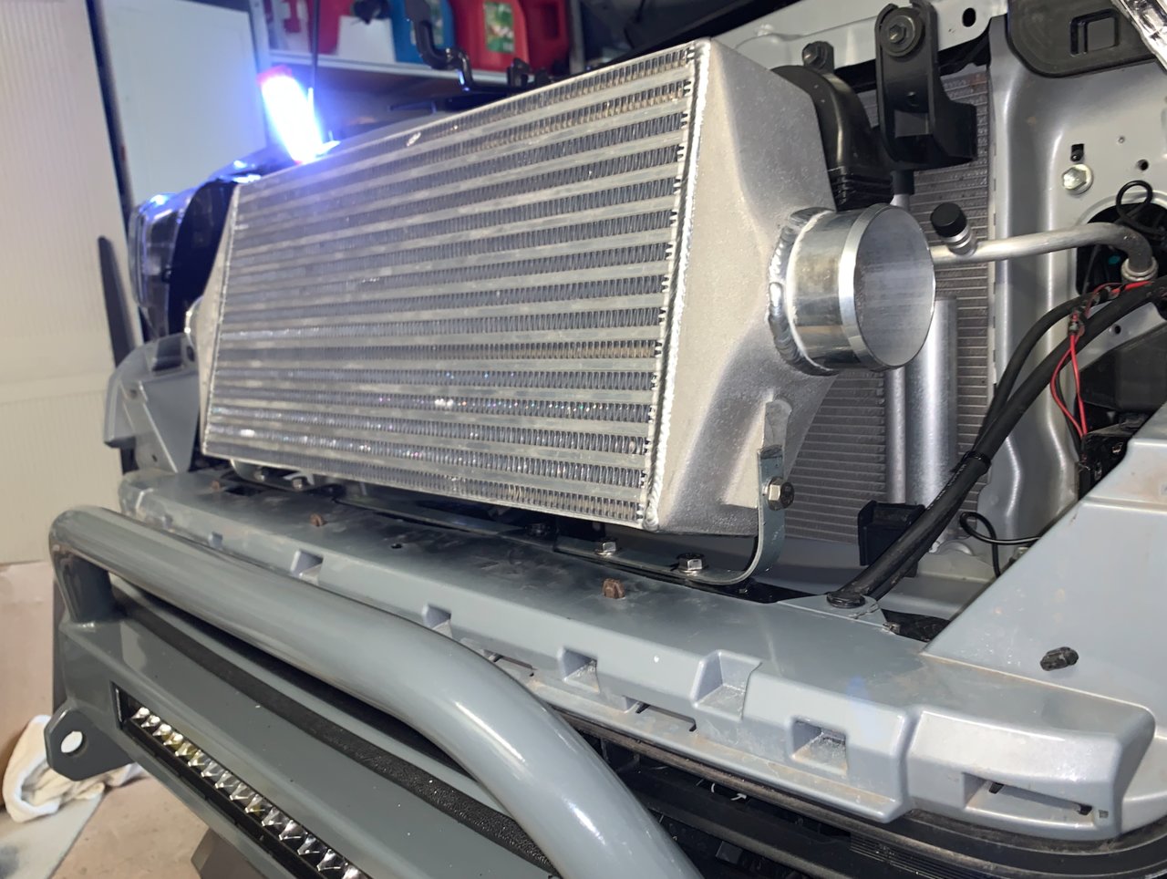

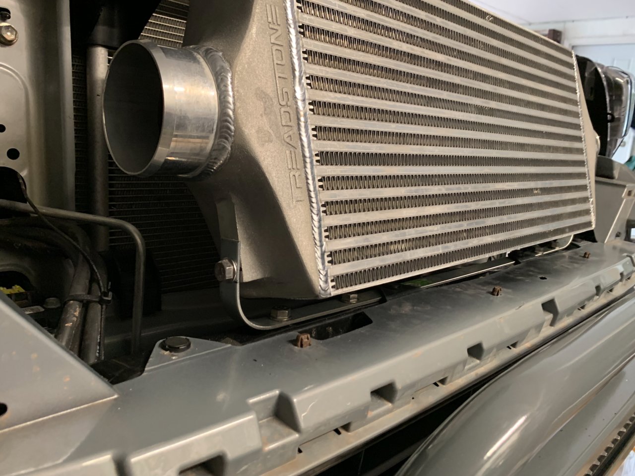

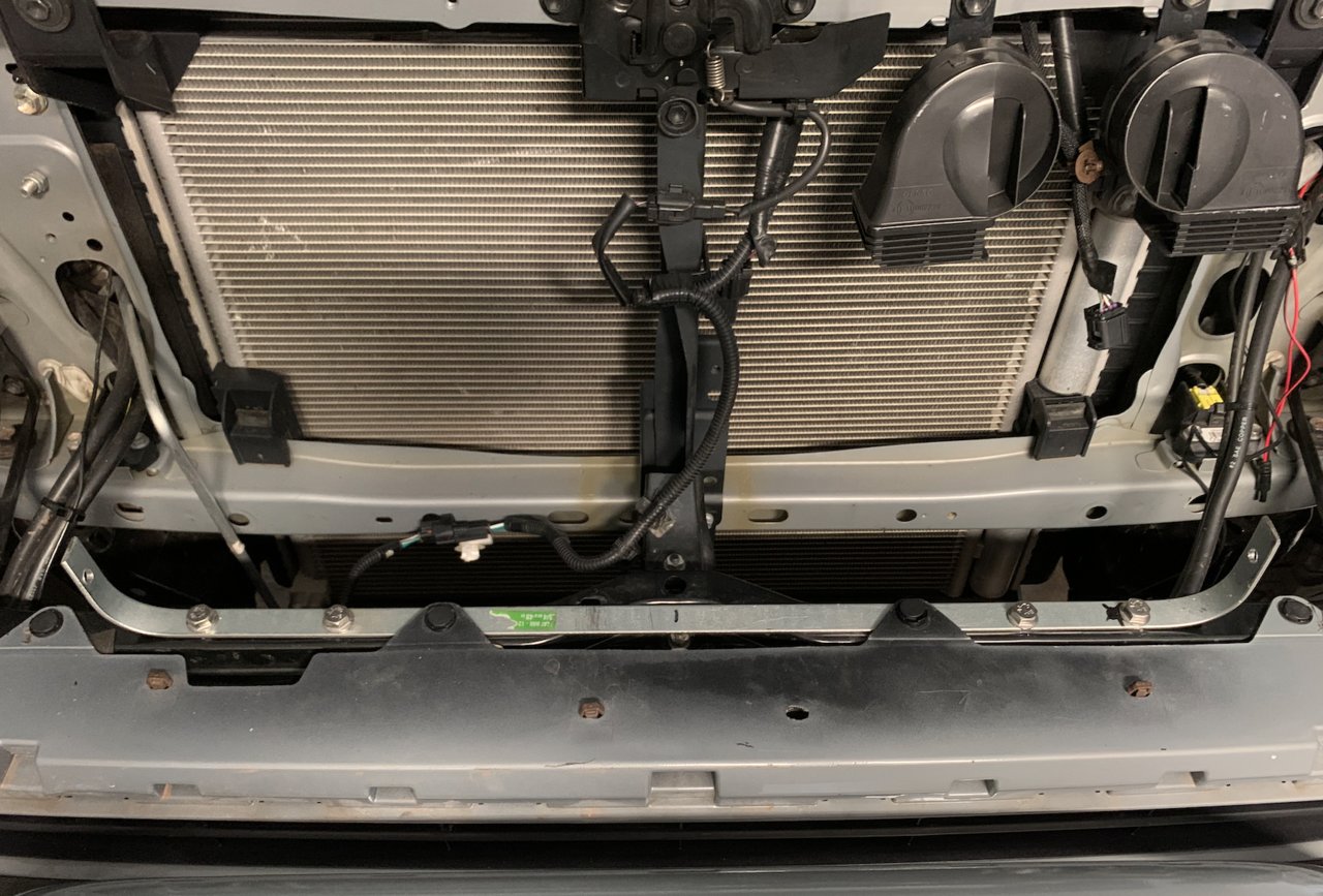

    For those looking for FMIC options that will work with winches...
    Thanks to Turd Hawg for paving the way to find solutions for winch friendly FMIC's
    I installed a Treadstone TR10C
    specs: Core Size 10.5" X 22" X 3.5"
    Overall length 28"
    -1050 CFM flow rate
    -700 HP efficient
    -Less than 1.5psi pressure drop at max flow
    also bought the following for the FMIC brace:
    - 3/4" x 48" 12 Gauge zinc plated steel stock, 1" x 48" 12 Gauge aluminum stock (both at Home Depot )
    - stainless steel M8 x 16 mm and M8 x 20mm flanged bolts with flanged locking nuts
    I took my 4-1/2" Small Angle Grinder with metal cutting wheel and cut the steel stock into 32" long piece. Then I made a 3" long 90 degree bend at each end. Next I marked the holes to be drilled. There were a total of 8 holes: one at each end to fasten the FMIC to, 4 additional holes to fasten the FMIC brace to the OEM bumper metal bracket and two additional slightly larger holes to allow the plastic clips that hold the plastic front grill to fasten through the FMIC brace.
    I used a
    5/16” drill bit to drill the 6 smaller holes and a 3/8” drill bit for the larger 2 holes for the OEM plastic clips.
    For the 2 holes that attach to the FMIC, I drilled each hole approximately 2" from the 90 degree bend allowing the FMIC to sit above the bumper and allowing about 3/4" of space between the bottom of FMIC and the bumper.
    Next I fastened the FMIC brace using 4 sets of the M8 x 20mm flanged bolts with flanged locking nuts. The black OEM bumper plastic clips just fastened through the FMIC brace.
    Next, just attach the TR10C to the FMIC brace using the M8 x 16 mm flanged bolts and tighten down once the FMIC is tilted back enough to your liking. There is a little wiggle room but the FMIC should sit just below the hood latch mechanism without interfering. There was plenty of room for the OEM horn and I assume the AT oil cooler although I have a MT so I can't confirm this.
    Screen Shot 2020-05-18 at 7.19.11 PM.jpg Screen Shot 2020-05-18 at 7.18.31 PM.jpg Screen Shot 2020-05-18 at 7.22.01 PM.jpg Screen Shot 2020-05-18 at 7.21.43 PM.jpg
    AS you can see, there is plenty of room to incorporate OVT's intercooler piping routed through the existing holes behind the headlights. Either a 60 degree or 45 degree silicone coupler should work well to mate up to OVT's piping in the TT kit. I am going to try and use as much of OVT's kit piping with as little modification as possible.
    Screen Shot 2020-05-18 at 7.27.26 PM.jpg Screen Shot 2020-05-18 at 7.28.13 PM.jpg
    Last thing: I had to cut the bottom inner side shroud of the OEM grille so that it would accommodate the FMIC and brace. I cut out about 1.5" deep and about 28" long piece which would have sat where the FMIC brace attached. I again used the angle grinder with metal cutting blade but a dremmel would work fine.
    FINALLY, I am going to use the 1" aluminum stock and cut a 5" long piece to be welded on the top of the FMIC. This will create a bracket to attach to the top of the radiator core support. This will add just enough additional support to prevent the brace from moving around when driving. Although the TR10C is very secure using the existing bottom brace (which is holding the weight of the FMIC), a third top brace is needed.
    I am going to have a local welder do the fabricating and I will post the pics in a couple weeks.
    PM me if you have questions. Hope this provides some good info for those who want a WINCH friendly FMIC for OVT's TT Kit.
    dskakie, xxTacocaTxx, SK808 and 12 others like this.
