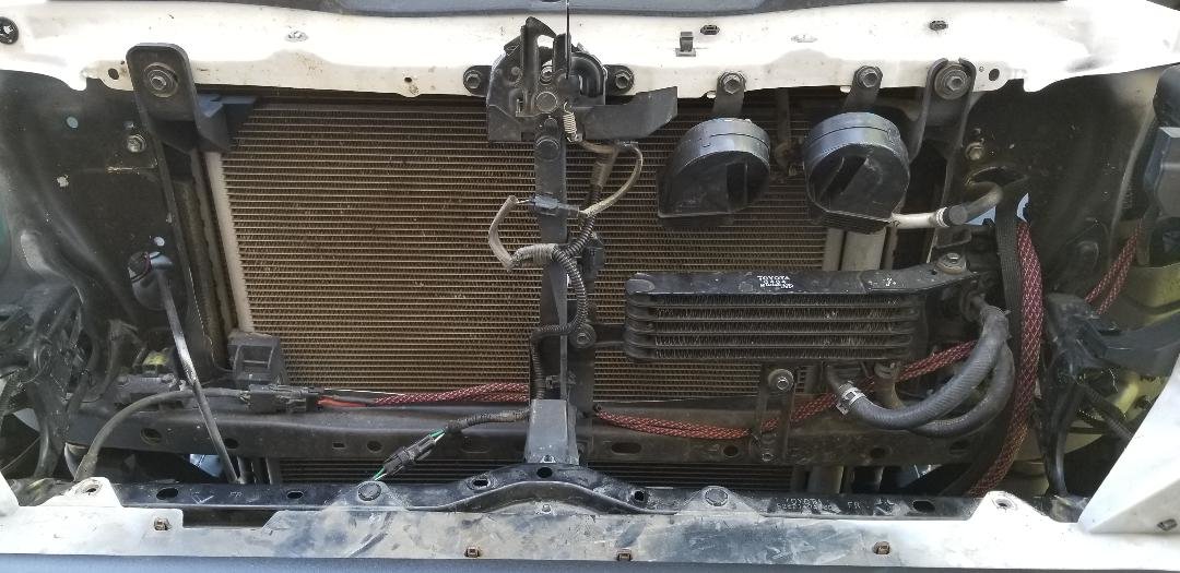

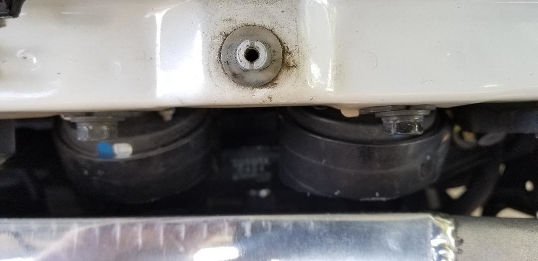

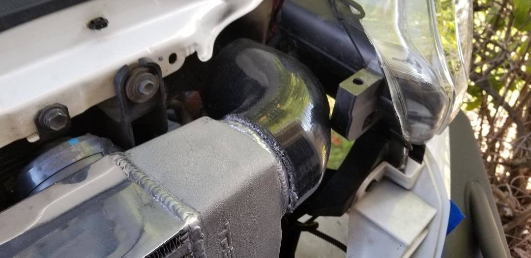

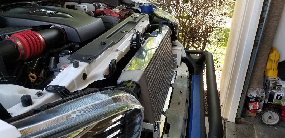

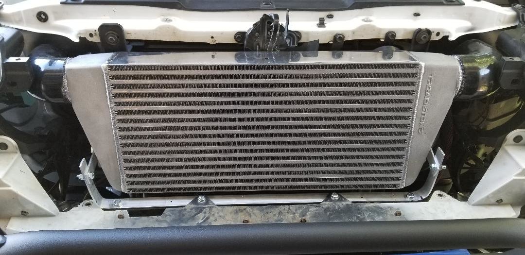

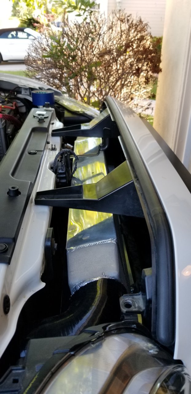

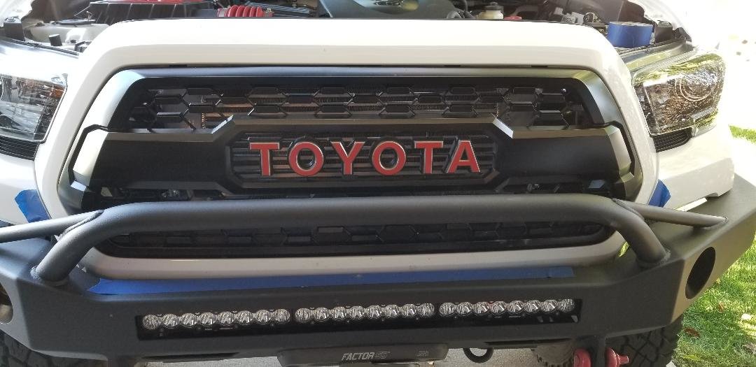

    Did some mock up on a bracket for intercooler . Going to have a fabricator make it one piece. Going to have two brackets up top to give extra support.

    Do you have any issues with your hood closing?
    Originally I wanted to put the intercooler in this upper area,
    but messing with the brackets and support bars for the hood latch makes the hood hard to close / does not close.
    Sleipnir likes this.

    No issue at all. Had it all bolted up and i did open and close the hood to be safe!

    Hood latch was not touched all still in original OEM build.

    Does it matter that the FMIC outlet (or inlet) is on the 'high' side as cooler air sinks?
    I'd guess that it's not a vast difference.

    Are you planning on moving that oil cooler down?

    At this point i am not moving it . It fits doesnt rub on intercooler. The only reason to move it for me would be if its not getting enough air flow to cool with!

    much but If you were I would monitor the Tranny oil temp via a scanguage. I tow quite often and near capacity so I will be moving it down to the lower opening. Now, if I could just decide which intercooler to go with:confused:
    I might wait to install the full kit and see how the plumping is ideally routed before deciding and ordering between the tr1035 or the tr10c intercooler. Downside is I’ll have a sitting truck for a few weeks.

    I do have a scangauge i will monitor. I do not tow anything and dont plan to. Both the coolers will work TR1035 and TR10C. The TR10C looks to have a little more room and it just may go thru the behind headlight opening. I had purchased earl and i am happy with how its going pass into engine bay and hook up with the reaming kit tubing.
